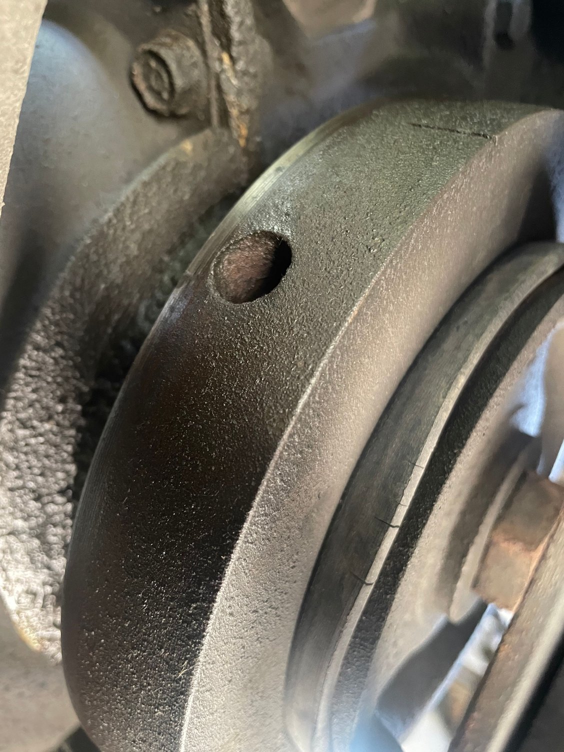

My pulleys looked good last year when I had a high pitched noise, but then found the balancer portion of crank pulley was separated from the rubber and backed into my timing cover just barley scraping it… I still have photo….everything on pulley is tight, and I even tried to move with prybar and no go….you can see how far it slipped back off the rubber and the scrape on balancer in photo….this happened twice on my 95 and now a 3rd time with my current 02 ram
and with it running there was zero wobble
I will definitely take a look at it!
