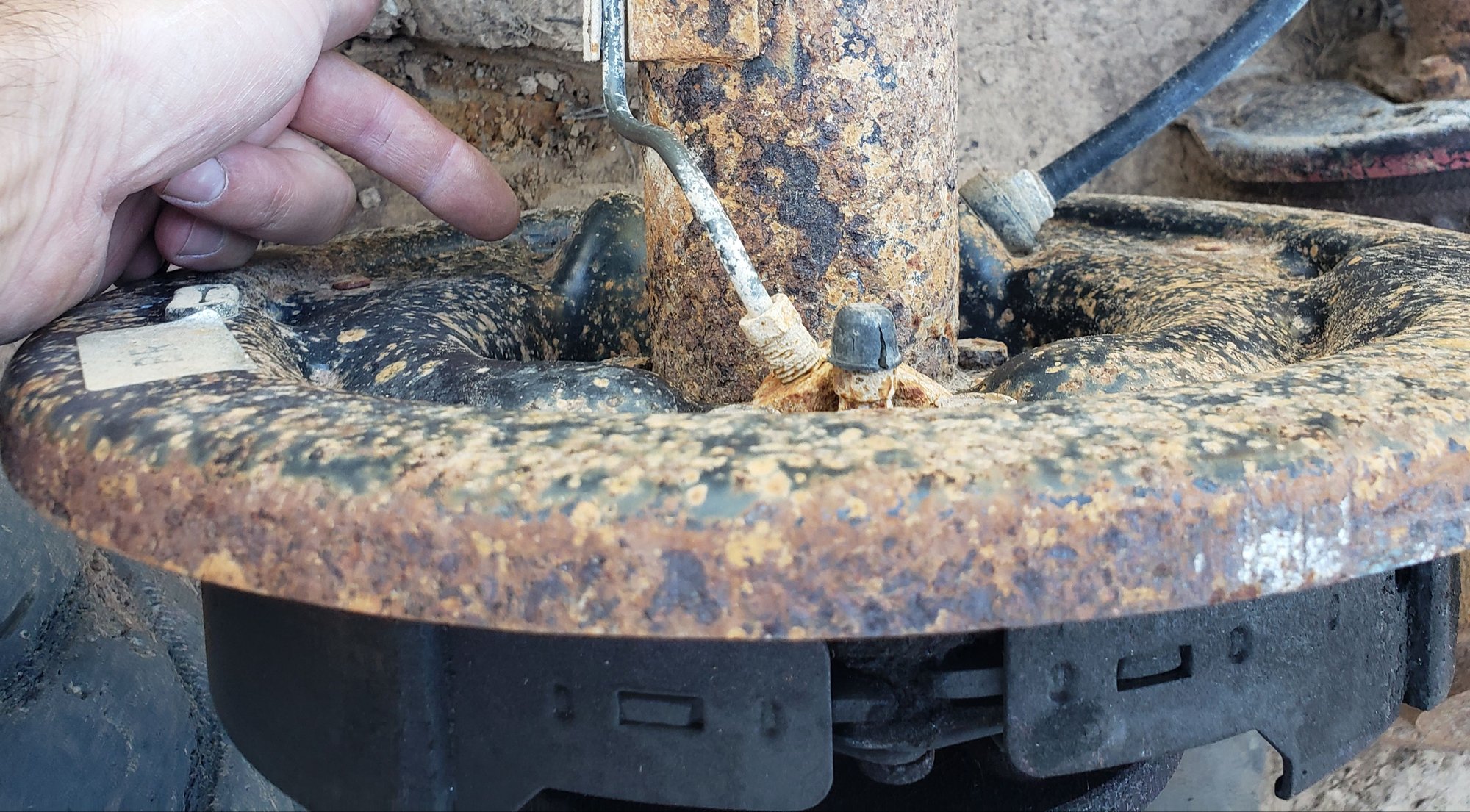

Originally Posted by Keith_L
I took a look at the remaining new style I have here and all I'm seeing for additional springs is the spring on the parking brake cable itself? Those are sold on/with the cables
He was talking about the parking cable spring. I can also comment that the spring DOES NOT come with new cables.
Old Sep 19, 2022 | 12:12 AM
Keith_L's Avatar
Keith_L
Joined: Jan 2004
Posts: 1,434
Likes: 192
From: United States
Are you speaking of the green spring in your pic?
edit: I see now that new cables no longer include the LONG spring that slides over the cable itself. The last time I purchased new cables for a 2nd Gen they were included, but that was circa 2014. Dodge discontinued the part in '15.
Old Sep 19, 2022 | 03:53 PM
MoparFanatic21's Avatar
MoparFanatic21
Veteran: Marine Corps
Joined: Nov 2014
Posts: 8,098
Likes: 318
You would be correct, I'm unsure if the spring is really needed or not.
