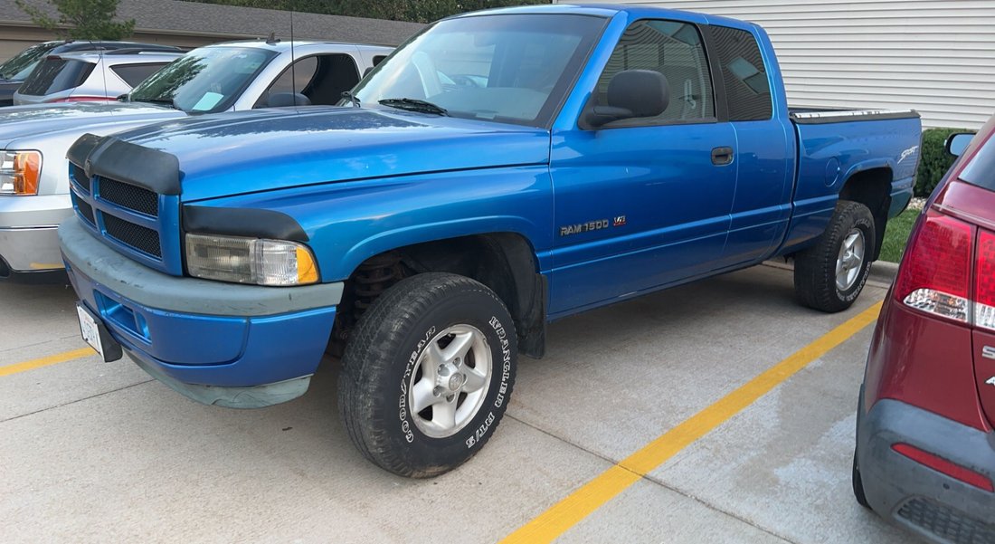

Update: got the truck home….the ignition coil wasn’t plugged in…jumped it with my other truck and it started right up. 174k on the crack free dash. Only rust is on the back bumper and passenger doors. This thing is mint. Ac even works. I basically stole this truck 😂
Ill post pictures tomorrow morning.
