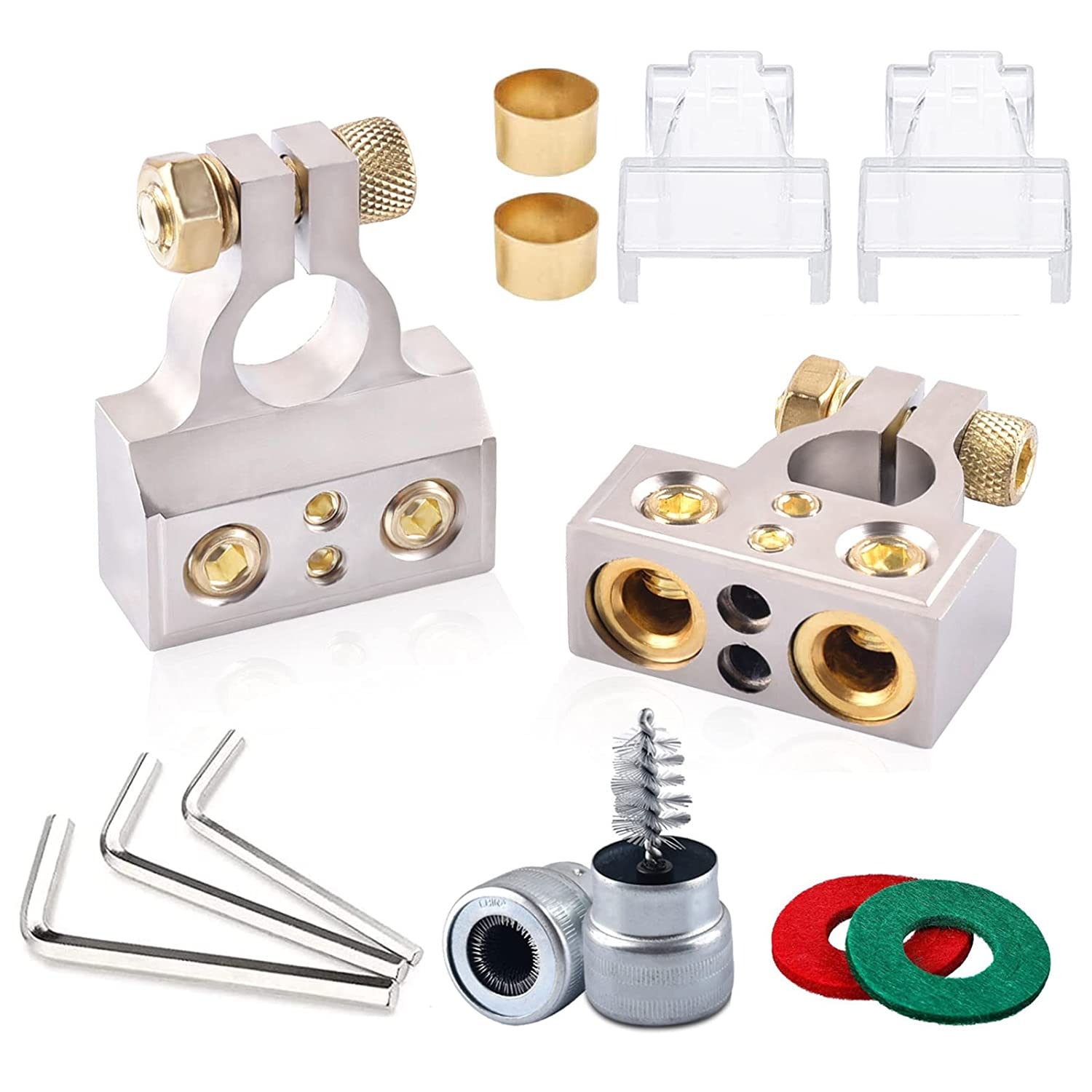

What do you think of these…
Amazon Amazon
or these…
Amazon Amazon

Originally Posted by atc250r
I honestly don't know. Both look a bit gimmicky but might be great. I tend to like the military style because they're just a big rectangular block. Difficult to break as they cinch (flex) closed around the battery post.
But the military style is all I have experience with so maybe I'm missing out.

I have a '96 1500 and I recently changed my clamps to these:
Fancy Clamps Fancy Clamps
This whole set was only $13 on Amazon
This whole set was only $13!

I've used both, I prefer the non gimmicky style, especially on my race truck with the battery mounted in the back, I think they work better, less to go wrong.
