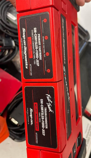

I opened another thread, some may have seen looking for a MT2500 Snap On Scanner. I was able to locate and buy one of those. Waiting for shipping now. I think at that point I can check the advance like mentioned above and hopefully find a bad part or at least get in the right area. I cancelled the order on the Picoscope. It was going to be 3 weeks out anyhow. Hopefully I can get some info and the MT2500 will be useful. Thanks for the help.
I think the manuals are all there for the mt2500 so that should be helpful. The cartridges might be the trick but, until I get there I don't know. I will update when I get the scanner.
Does anyone know if these cartridges are correct for the 1995 Dodge Ram 2500 Gas?

Maybe..... I *think* they will also handle OBDI, but, it's been a few years since a played with one. I don't recall how the cartridges were labeled.
Have the right personality key, and adapter is the big part of it as well.

Yes, I know for sure it will handle the obd1 with the cartridges. I think Chrysler and Dodge were one in the same balance sheet so I am hoping the Ram is under the Chrysler tab. From what I have read here on the forum the 13 and 13a personality keys hook up for the ob2 which would cover 1996 and later depending on the cartridge. I am hopeful about this scanner. Cant wait to post some info on what I learn in the process here. I would have never knew about the mt2500 if you would not have mentioned it.
