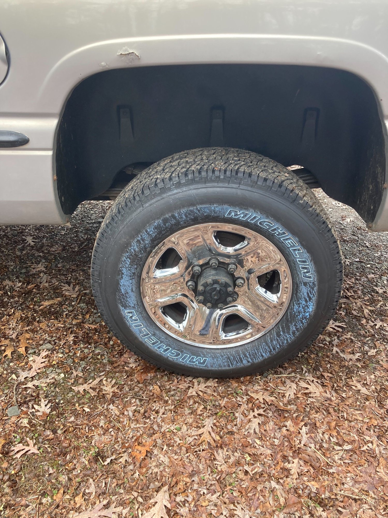

Just like the title says, i just had a set of 270/70/18 installed on a set of 2018 Ram OEM rims. They fit great and really make the tires/rims proportionate to the truck.
The issue is the rear center caps do not fit properly. The fronts fit well, but the rear hub does not allow the caps to secure on the lug bolts.

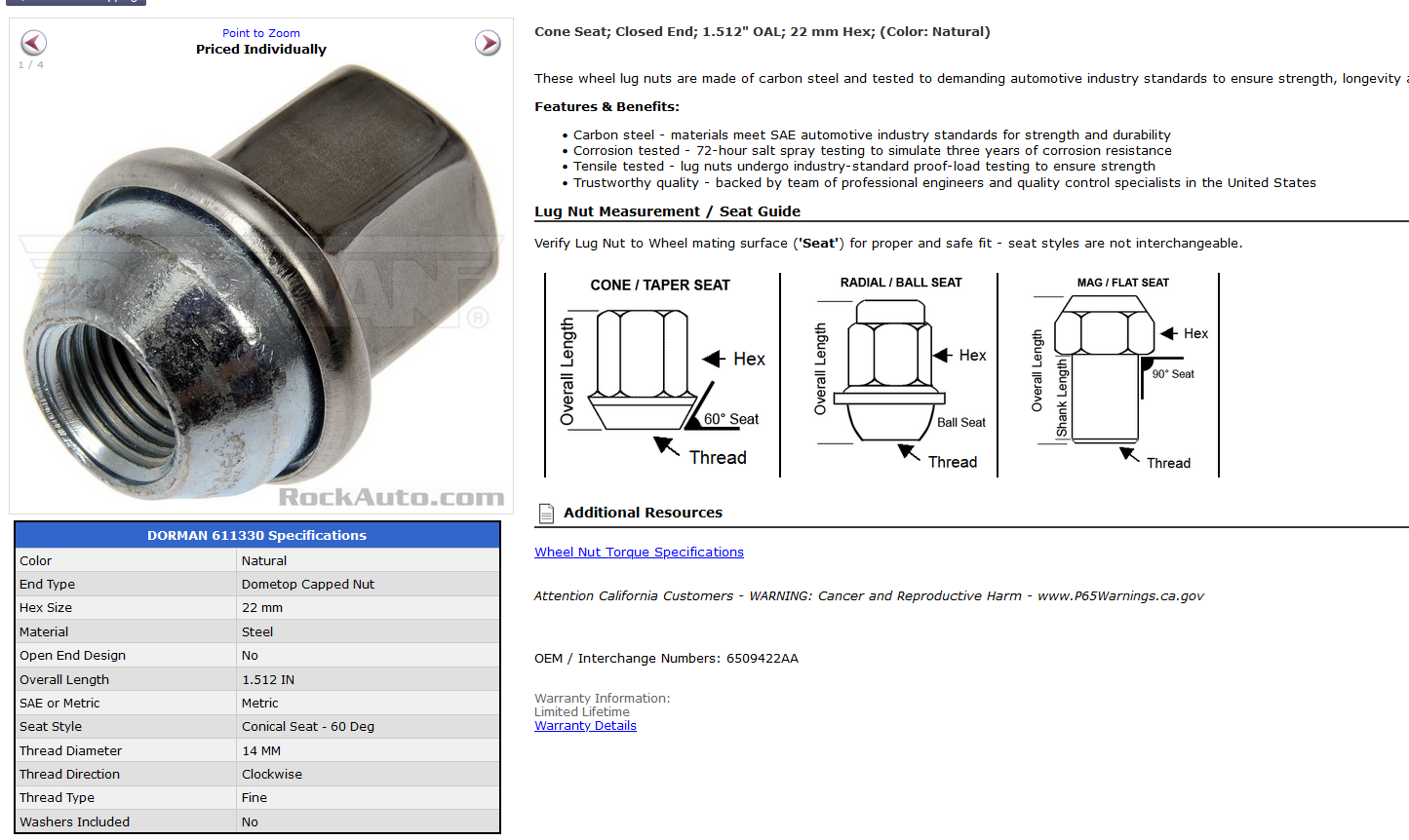

yes, factory specs on 1999 with 8 lug nuts is 9/16 - 18...where the newer lug from 2018 is metric, but appears longer by 1/2". This makes sense...if i can find a lug slightly longer in length then my current lugs.

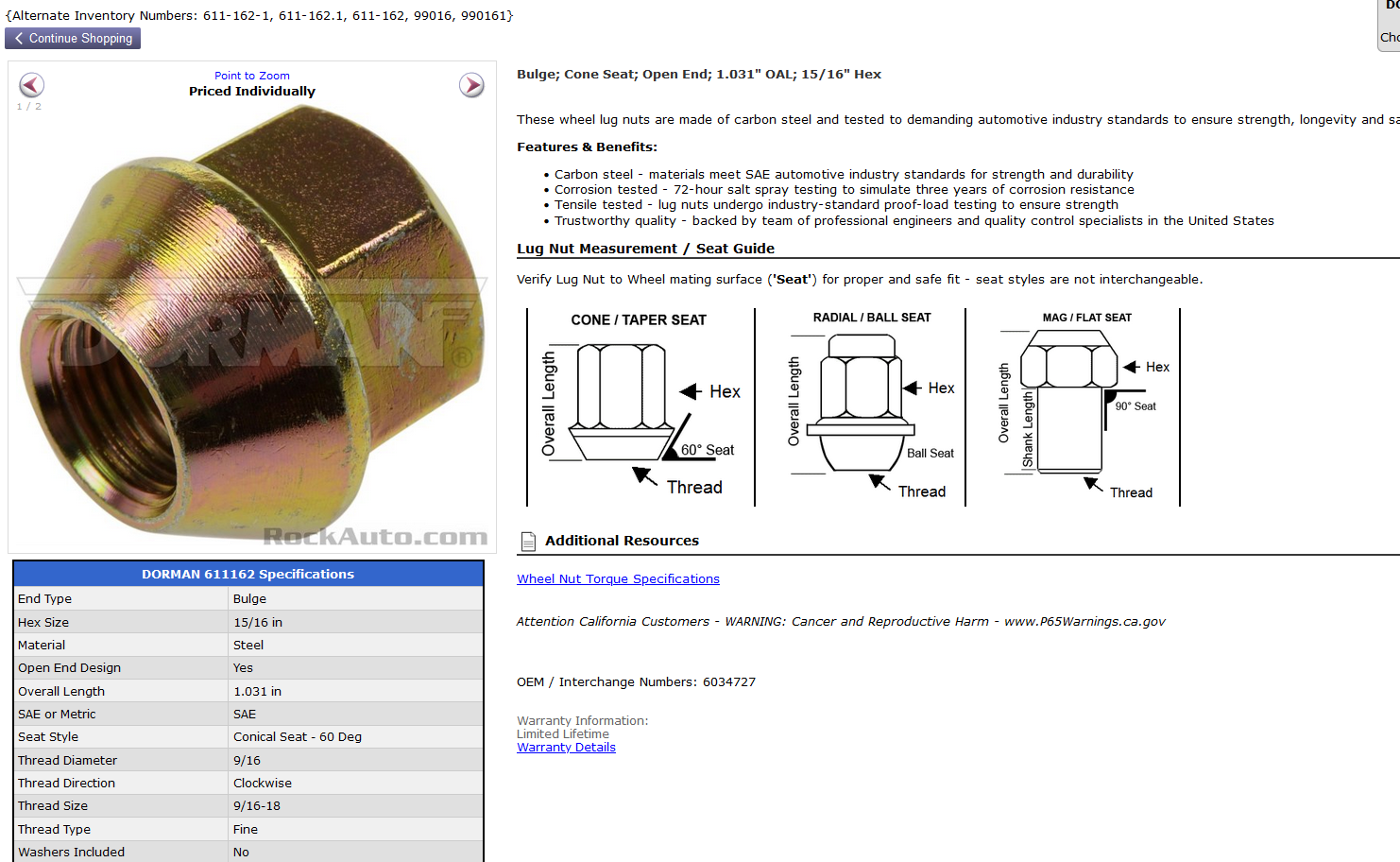

Here is what i found on rockauto....the newer lug appears longer in length and that is what i need, but in my 1999 size.

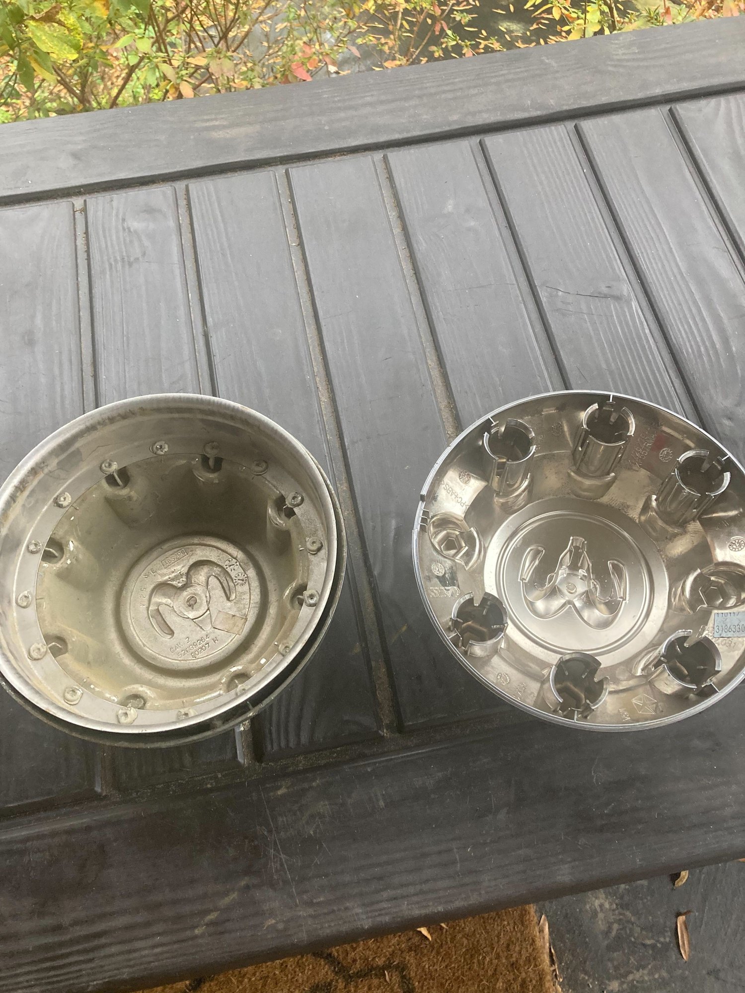

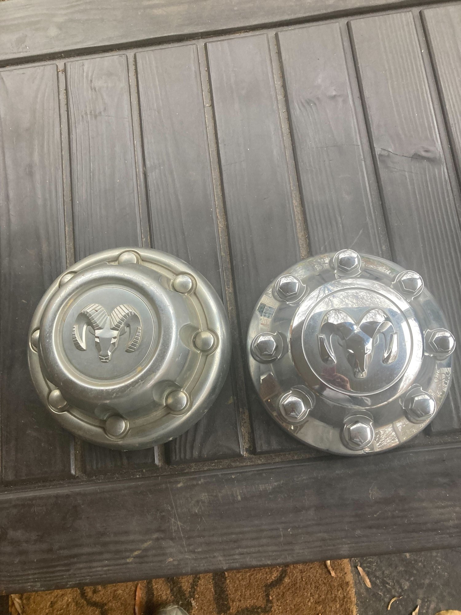

Pictured are the older 1999 which uses a secondary lip to hold the cap in place. the 2018 cap uses the lug bolt to hold in place.

The 1999 cap fits steel wheels, as it has a steel expansion ring that grabs against all 8 lugs to stay in-place. The later model 2001 cap that's used with aluminum wheels is more like your 2018 cap. I'm wondering if the hub on your rear axle is thicker/longer than the rear axles on the 2018 truck, since I seem to recall that Dodge moved away from using Dana axles in later years?
