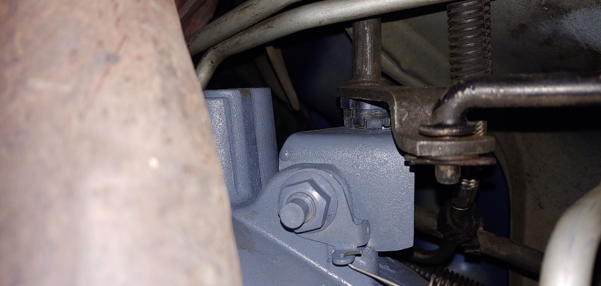

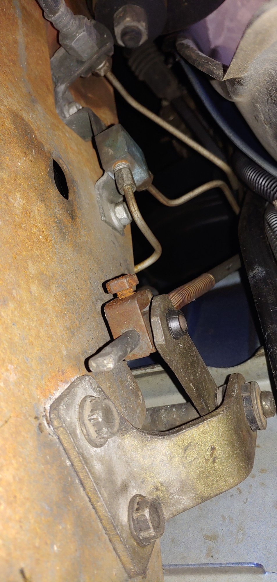

The shifting issue returned so I took it to a local transmission shop and was told that it had no second gear. I also mentioned that the gear indicator was off. $180 later, they had made an "adjustment" and I was told that the shifter lever was worn (it had no issues before the rebuild in November).
A couple of weeks later, I made a stop and when I started the truck, it would only drive 15 mph and would not rev. I slowly made it home (while driving on the shoulders and waving around traffic) and immediately cut the intake exhaust pipes in front of the cat. It revved...very loudly! After much searching, I purchased a CARB compliant cat at Advanced Auto for $900. It was too short plus I could not find couplings that were not sloppy (I thought they would be tight like copper plumbing couplers). I called a local shop and they said they could install one for $1000. After a loud drive across town, I dropped it off at the shop and they had a new one welded in 20 minutes (shop labor charge...$220). I am thinking that the tranny rebuild was unnecessary (even at 183000 miles) and that it lost power/slowed down to 25 mph on the freeway last October may have been due to a incrementally clogged cat.
Twice, it would not start in parking lots. I found that the neutral safety switch was not engaging without moving the shift lever back and forth. I crawled under (in my driveway) and found the two bolts holding the shift lever bracket to the frame had almost fell out. I tightened them and the gear indicator still had not been remedied. I then noticed what appears to be a plastic bushing nearer the transmission that is not in another bracket hole. I cannot seem to move it into the hole and am not sure if it should be in the hole.

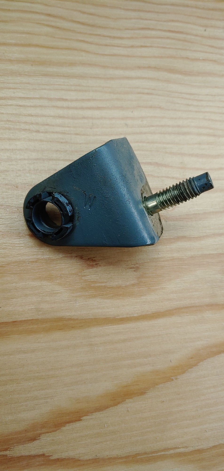

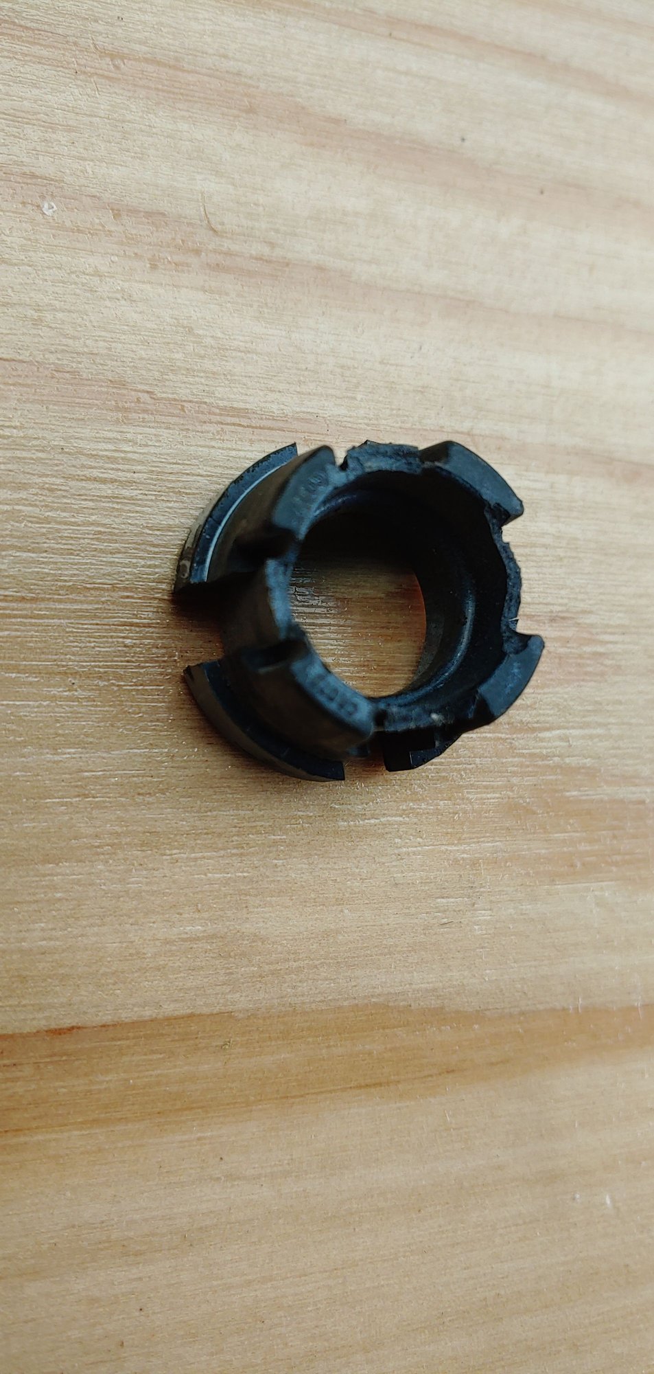

The dealer wanted $70 for this linkage
bushing...I paid $22 on Ebay.
Old May 23, 2023 | 08:46 PM
Keith_L's Avatar
Keith_L
Joined: Jan 2004
Posts: 1,429
Likes: 192
From: United States
Has it helped anything?
