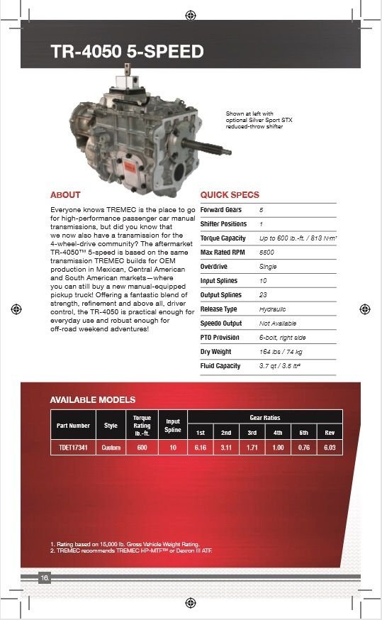

There’s also the Tremec TR-4050 which is what’s used in Mexico in place of the NV4500.

now that would be the way to go if I could find one that mates up and in my price range. Apparently you can get them with PTO too. Don't know what I'd use it for but still pretty cool. Put a plow on there or something maybe

They’re supposed to be a direct bolt up in place of an NV4500 (within a half inch of identical length).
