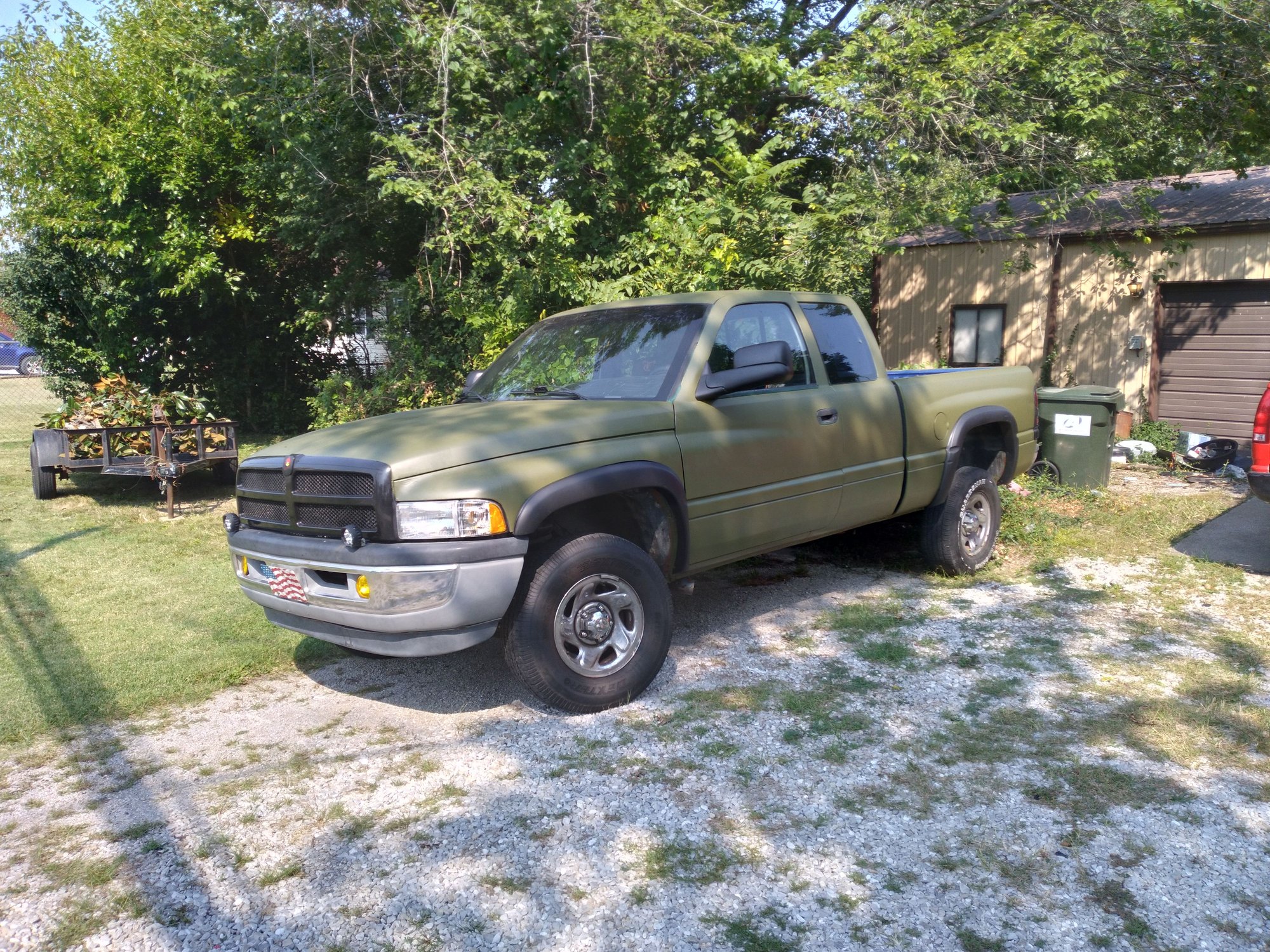

I've got a '96 1500 4X4. Extended cab and short bed. It pulls a car trailer just fine. I'd just rebuild your engine and transmission and replace the cat.. If you're running 3.55 gears, you can pull a trailer just fine by locking out the over drive. There is so much to swap to go with your plans, it wouldn't be the same truck anymore.

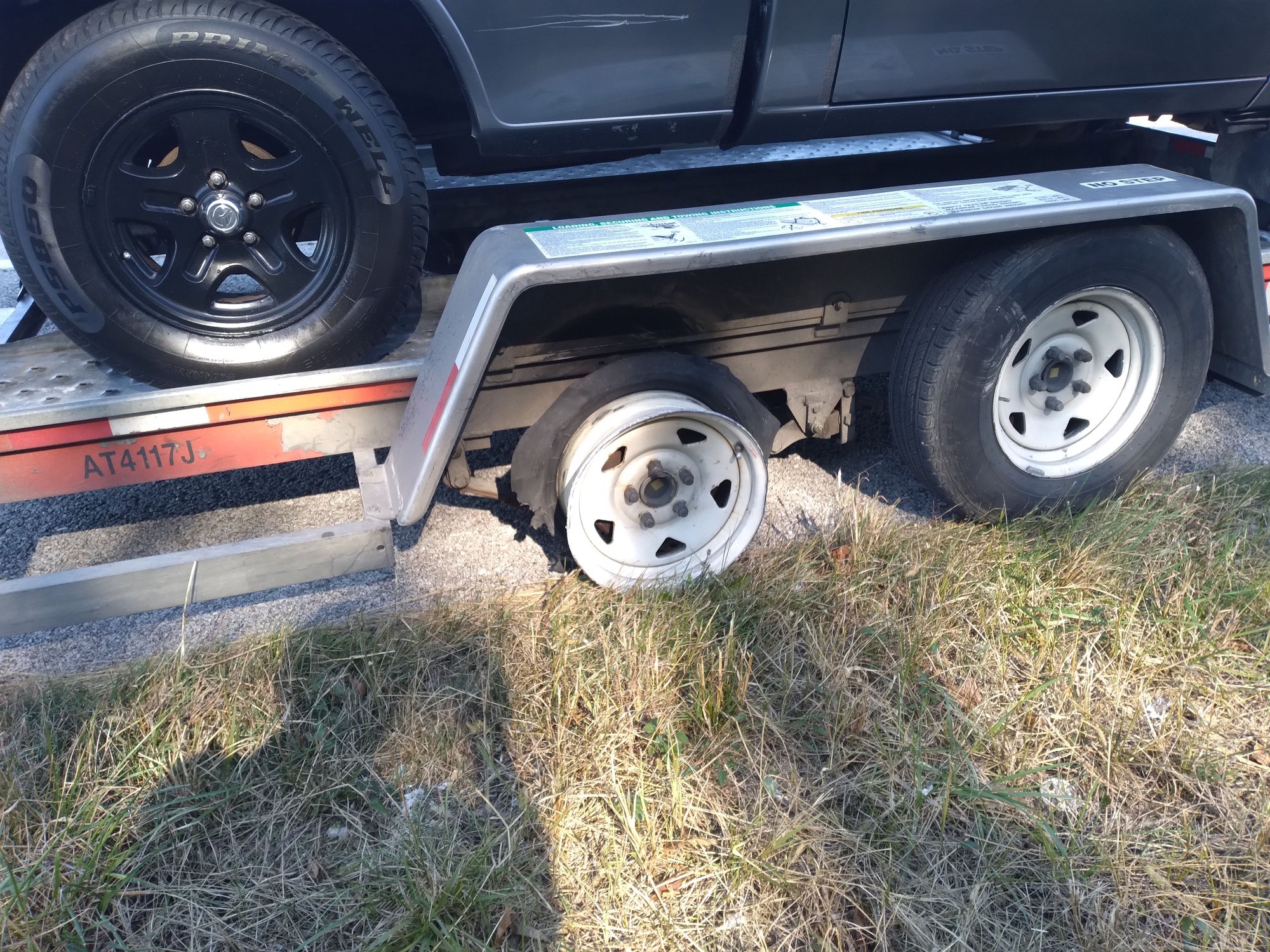

I was pulling a truck on a trailer,
...and had a flat on the trailer. I pulled it at least 10 to 20 miles and never noticed any difference in handling..

BTW, that's a Farmer Chic paint job, I'm cheap.
