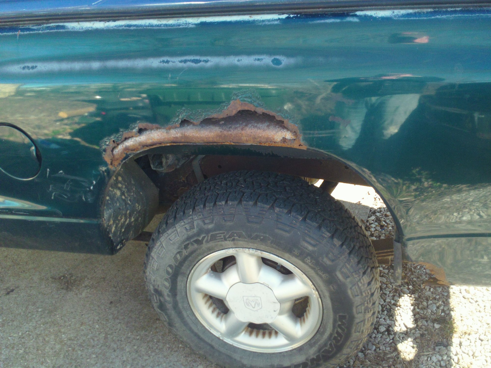

'97 Dakota Sport extended cab. It's a bit of a dichotomy. Ugly, rusty and the previous owners just put in gas and drove it.
On the other hand, it fired right up with old fuel in the tank, the cab mounts have NO rust (it came from north of me) and the frame doesn't have much. I was originally going to do a "Farmer Chic" paint job like the Ram but around here, red lights are a suggestion. I figure all the soccer moms who cut in and out of traffic all the time won't cut me off. I do always carry insurance, but they don't know that.
