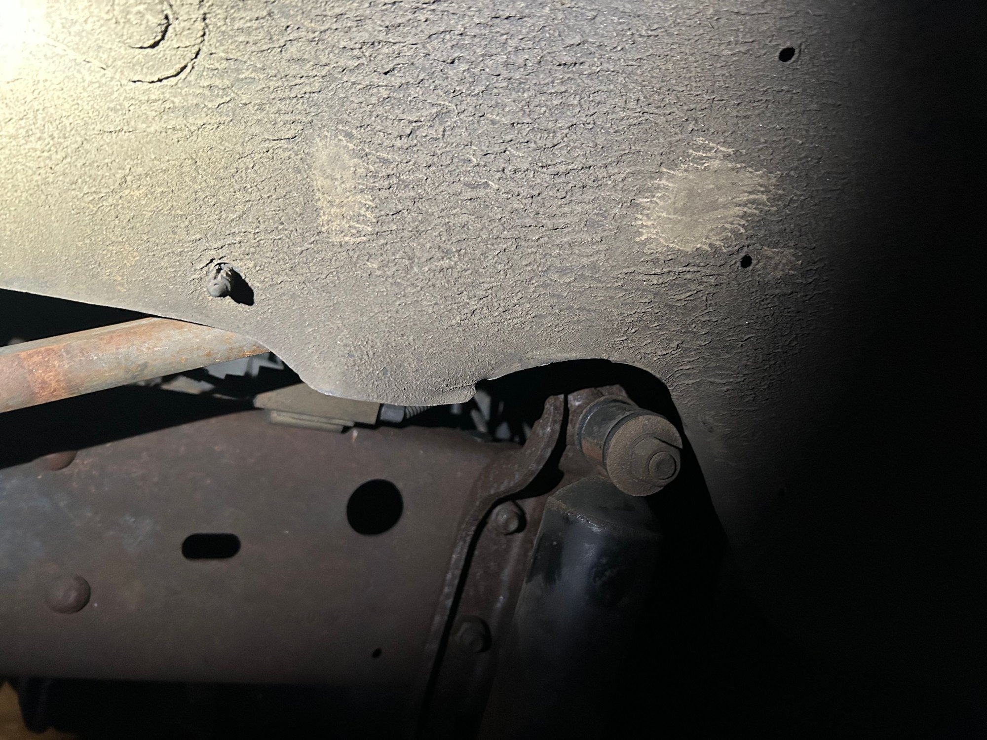

I've been flip flopping on whether I want to send the column out to be completely restored, or just throw that bearing in and call it a day. My plastic pin has broke inside the column assembly, causing the spring to serve ZERO purpose. Explains why my OE bushing slid out after going airborne over a speed bump in the city last year. Caused the rag joint to snag the inner fender and bind my steering while trying to make a right turn, headed right towards traffic taking a left. I had to JAM the wheel with considerable force to keep from smashing a couple cars there, then force it back with the same amount of force trying to keep the truck off the sidewalk and someone's front lawn.
I've got an old Borgeson shaft in there, but it's the rag joint one, thankfully, or I would've plowed all those cars, had crash damage to fix, had an insurance surcharge and claims to deal with. Would've been a friggin nightmare ...
Notch caused by the rag joint when it got stuck on the inner fender.
