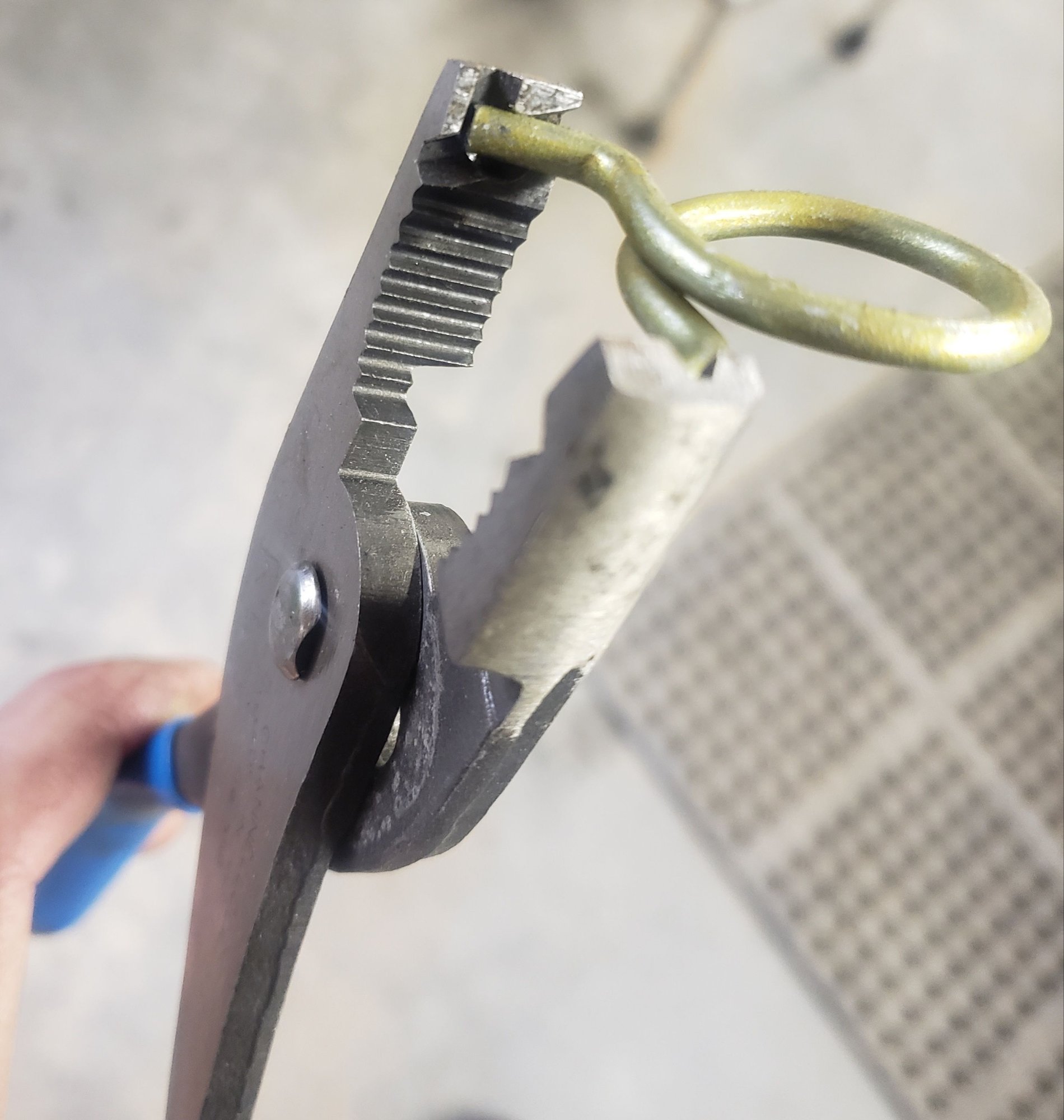

-spring clamp pliers to install the provided clamp. I have some now-discontinued Channelocks but these appear similar
https://www.amazon.com/IAG-Performance-Multi-Directional-Clamp-Pliers/dp/B0B7Z1VNMK/ref=sr_1_1?crid=1KXUTEKI4K3Z4&keywords=B0B7Z1VNMK& qid=1677954720&sprefix=hose+clamp+pliers%2Caps%2C4 522&sr=8-1
Stock pieces removed
Hose clamp pliers help to retain your sanity (if you have any left)

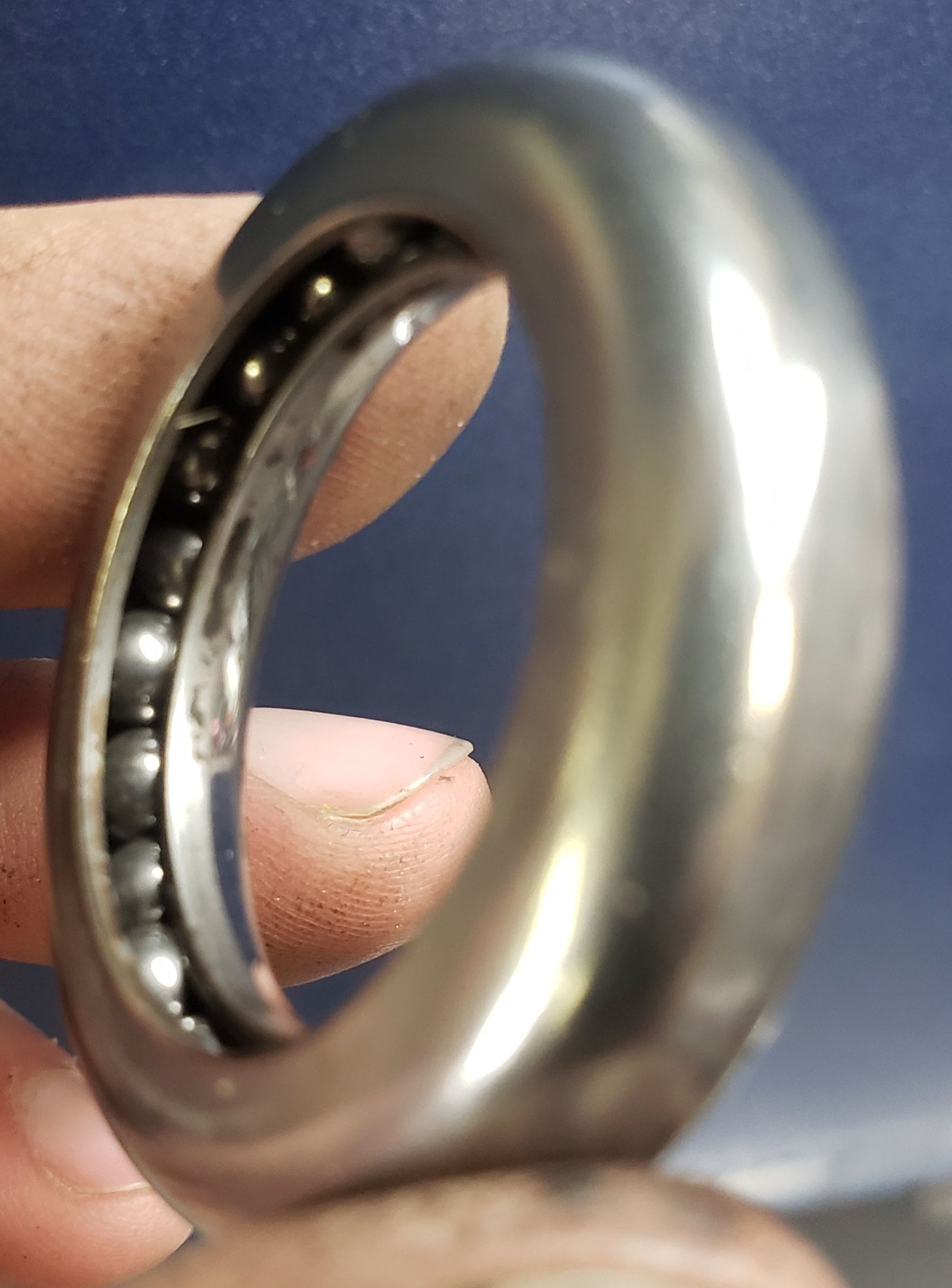

This weird crud was in the bottom of the stock bearing. I honestly don't know exactly what it is. Just useless trivia:
Old Mar 6, 2023 | 05:25 PM
Posts: 87,548
Likes: 4,230
Probably the remains of whatever used to seal that bearing...... Either that, or something further up the column is wearing away.

I pressed it out but can't find a single marking. The bearing is 40x25x9mm if anyone is a bearing guru.
I don't think the 9mm thickness is super critical. It could likely be 7mm or 10mm or more. This bearing is almost completely radiused on the OD with virtually no square edges, but I think a more typical squared bearing would work.
The only contender I could find was $57 on ebay. If it were more like $10 to $15 I'd order one for giggles. I could also only find more conventional sealed bearings.
I almost want to take it to a real bearing house and see if they could find a possible affordable substitute
