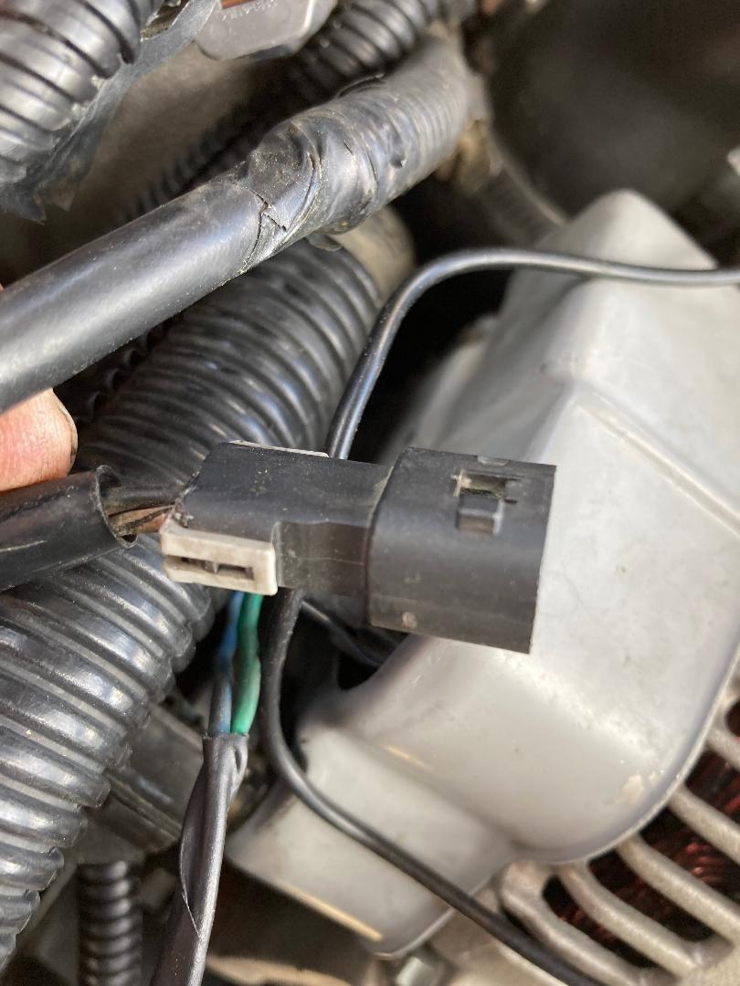

Thanks so much for the input. On enlarging some images I took during the project I see that the blue and green wires going down to the temp. sensor look like I've practically pulled them out from the top of the sensor. I'll check them closer tomorrow and let ya know.

I realize that my previous picture was the green & blue wires to the alternator.

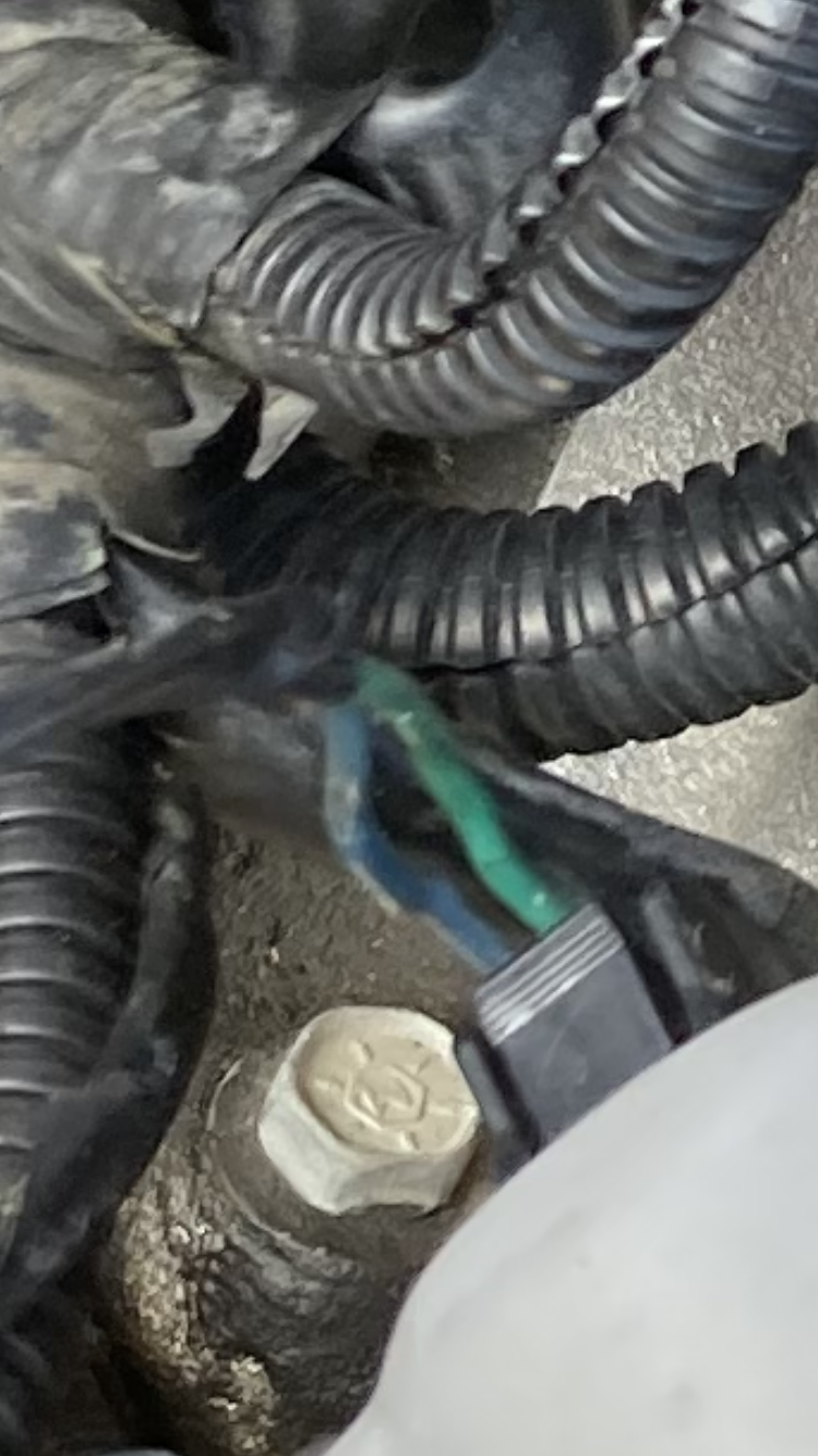

But here is the sensor wires and connector, they look fine but with the key on and using my test light sticking the needle into either connector with a good ground on my test light I'm not getting any response from the light at all on either connector.
And the temperature gauge is still pegged at 260 with the temp. sensor connector unplugged.

Most sensors are only 5 volts. May not be enough for your test light.

You have a short somewhere in the temp sensor wiring. Disconnected the PCM should read very high resistance (=very cold) but it does see very low resistance (=very hot). The check engine light is likely a P011x temp sensor circuit code. Do the "key dance" to retrieve the code or use a code reader.
