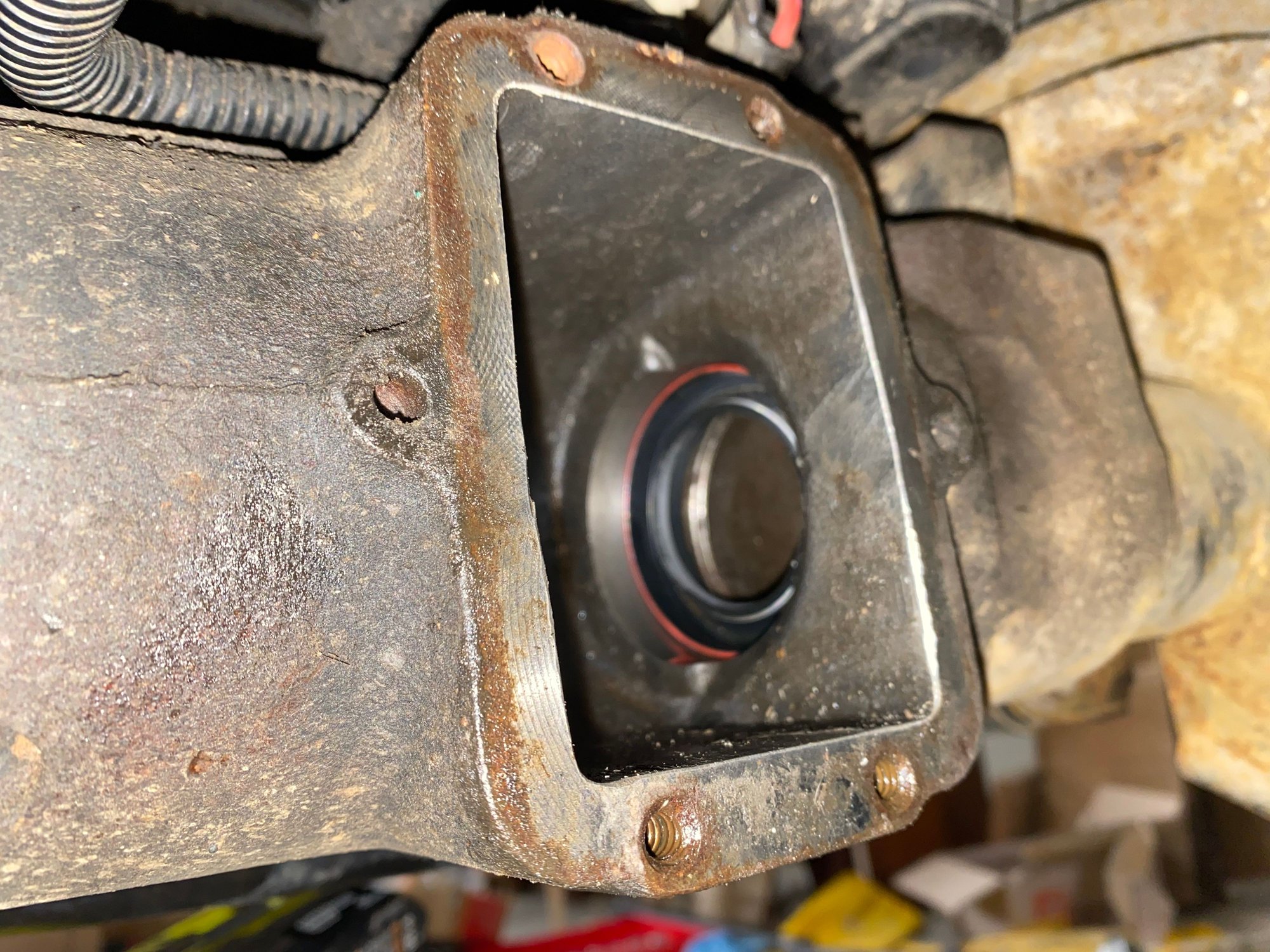

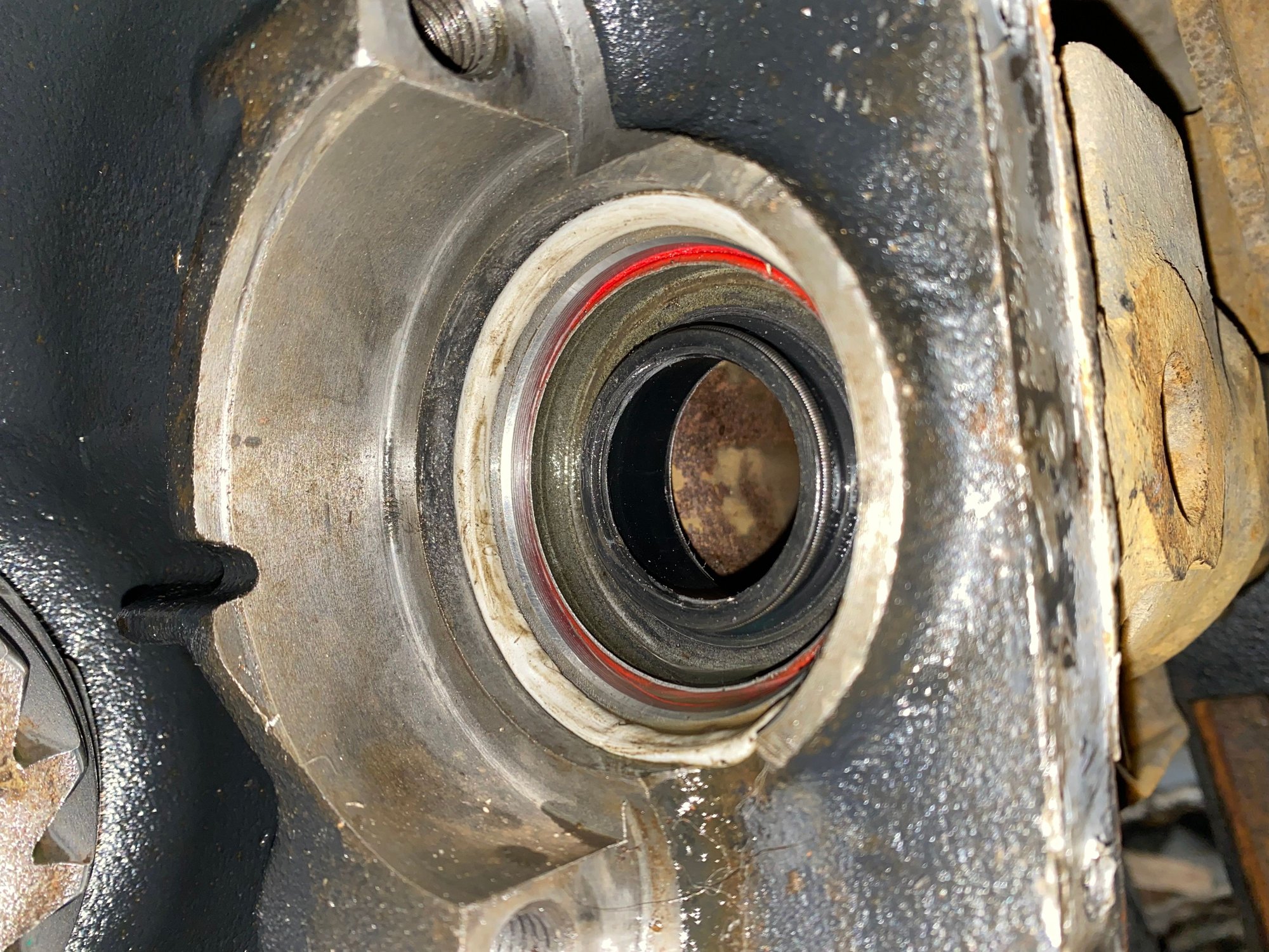

I think the formidable axle seal has met its match.
please let me know if these seals look seated all the way. I tightened down until it felt nice and snug
Driver side
Passenger side
Passenger side
Driver side
Old Mar 28, 2023 | 12:22 PM
Posts: 87,549
Likes: 4,230
Passenger side looks good. Drivers side might need to go in some more..... If you can see the other side, make sure the seal is seated on the lip that prevents it from going further.

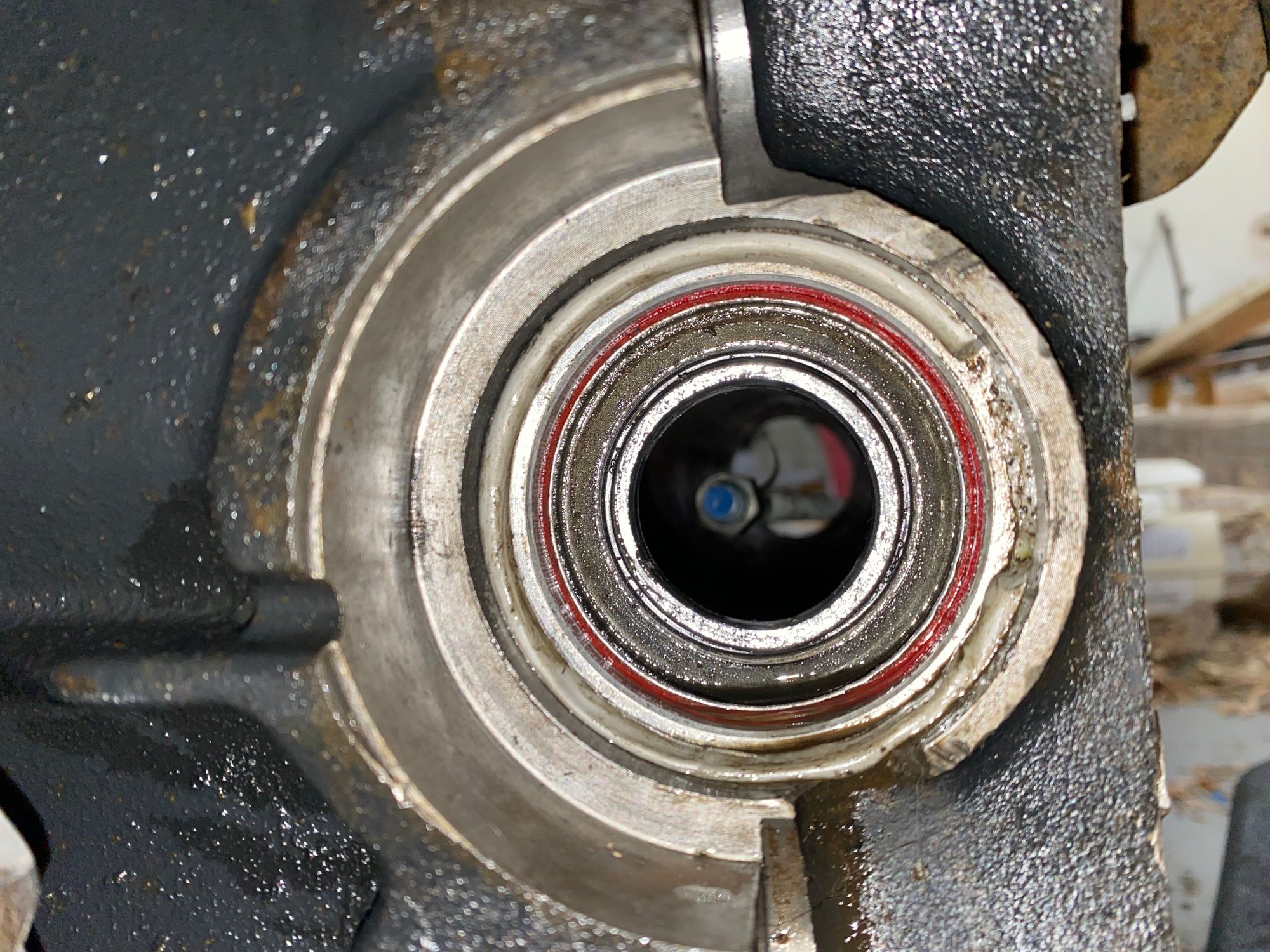

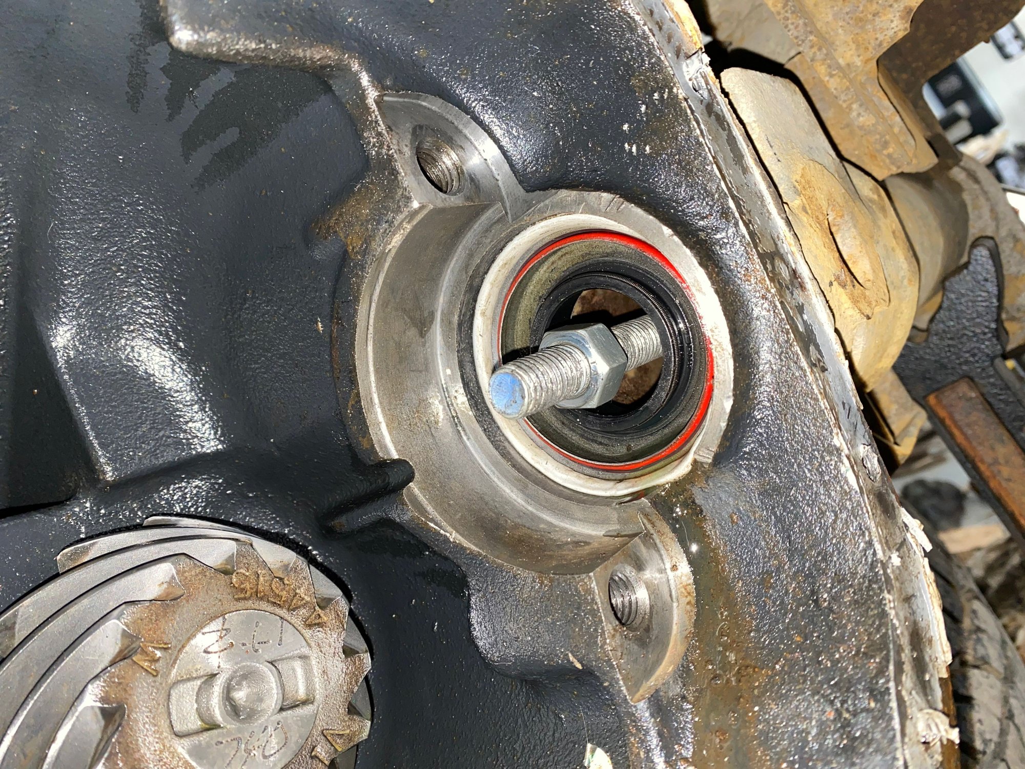

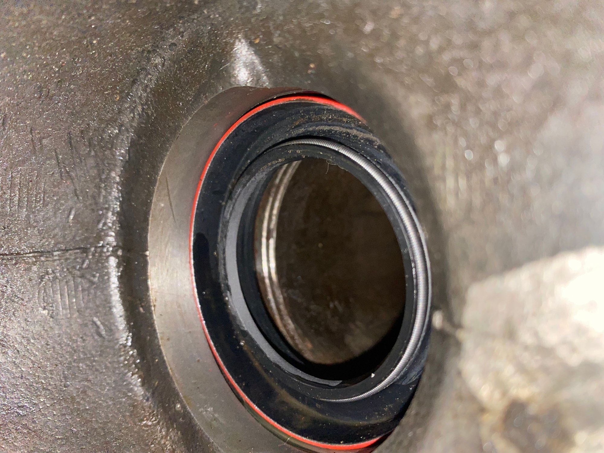

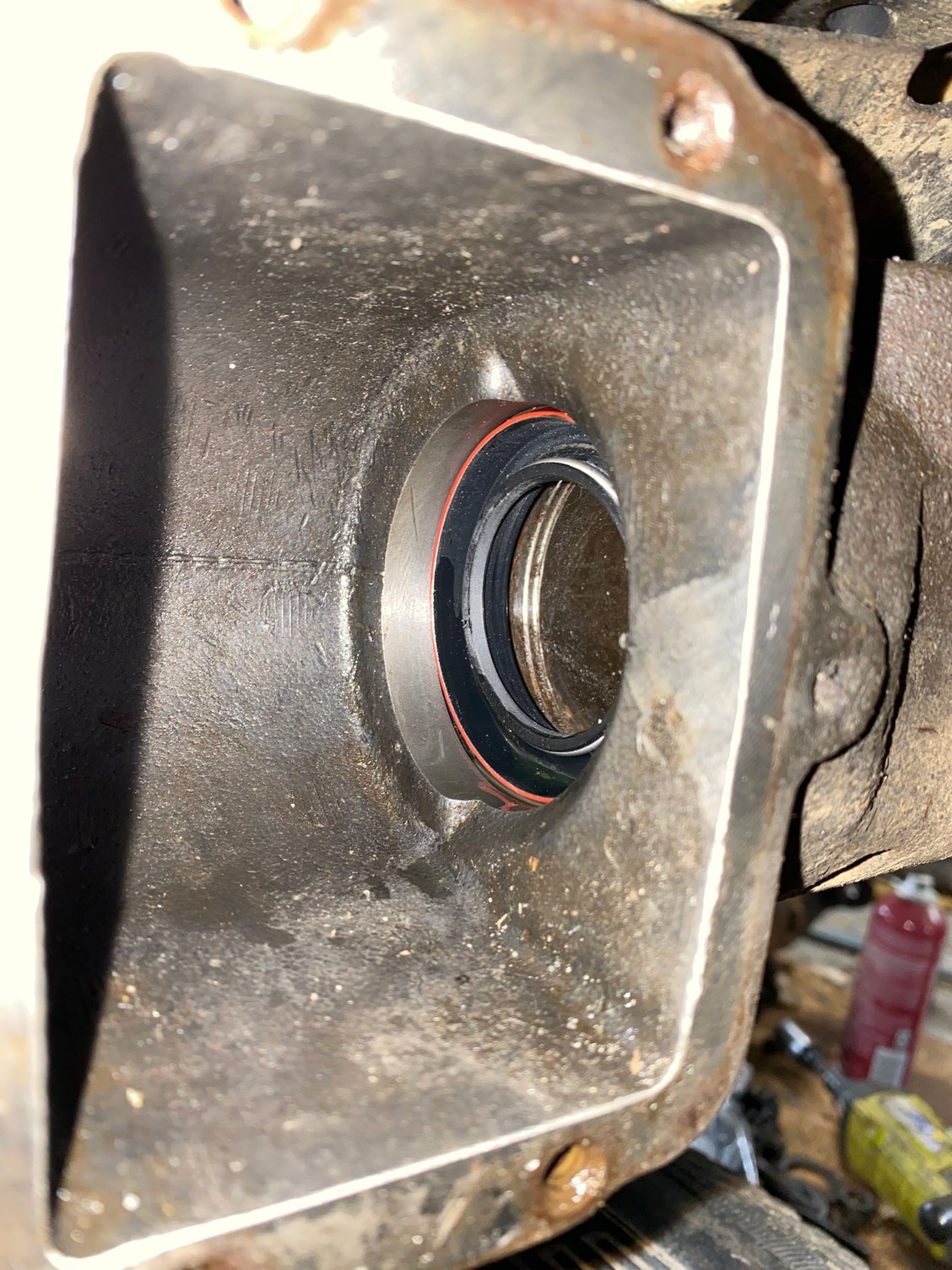

I was able to tap the driver side in a bit more. Wondering about pulling the drivers side in more just don’t want to damage the seals
Driver
Driver
Passenger
Passenger
Passenger
Passenger
Passenger
Old Mar 28, 2023 | 01:25 PM
Posts: 87,549
Likes: 4,230
That looks good.
