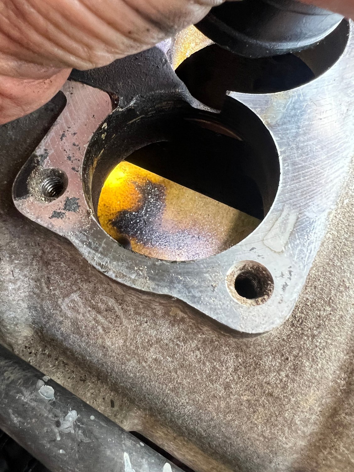

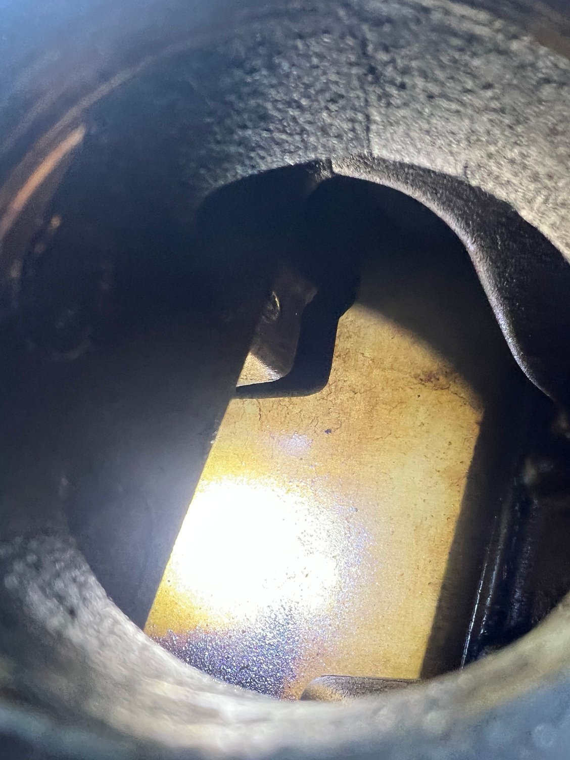

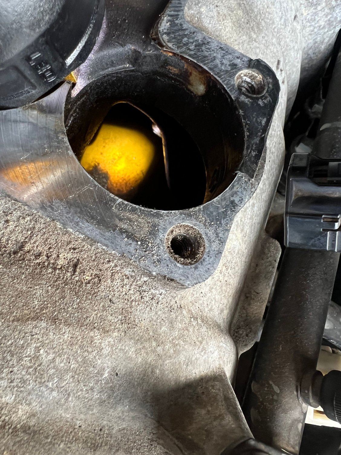

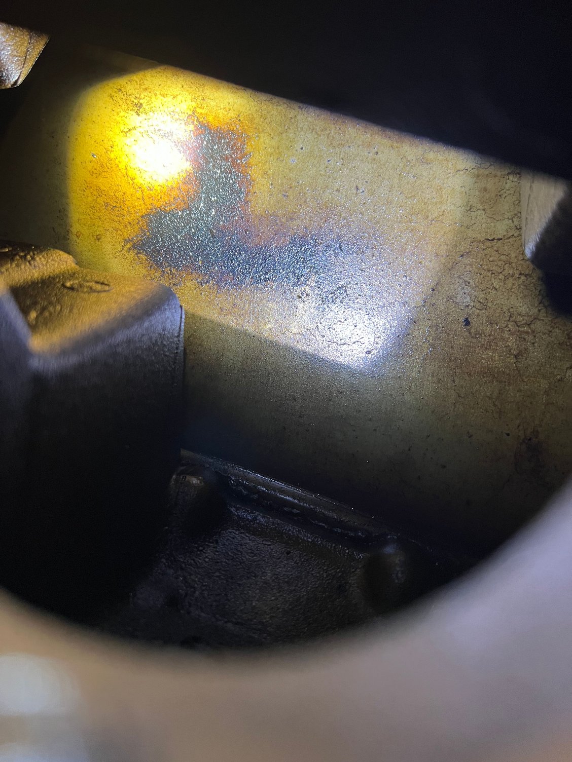

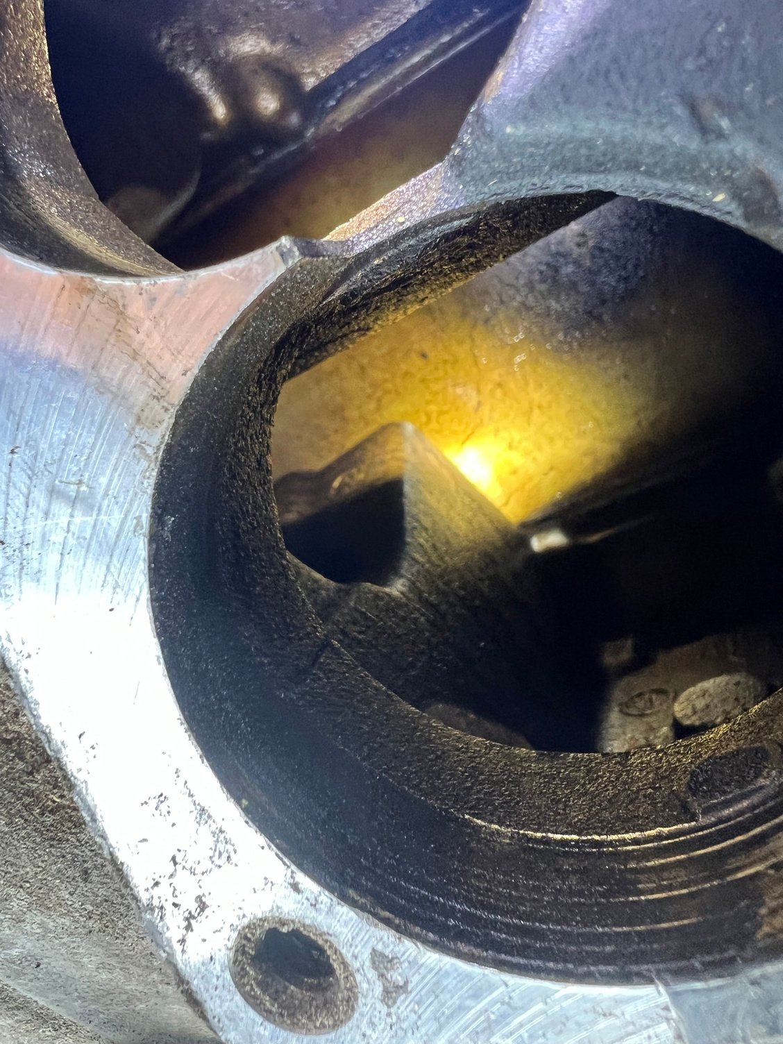

I pulled and cleaned the throttle body. I didn’t think the plenum looked that bad. Remnants of bad pcv maybe.
Afterwards it ran great, until it warmed up, and then the same no power, backfiring mess.
Old Jul 4, 2023 | 08:28 PM
  #27
Posts: 87,548
Likes: 4,230
Yeah, plenum doesn't look too bad. I agree on the PCV theory.

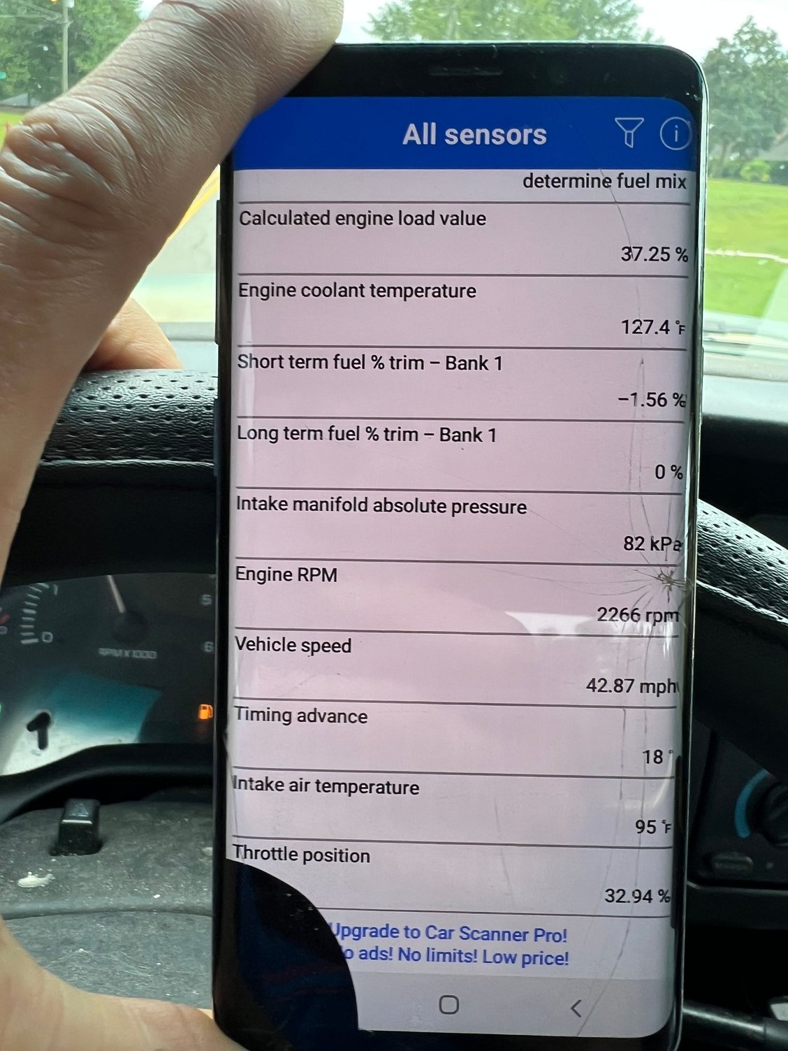

Something is getting hot, and failing. Have a scanner that can read/log live data?
Old Jul 5, 2023 | 05:33 PM
  #28
mcgraw's Avatar
mcgraw
Joined: Mar 2023
Posts: 25

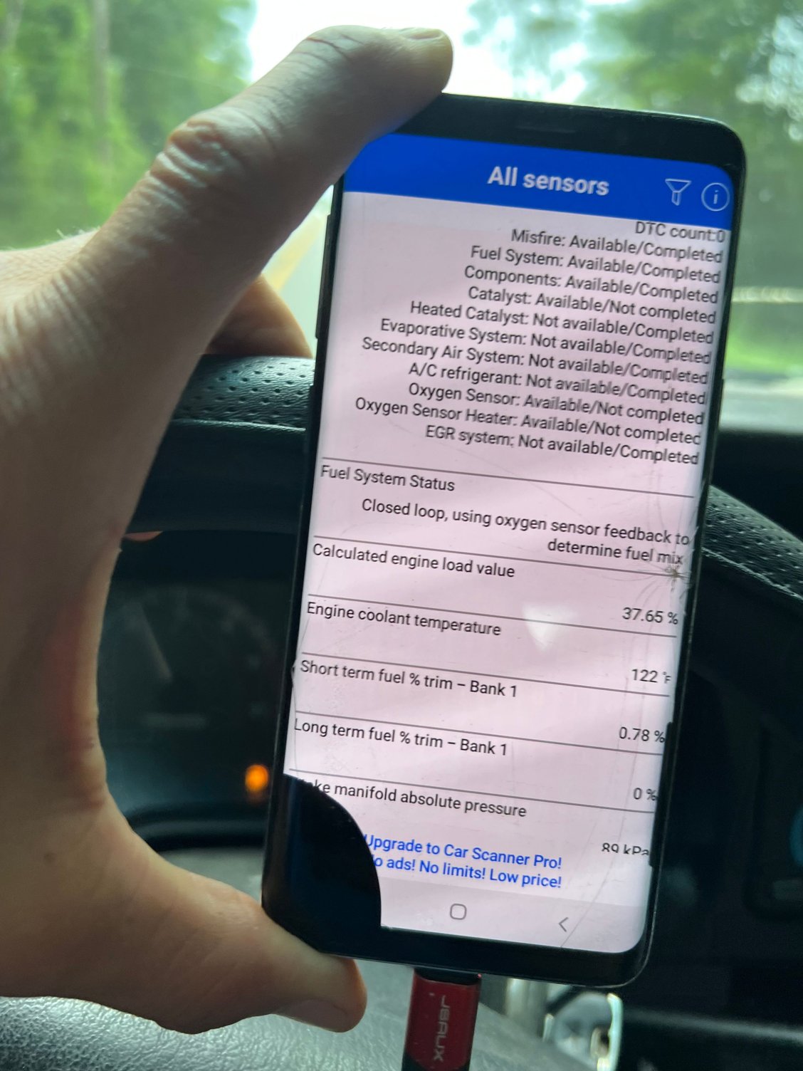

I do have one.

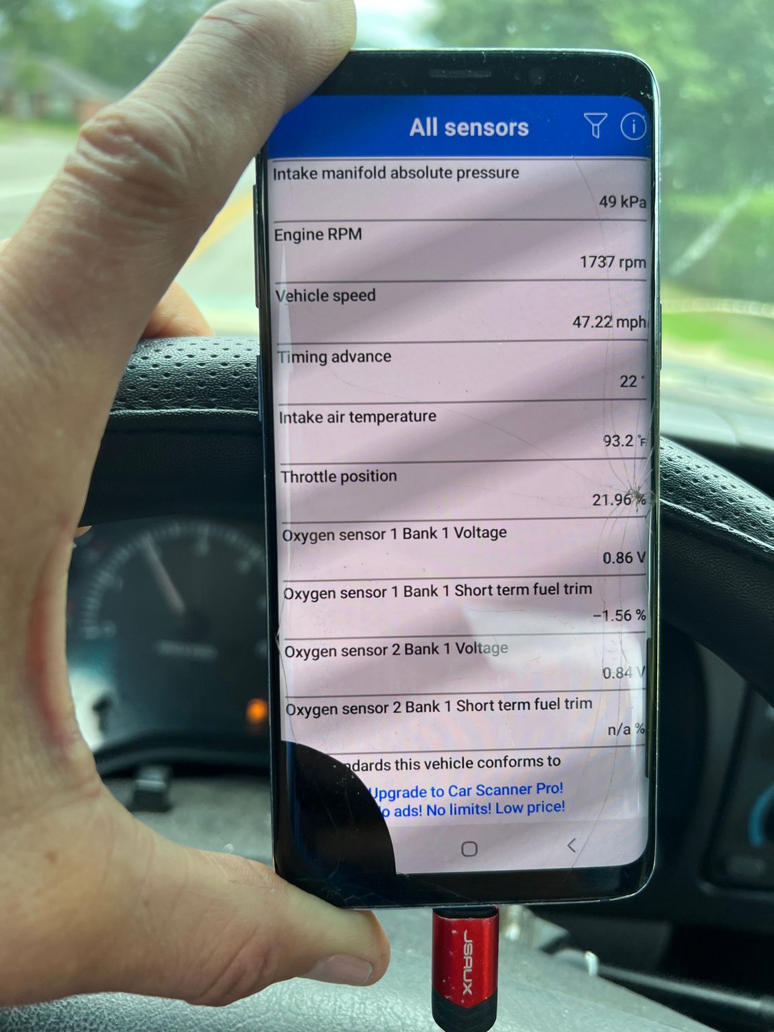

I am curious what others oxygen sensor values are showing.
Old Jul 5, 2023 | 07:03 PM
  #30
Posts: 87,548
Likes: 4,230
O2 sensors look good. Voltage should be rapidly switching hi/lo. (between 0 and 1 volt)
