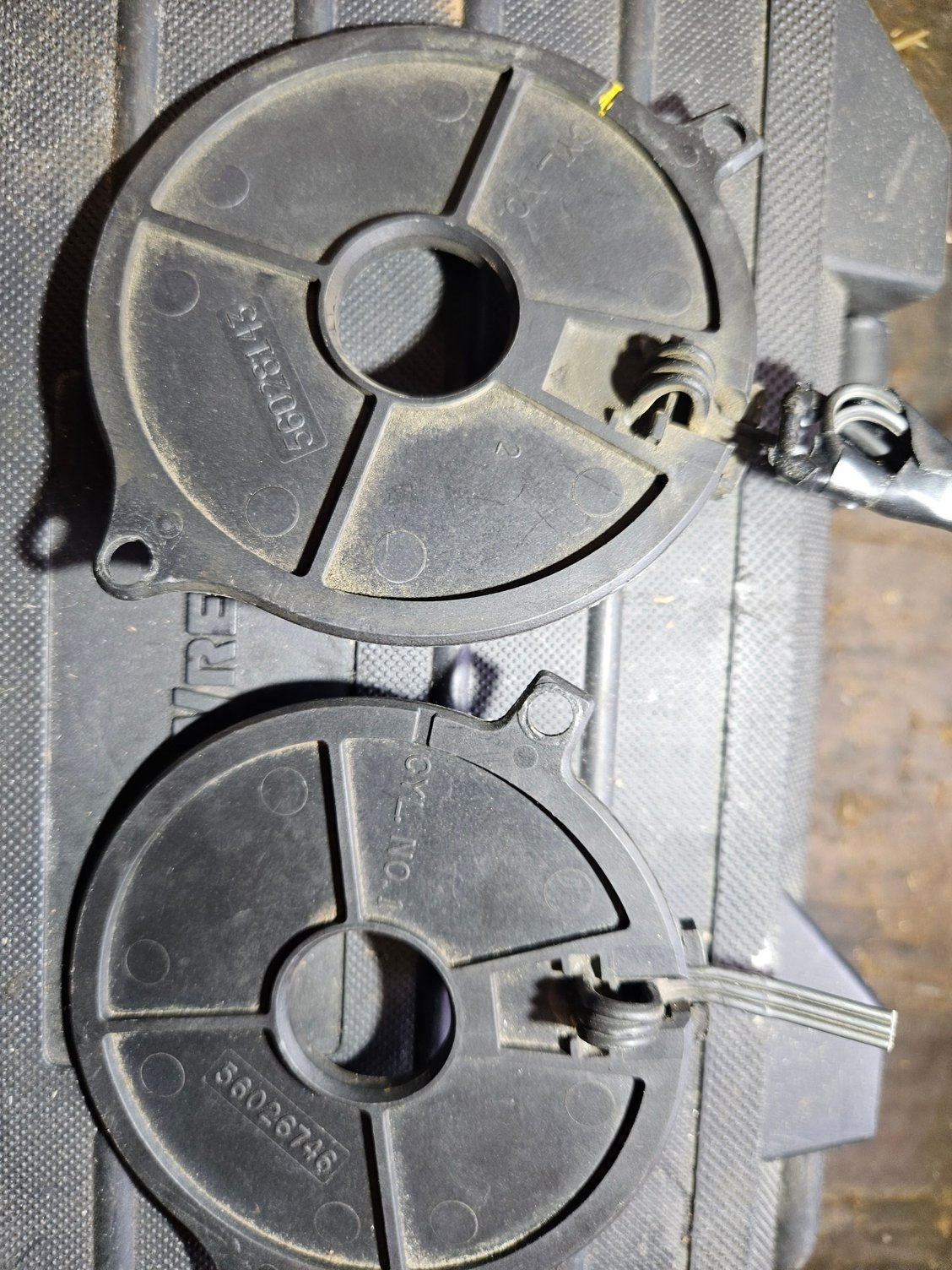

If looks like there was a revision to the distributor, but, still the same part number. (the two letters after the number) The sensor connector being different is just Dodge being dodge, the sensors work the exact same way.

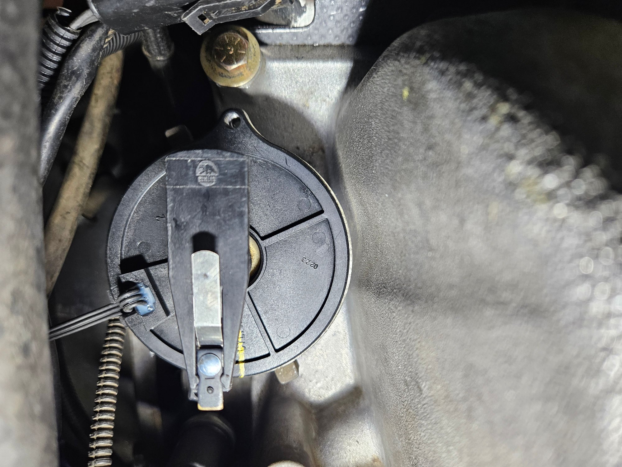

V8 on Crank lined up with TDC on cover , rotor pointing to #1. Timing should be Good,Right?
Pick-up coil....1995 on top and 1998 on bottom.

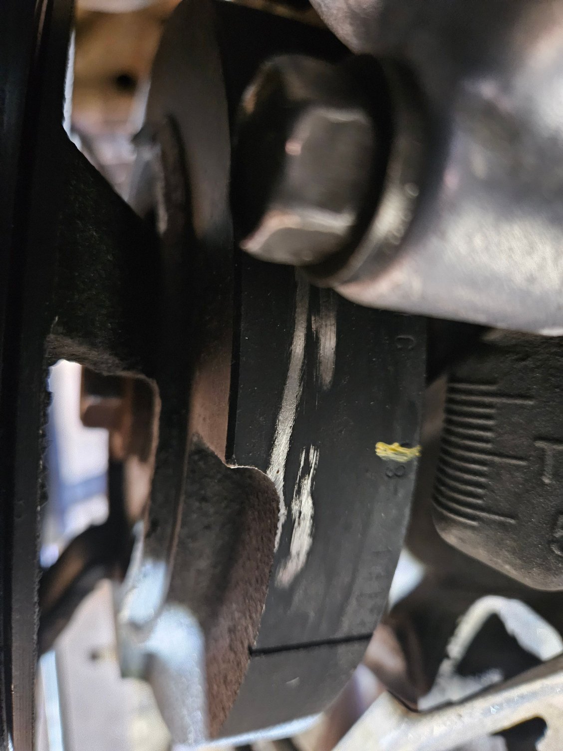

This is what it should look like at TDC #1 on the compression stroke. You have two temp sensors in the 95, What intake did you use? I believe the 98 has one(forget what year they changed). One for temp to the pcm the other for the dash gauge.

This is what i have right now without moving anything. Thoughts??
"V8"...TDC

If the yellow line on the pickup coil there goes thru the notch for time, align the yellow line with rotor. You only get a tolerance of plus or minus 7 degrees...

Just climbed up in to loosen the Distributor bolt and adjust to line everything up with yellow line.
using my phone camera to look straight down on it and now is lined up but now it backfires while idling through exhaust.

Just adjusted distributor to align mark with rotor.
would idle with occasional backfire and smelled very rich. Bumped distributor counter clockwise and throttle response returned, idle smoothed a little and backfires when revving engine...but if you slowly increse throttle then it will climb. Still backfires
I kept bumping counterclockwise the distributor until it wouldn't run good anymore.
I then realignaligned crank on compression stroke and reset distributor and rotor. Started truck and Bumped distributor clockwise....now idles better, throttle response is better....but hesitates and then rev's....and backfires!!!

Going to pull timing cover off and check timimg marks next.

What is the yellow mark on the balencer? It it off that much? Did the balencer outer ring move? The notch should be TDC #1.
