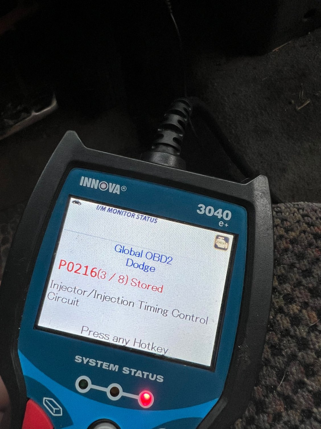

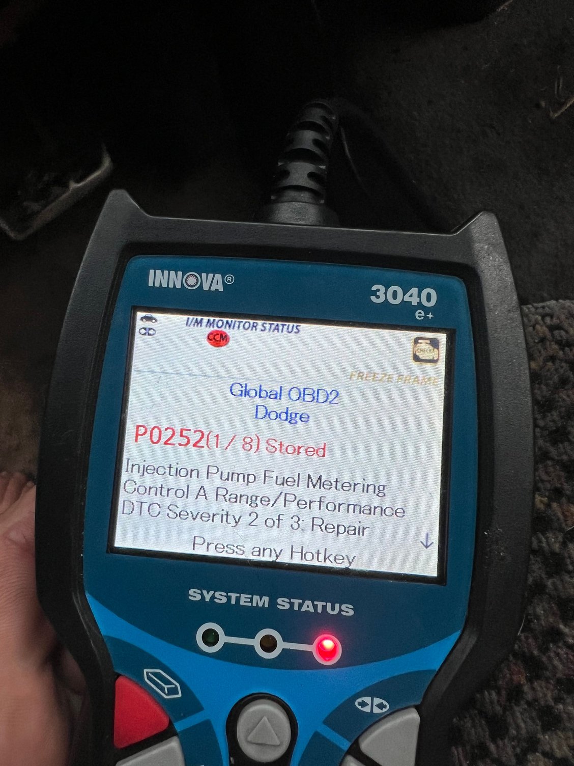

Installed a new fuel pump and truck is throwing a bunch of codes and won’t crank

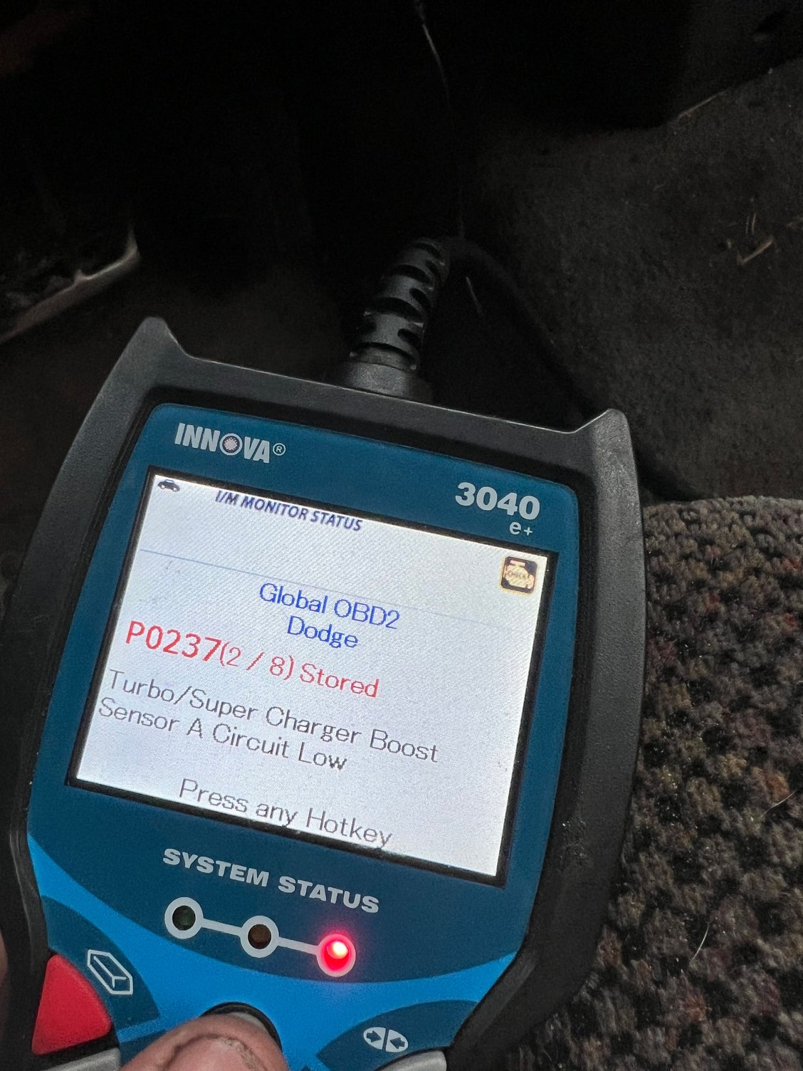

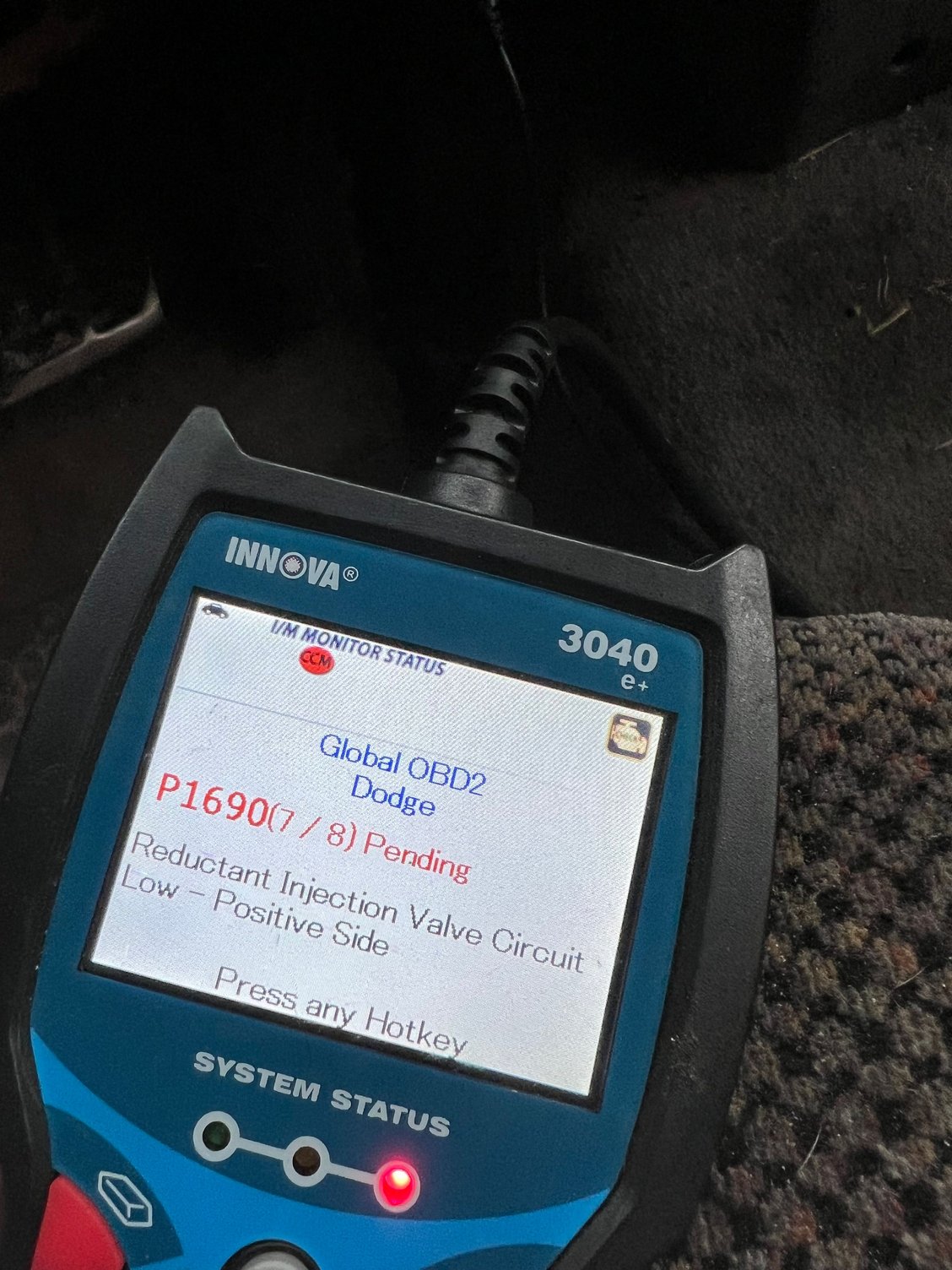

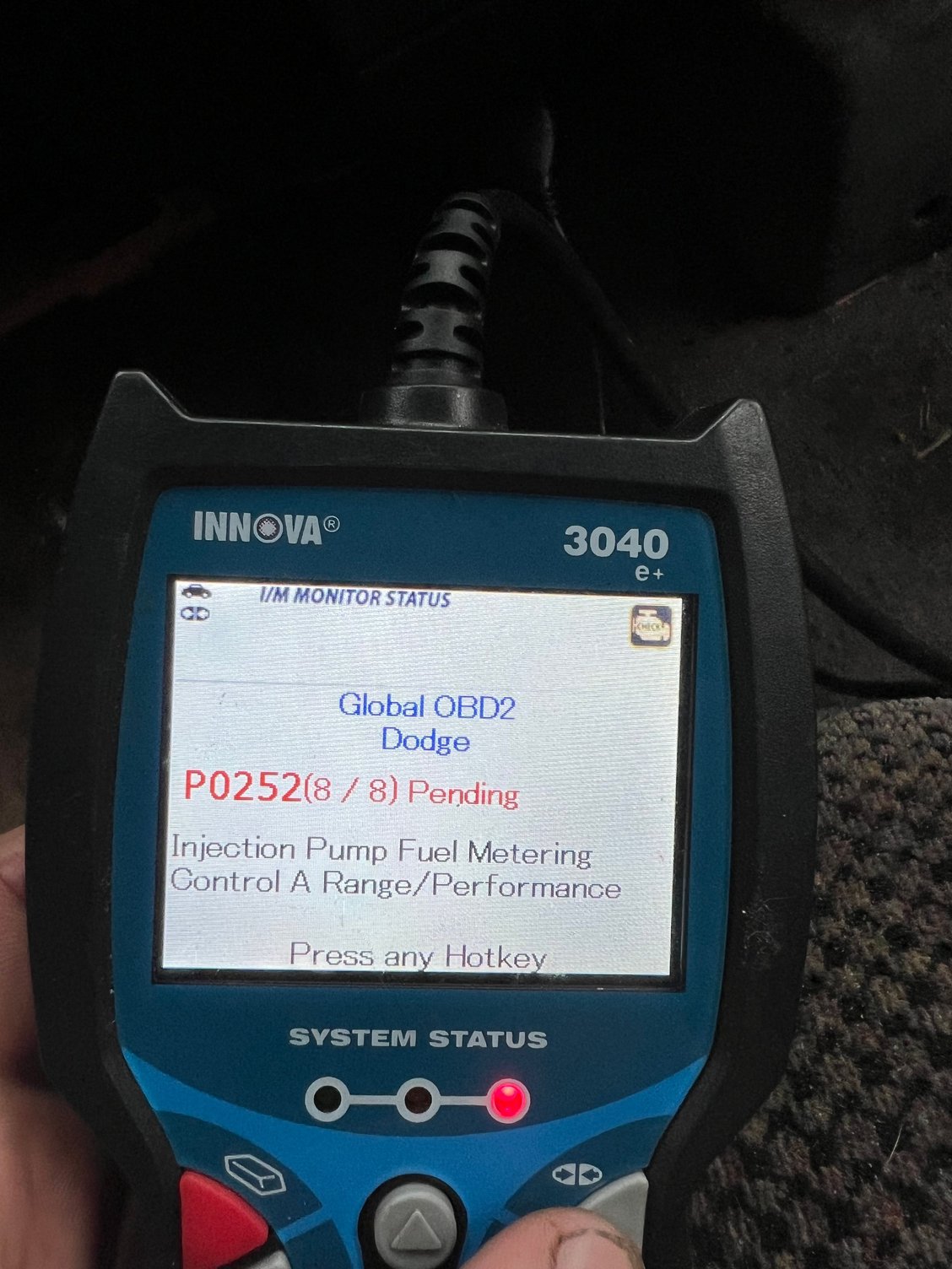

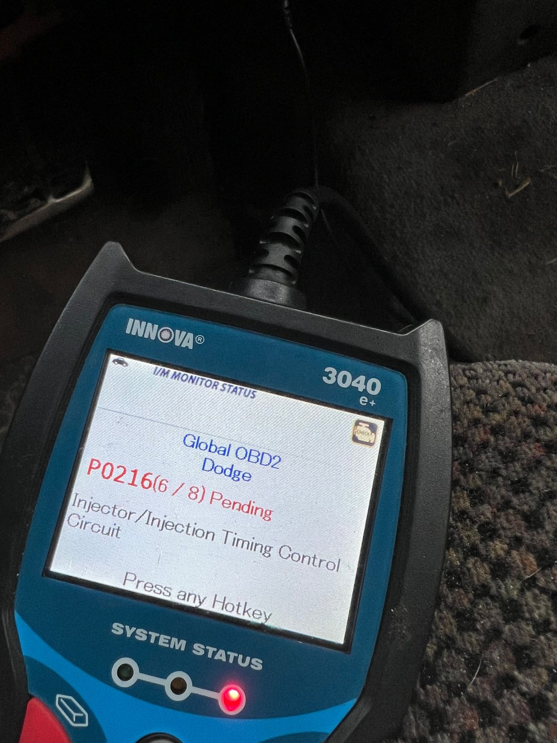

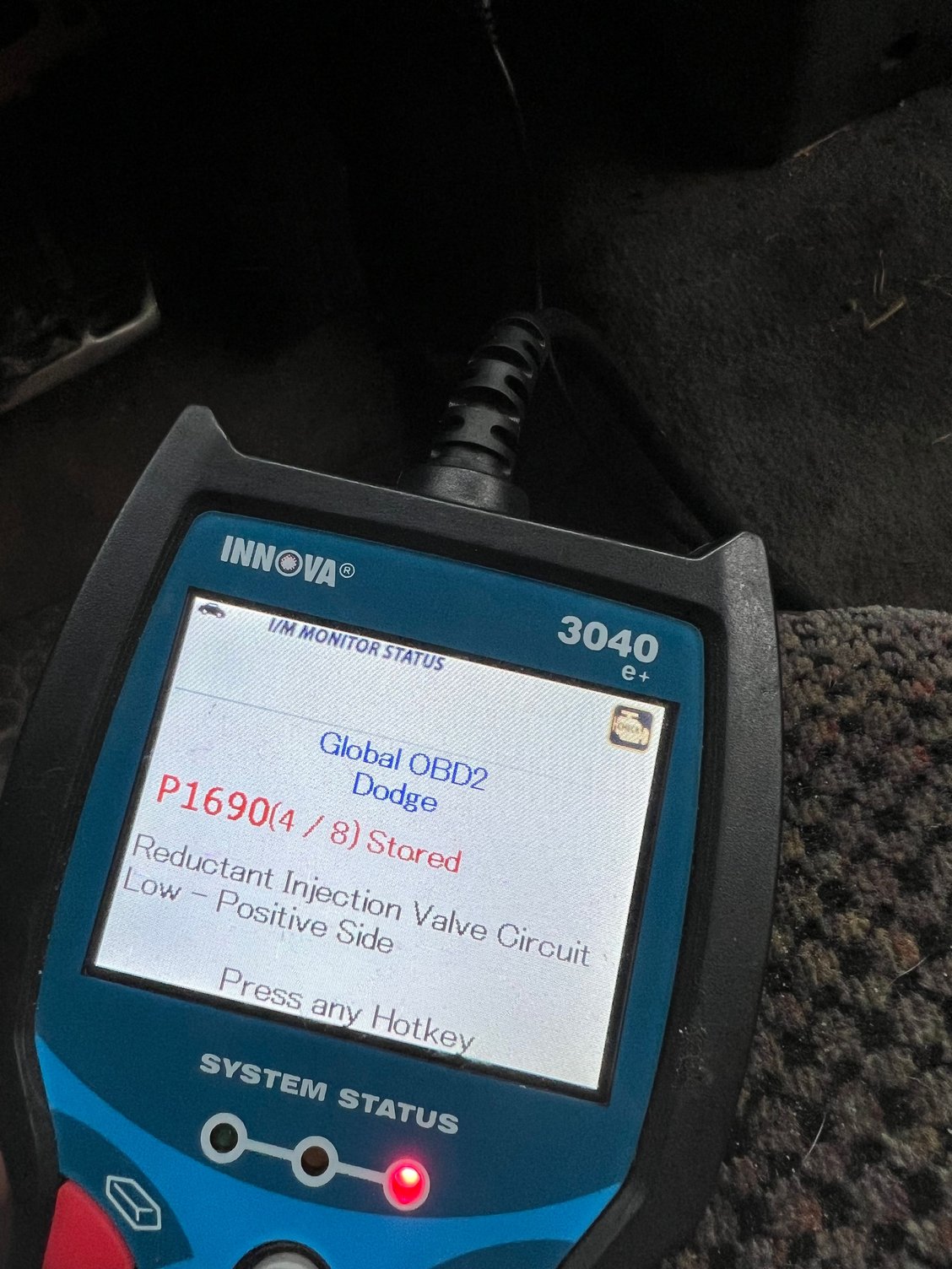

I installed a quad I’ll a adrenaline and a air dog raptor replacement fuel pump on the block and now the truck won’t start I had the quadrille on before and it started but I didn’t fun because of the fuel pump being and I just started to make sure it was working

Every thing is whining about low voltage..... Check some of those sensors, is voltage actually low?
