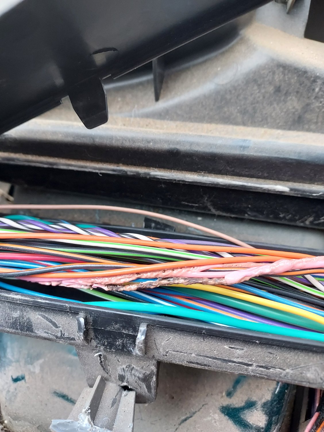

Ok, so I'm still on this rebuild, got the motor and tranny successfully transfered over from the 1996 to the 1999, got the wiring harness figured out. While connecting up the interior plugs, I came across a wire that was melted in the main cluster of wires going from a main plug and the floor side by pedal to up behind the dash. After tearing apart the entire dash, I found that wire led to behind the speedometer/instrument pannel and just dead ends into a plastic cover. Unfortunately, this wire has melted through several other wires. What would be the best way to going about fixing this problem?

When I run into wiring issues like that, I just cut out the bad section of wire (one wire at a time) and solder in a new section of wire, using heat shrink tubing to cover the soldered splices.
okay! Thank you so much!

You may want to figure out what caused the melting wires in the first place. Replacing the wires is not curing the cause. Find the wire in the service manual and go from there.
