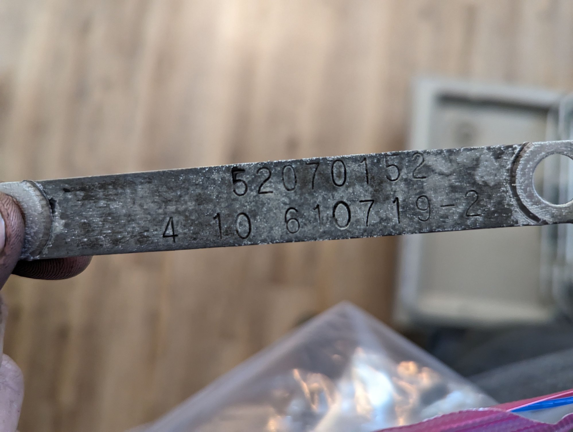

My Haynes manual shows it had either the 44 or 60. I assume mine was the 60 because I bought a gasket for both the 60 and the 44 and the 60 fit. I have been trying to look up what the axle id tag number on the differential cover means but have not had much luck decoding it yet.
52070152
4 10 610719-2

All 3/4 and 1 ton trucks had the D60 in front.
On your tag, the top number is the Dodge part number, it has 4.10 gears, (at least, it did from the factory) and the last set are probably a BOM from Dana/Spicer.
