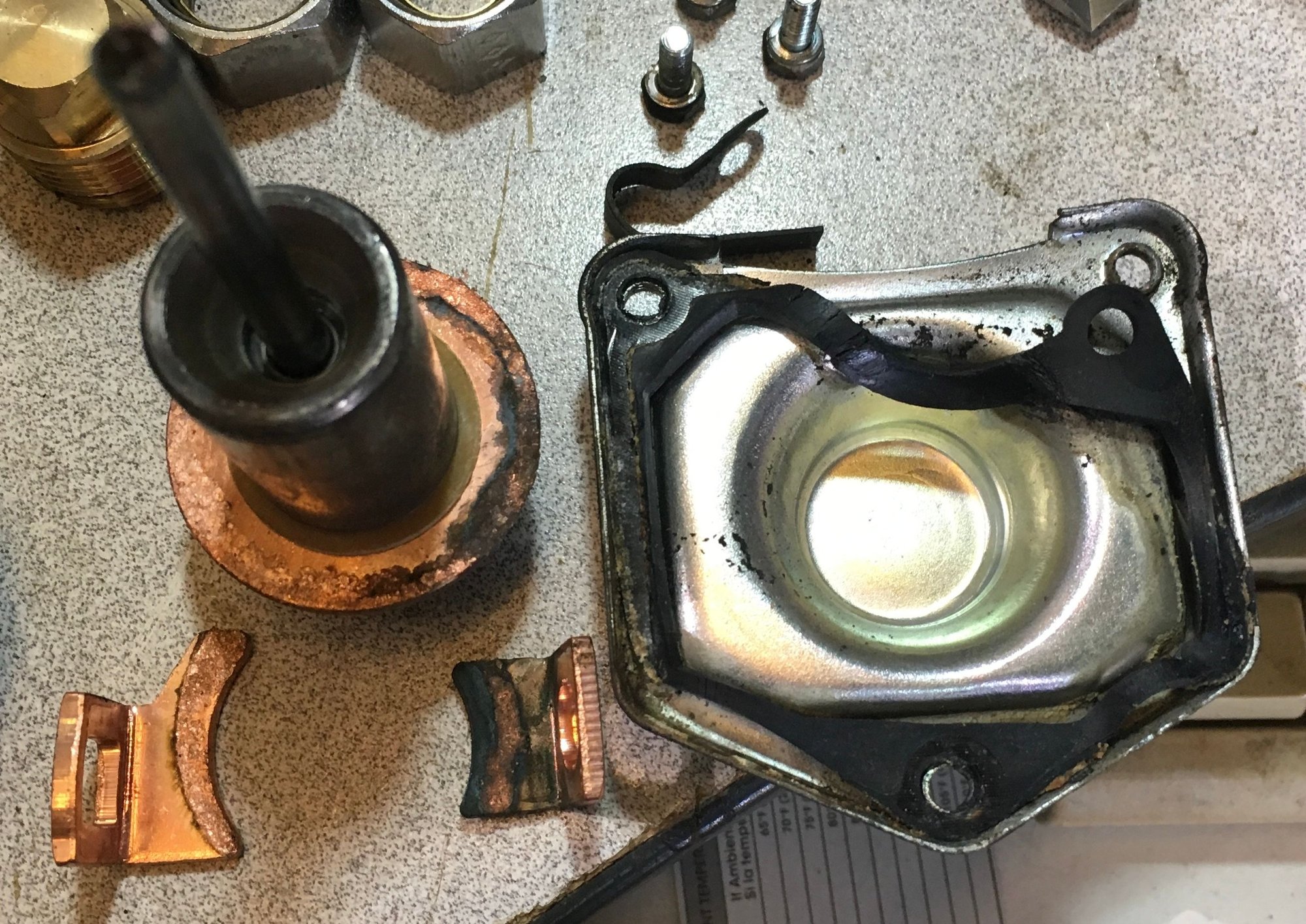

My first guess would be the contacts in the starter solenoid.
This is what mine looked like when I had the same symptoms… replaced the contacts and it’s been good ever since.

Another vote for bad or dirty contacts in the solenoid. here is 1 I shimmed with a rubber washer to get a bit more life out of a very worn contact.
