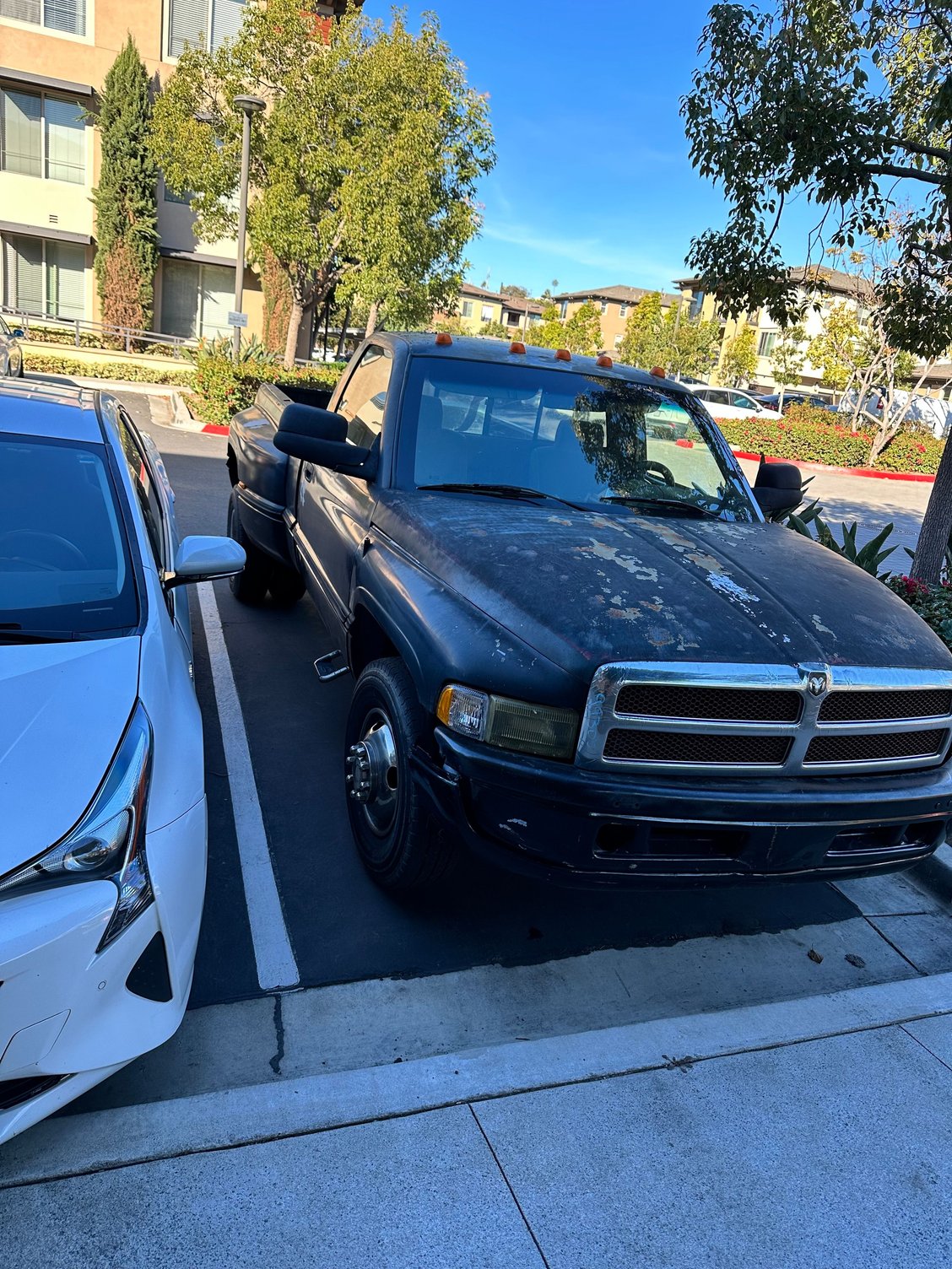

I just picked up a 1996 ram v10
3500 dually, was running @ 230 coolant temp. I went and bought a new thermostat and gasket. Upon removing the thermostat housing It Turns out there wasn’t one installed so I installed the new one. Let it run for 30 minutes and it’s slowly climbed to 215 - 230. Didn’t go over the 230, drove it home and it dropped a bit but not much, is that normal? Or too hot? Thanks in advance
