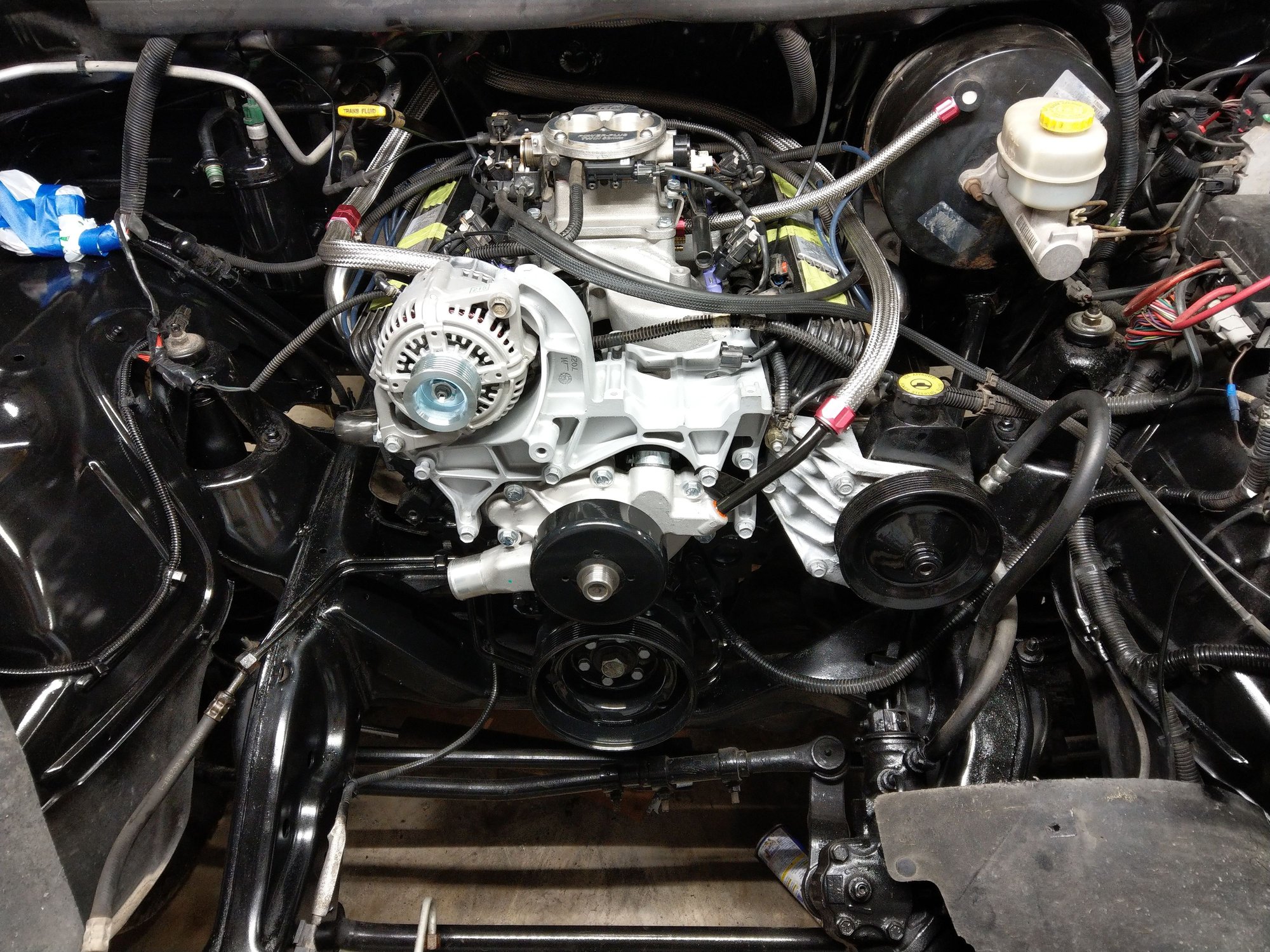

Hello, New to this forum. I am just looking for some direction in options. I have a 99 Dodge Ram that I replaced everything. Everything except for the body. anything that turned or moved has been replaced.
So part of my build I went with a 408 stroker along with stronger planetary gear setup with 2800 stall. I am just trying to get it tuned correctly. I have a T&C with 3.6 vvt that pulls harder than my truck along with a 300 with a hemi in it that puts you in your seat. This truck doesn't feel much better than the 96 ram I had with 5.9 magnum and mopar performance computer. Kind of at wits end. It pulls hard low then around 3000 to 4800 feels stagnate, then 4800 up to 6 to 6500 feels like a beast. can't figure out the mid range lag.
I am floating other possibilities. Stand alone system , possible carb swap. any recommendations would be greatly appreciated.

Truck itself
408 stroker dropped in.
