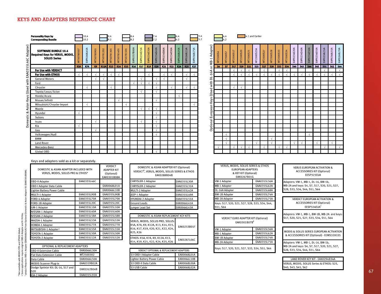

Howdy all, I just got back from a month abroad and in that time ordered a Snap-On MT2500 and what was supposed to be a full kit. It appears that the seller included the incorrect data cable and while the listing stated it included adapters for Chrysler it appears it didn't include the OBDII adapter or any personality keys. I found a chart online denoting the keys and which ones work with each type of vehicle but it appears there are several options for Chrysler vehicles. Does anyone know if it matters which key I snag so long as it is compatible with Chrysler vehicles? Thanks!

It should come with several different cables, and a bunch of keys... Contact the seller and ask where the rest of it is.

It did come with a ton of cables, but the data to OBDII cable was the incorrect one, and it didn't come with the separate OBDII adapter. I reached out days ago but have yet to reply, and the listing wasn't eligible for returns so I'm stuck with it (might chargeback the credit card in the event they just fully ghost me), but in the meantime I just want to order what I need and hit the ground running. I wanna drive this baby so badly

The chart looks like if covers ALL of the snap on scanners..... Hhhmmmm.......

When I use my MT2500 with the Chrysler primary cartridge that covers the Dodge Ram truck's year, I don't believe that it asks me for a personality key. Now on ODB1 stuff, it most certainly asks for the personality key. Do you have a specific Snap-On cartridge that covers Chrysler vehicles for specific years or do you have a generic "black" cartridge that gets programmed by the Snap-On guys to cover a wide range of domestic or foreign vehicles?
As for the data cable, I believe its a fairly common serial cable with a Snap-On ODB2 connector (that accepts a personality key) on the end of the data/serial cable.
