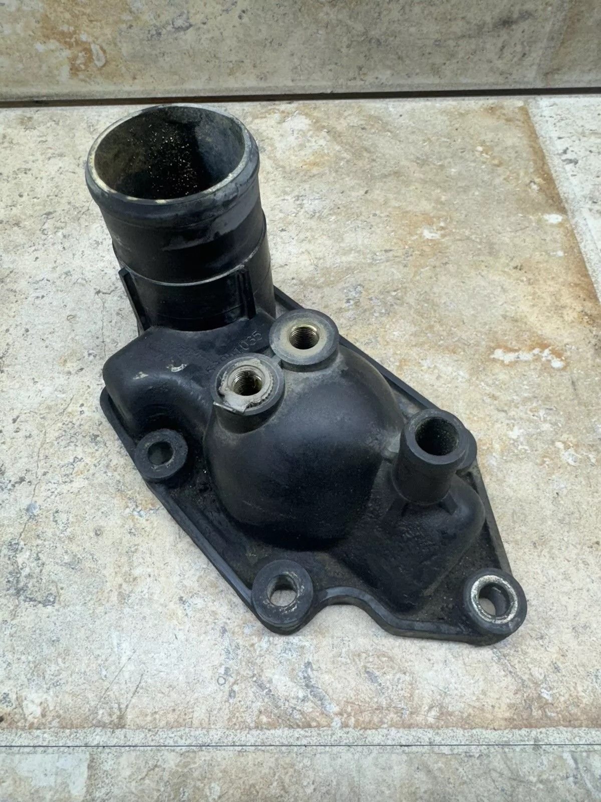

heres the plastic one

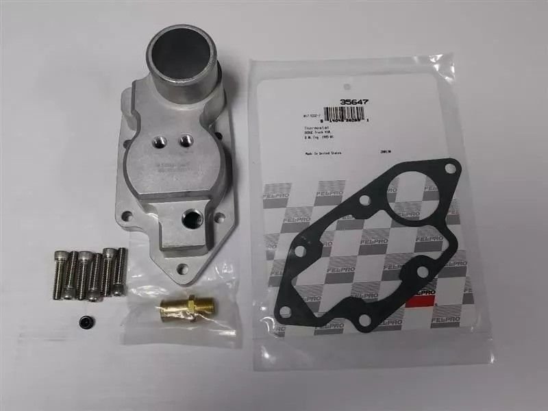

And the Billet Aluminium one
you can simply remove eth lug from teh plastic one and flatten it back out ( if yor liek me) and use it on the metal one BUT , you gotts use it on one of the bolt holes
