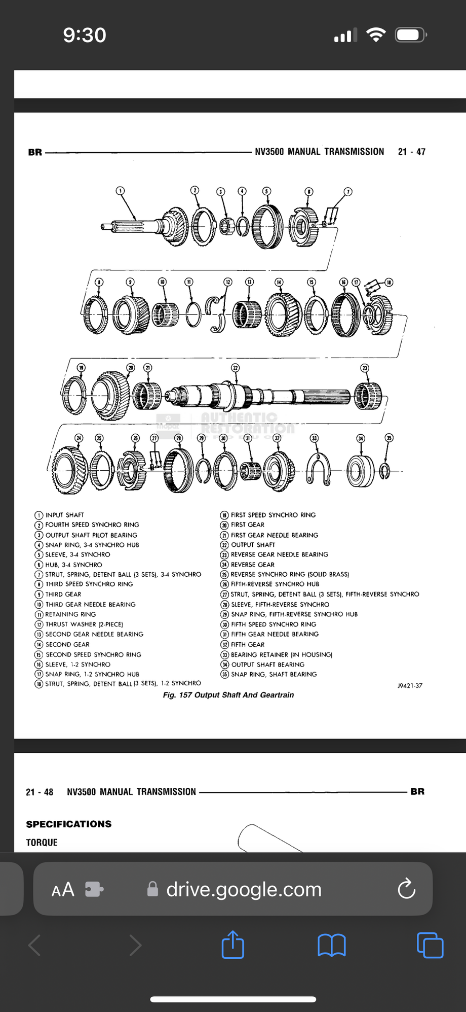

According to my research the fifth gear nut seems to be an issue on the NV4500 and not the NV3500. Here is an exploded view of the NV3500 main shaft. I don’t see anything labeled on there as it having a nut for fifth gear. I also don’t have the rattle that’s associated with that.
Upon doing more research this morning, I think I’m leaning towards the pressure plate. Reason being is I have at least 2 of the symptoms of a bad pressure plate which are over heating (accelerating speed doesn’t match engine speed/rpm when hot), and clutch release noise. Thoughts?
