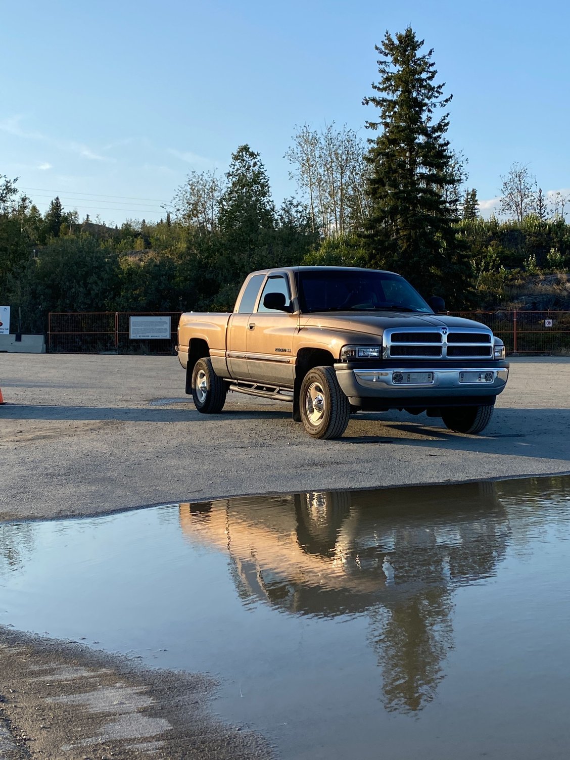

Hey all, new to the forum. I’d seen some posts regarding the rattling in the engine bay, people saying spark knock and others saying it was their tranny plate but I don’t think I have those issues. I’ll give you some background on the truck. It’s a 2000, 1500, 5.2L, 4x4, auto. It’s got a transmission that’s got all of the usual stuff that goes on them fixed and it’s got an engine out of a Durango. I put in the trans myself but the engine was done by the previous owner. Engine - unknown km. Trans - 30k km. Body and everything else - 94k km.
