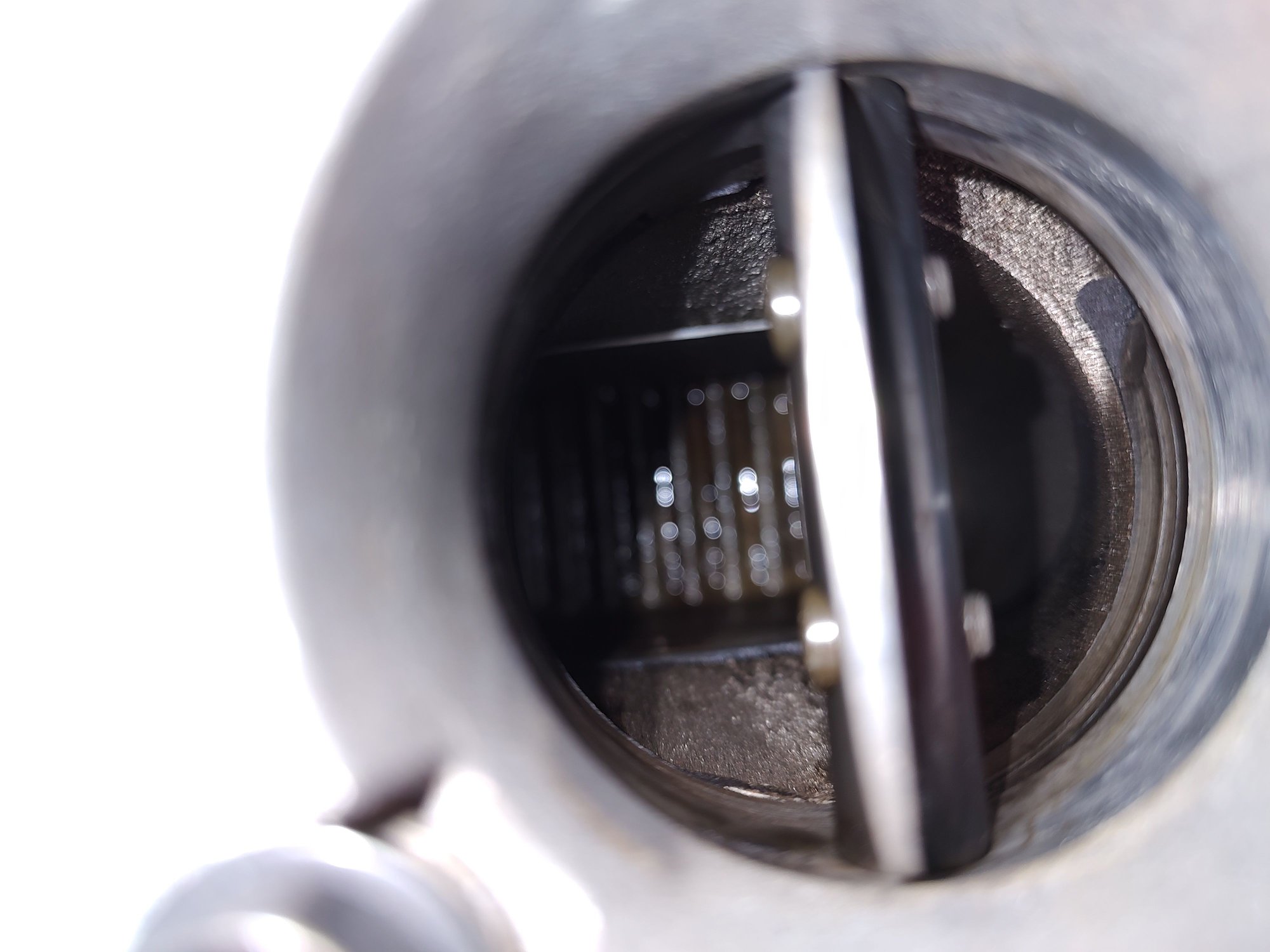

Here's what's interesting - The intake manifold was swapped for a Hughes model HUG 5409 (links below) sometime in the indefinite past. Apparently these really helped increase power, mileage (as a by-product), and even addressed the plenum plate crack issue that seems to be prevalent on these engines. I decided to take a look down below the throttle body, and low and behold the driver side opening had a little bit of oil sitting down there. My engine has always lost oil but I never knew to where... Is that a sign that my plenum gasket has failed? I'm unfamiliar with this Hughes product, but do they utilize the same stock/OEM replacement gaskets? The spark plugs also are running too hot since the air/fuel mixture appears to be running lean. More signs seem to be pointing to plenum and/or intake manifold gasket issues. Anyone else had these symptoms?

The Hughes intake manifold doesn't have a plenum plate like the factory kegger style intake. I would replace your PCV valve with a Mopar PCV valve, as it may be allowing oil to get into your intake. The aftermarket PCV valves have a different metering rate than OEM. Lastly, are you running copper style spark plugs?

If the PCV valve is bad, wouldn't all cylinders be affected? Or just #6 is getting the worst of it so far? If oil is leaking, doesn't that mean a gasket has busted from the unvented blow-by pressure? Or can the oil leak through the PCV valve? Should I look into replacing my intake manifold gaskets as well? Any suggestions as to why else I'd be running lean?

PCV stands for "Positive Crankcase Ventilation". The idea is to pull combustion gases that get past the piston rings back into the intake, to be re-burned, thus, reducing emissions. A side benefit of this is that the slight vacuum on the crankcase also helps with piston ring seal, reducing emissions even more. (and increasing engine efficiency.) For the valve, its all about flow rate... too high of a flow rate, and it sucks in oil as well. Finding some in the bottom of the intake isn't unusual.... an excessive amount though.... yeah, need to address that, and the MOPAR pcv valves are dirt cheap, even from the dealer.

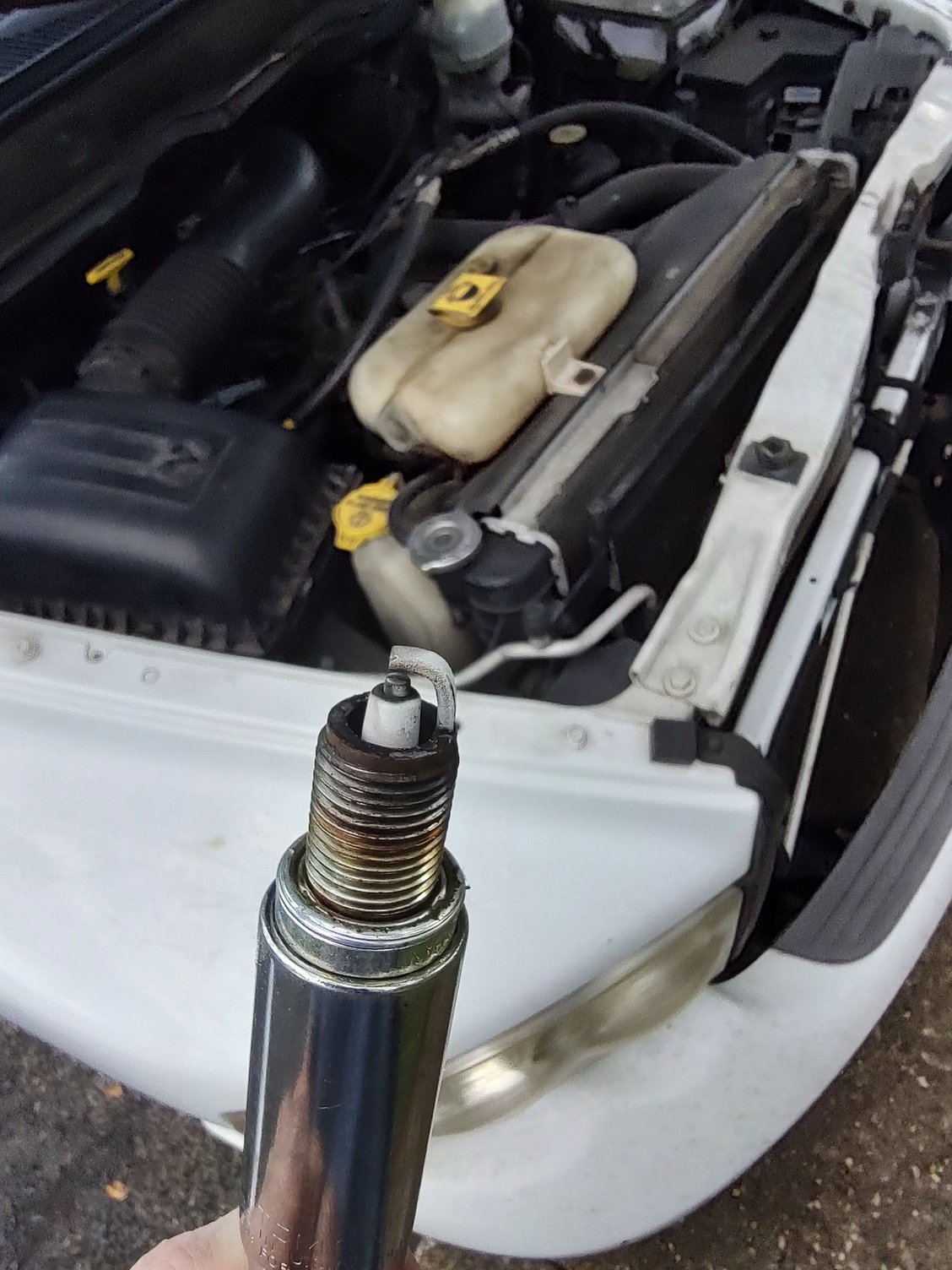

What does the number 6 plug look like? Is it fouling out??

I wouldn't say the amount of oil in there is excessive, but take a look at the picture below and weigh in on that. The Mopar PCV valve on RockAuto is like 10 bucks so I'll pick one up and replace it.

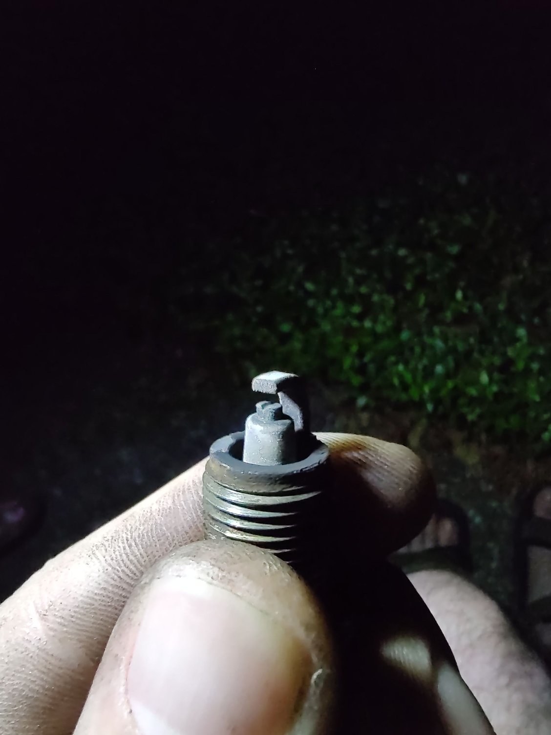

Below are also images of spark plugs #6 and #4.They were replaced back around March of '23. Copper plugs. To my untrained eye they seem to show signs of excessive heat, and my guess was that it came from the engine running lean and getting too much air since all plugs show the same wear. Is there a good way to get that little bit of oil out of the intake, or do I just let it eventually burn through the engine?
Oil in driver side intake.
Spark plug #6 - first photo
Spark plug #6 - second photo
Spark plug #4

Those do look like they were runnin' hot...... Did you fix the lean running condition?
I would be real tempted to throw some new plugs in there, and see what happens.

New plugs are also on the list... looks like OEM ran copper champions.

Copper plugs please, brand of your choice. I don't really care for Champions, but, some folks like 'em.....

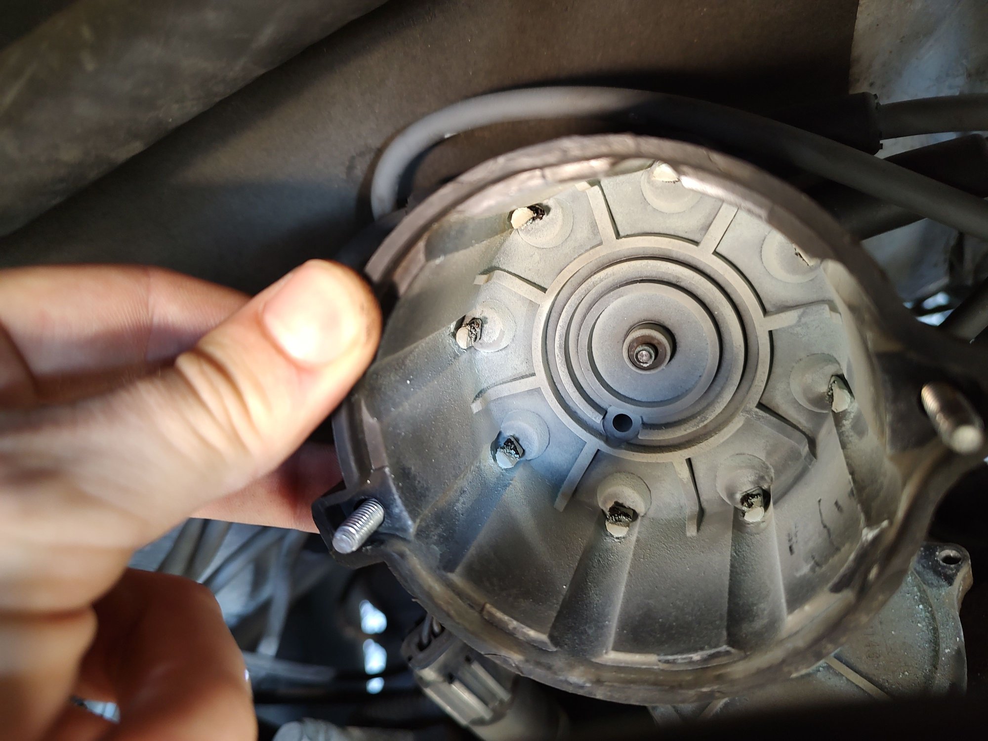

So I think I've found the culprit.... corroded distributor cap and rotor. It's got alot of that white dust buildup (aluminum oxide?). The rotor also looks worn down. Both rotor and cap look original to the truck, so I'm going to be replacing them. Any luck with aftermarket distributor caps and rotors? I feel like OEM is the way to go on this. RockAuto has rotor and cap for around $26 each, which is fine.

Looks like the spark plugs that came original to the truck are Champion RC12YC...I've been running NGK ZFR6F. The Champion have a 12 heat range while the NGK have a 6. That may explain why it's been running hot. Curious what brand you like to run in your engine HeyYou and why.
Corroded distributor cap
