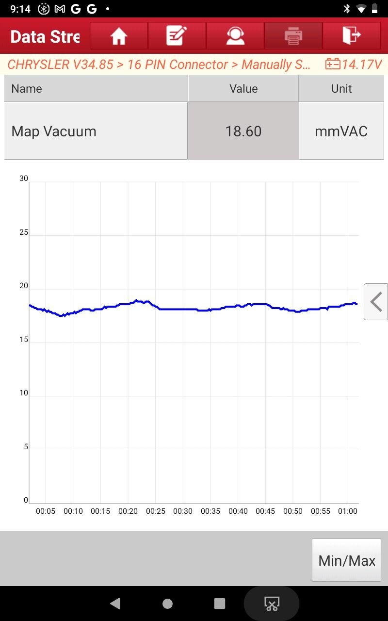

Well, she threw her normal temper tantrum this morning. Cold start, all vacuum lines blocked off at intake manifold and throttle body. I started the truck with 1/4 throttle. RPMs fell from 2000 to about 400 with the truck shaking. The truck went on to do its by now infamous "three calibration surges" and then settled out. I'm including a photo of MAP Vacuum during the surges and a photo of when it settles out. The orange lines are when vacuum was dropping and the loud hissing was coming from the IACV port.
BTW times are not accurate in the photos. From time 0 to 1:30 I was having to pump the throttle to keep the truck running. From 1:30 to 2:25 my foot was off the throttle. I then did the screen shot and somehow backed out of the diagnostic program. Once I reloaded the program, I took the second screen shot that shows steady MAP Vacuum

Think I would start with giving the throttle body a very thorough cleaning. Remove it from the engine, take all the sensors off, use some carb cleaner, and high pressure air to clean it out, making real sure the IAC well is spotless. (disconnect battery while cleaning.) Check that the little vacuum line for the map sensor is in good shape, and not clogged up.... Put it all back together, reconnect the battery, turn ignition to "on" (not start), count to 10 (don't touch anything), THEN start the engine. If everything is as it should be, the PCM should figure out idle fairly quickly.
