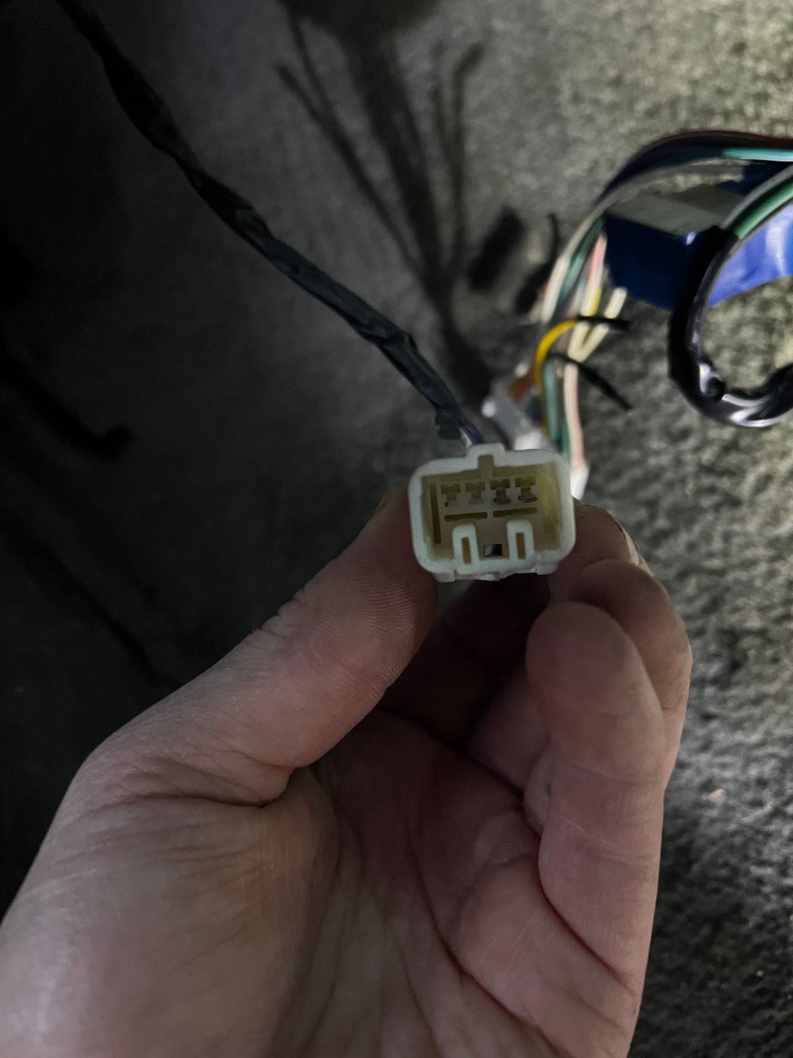

I recently took my 2001 ram 3500 dash out completely and epoxied it all together before installing a cover.
Upon reinstallation I discovered a plug under the driver side dash that doesn't seem to have a male end anywhere.
can anyone let me know what this plug is for and what it should connect to?

It may be for optional equipment that you don't have. Does everything work?

I believe the connector is for the overhead console. Do you have that option ?

I do have a handful of issues with the truck which is the 24 valve Cummins auto transmission.
the most glaring is that i am getting a boost pressure warning.
my initial thoughts was that this connector may have been a pressure sensor but i cant find any similar wires that come through the firewall.
i do have some other electrical issues, power locks don't work, and my cab light dial gives me some static through my speakers but i haven't investigated that fully yet.

That connector doesn't go to the door by any chance?
