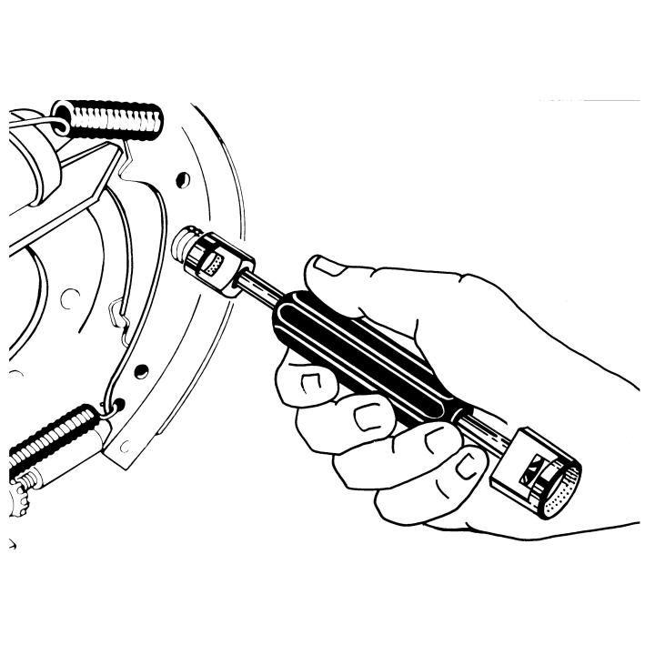

The smaller ones are easier to use. I hold the nail from the back from moving, Put on spring/retainer and then use the tool to push in the spring tension until you can turn it to lock it in place.
I found it helpful to use a clamp to hold the shoes in place.
This is also a good idea, It helps keep the shoe from moving throwing the nail out and then you have to start all over.
You can't use that on the bent nails, they essentially hook a 90 and point at the ground

From a learning perspective, do you happen to have a photo of or an explanation of the "bent nails" and are these something that you run across regularly on a rear brake job?

THANKS FOR THE PHOTO. Another way to depress the spring is with 90 degree needle nose pliers.One tip in the spring.The other tip behind the spring leg. Rotate the plyers, compress the spring. Tie wire to manipulate the nail.
