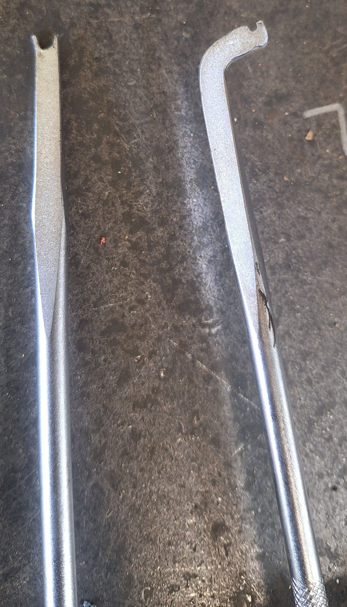

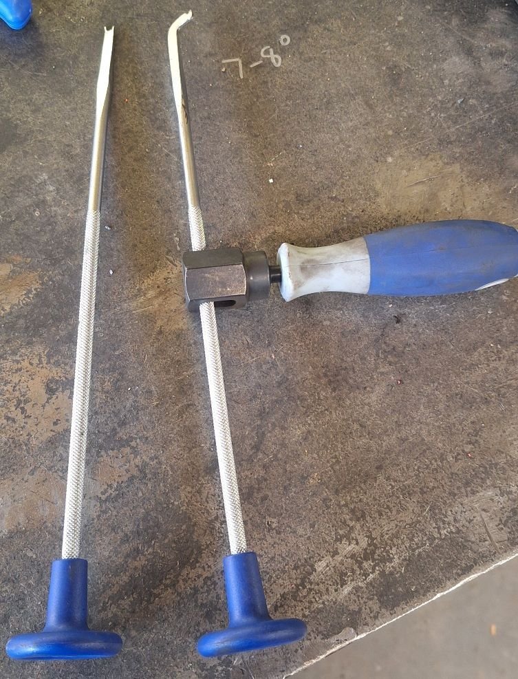

​​​I've enjoyed this PB Tools 71150 for lower return springs where there's no post off which to lever. They're only about $25 on ebay. PBT makes nice stuff but is mostly only known in AU
The forked ends may catch the wrapped spring nicely to force it toward the backing plate to hook the bent nail?  The handle can be set anywhere along the length of the shaft
The forked ends are a bit fragile and I damaged the straight one, having to re-grind it

You stick the bent tool thru the coiled spring,on to the free hooked arm and rotate the tool so that the spring is in tension?
Then bring the bent nail on?
Thank you. We had tried a bent pair of needle nose pliers to work the trick as well.
