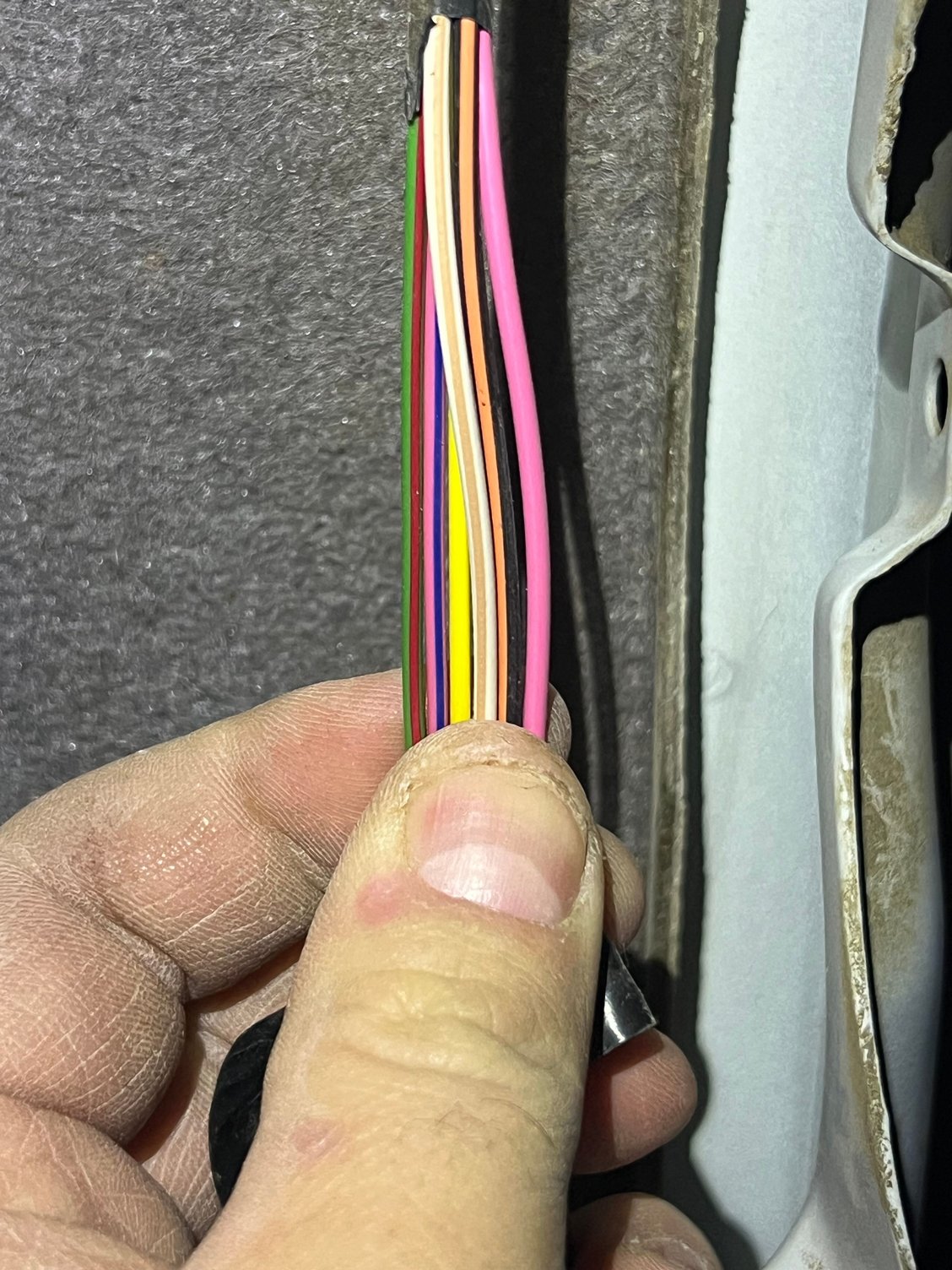

Trying to add rear speakers in my 95 1500 regular cab. No wires ran to the speaker housings in the lower cab corners. I traced the wire bundle from the drivers side under the kick panel and under the carpet and the bundle runs up the cab. I removed the tape to see what wires were hidden. These were what was covered. Are these the correct wires I splice into to add LR and RR speakers? If so which ones for each speaker?

Grab yourself a copy of the service manual for you truck from here. Wiring diagram are in section 8W.

I would expect if the wiring is ran it would already have connectors and be roughly in place where they go and not require splicing. speaker wires have no other destination then their corresponding speaker. they arent just running through the vehicle to be cut into.

On Page 677, Left Rear = - Light Blue, + Yellow. Right Rear = - Orange, + White.
https://drive.google.com/file/d/0BwD...jDdOyiYqEXeqMg
