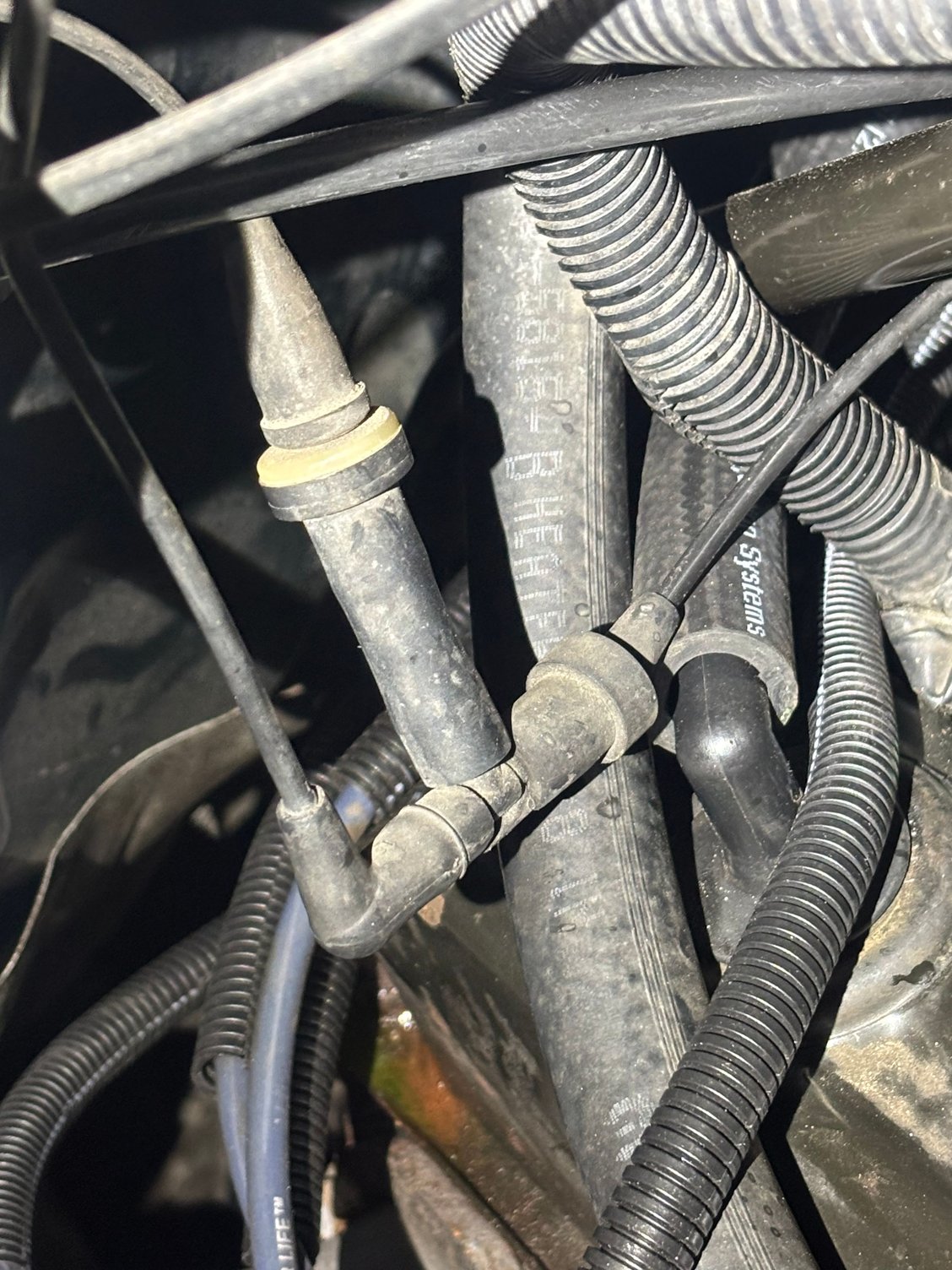

Are you referring to this little threeway thing? It doesn't look or feel bad at all.
Old Jan 30, 2025 | 10:57 PM
Posts: 87,479

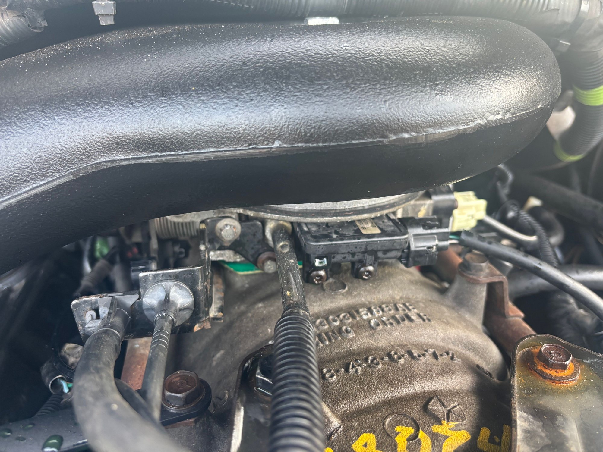

Map I think is mounted to the front of the throttle body, and the little elbow feller hides underneath it.
Old Jan 30, 2025 | 11:01 PM
Timothy Lindblom's Avatar
Timothy Lindblom
Joined: Jan 2025
Posts: 19
From: Savannah, GA
Alright I'll check that one in the morning. I should've known but there's plenty of vacuum lines and elbows on this thing

Ok, try 2...
If it was supposed to have an elbow, there was nothing on the throttle body that came with this engine and the motor that was in the truck had a different type of throttle body so I had nothing to switch over. I connected it with a piece of clear hose that is a good fit on each end. I think I'm gonna add a hose clamp to the throttle body side just in case though.
