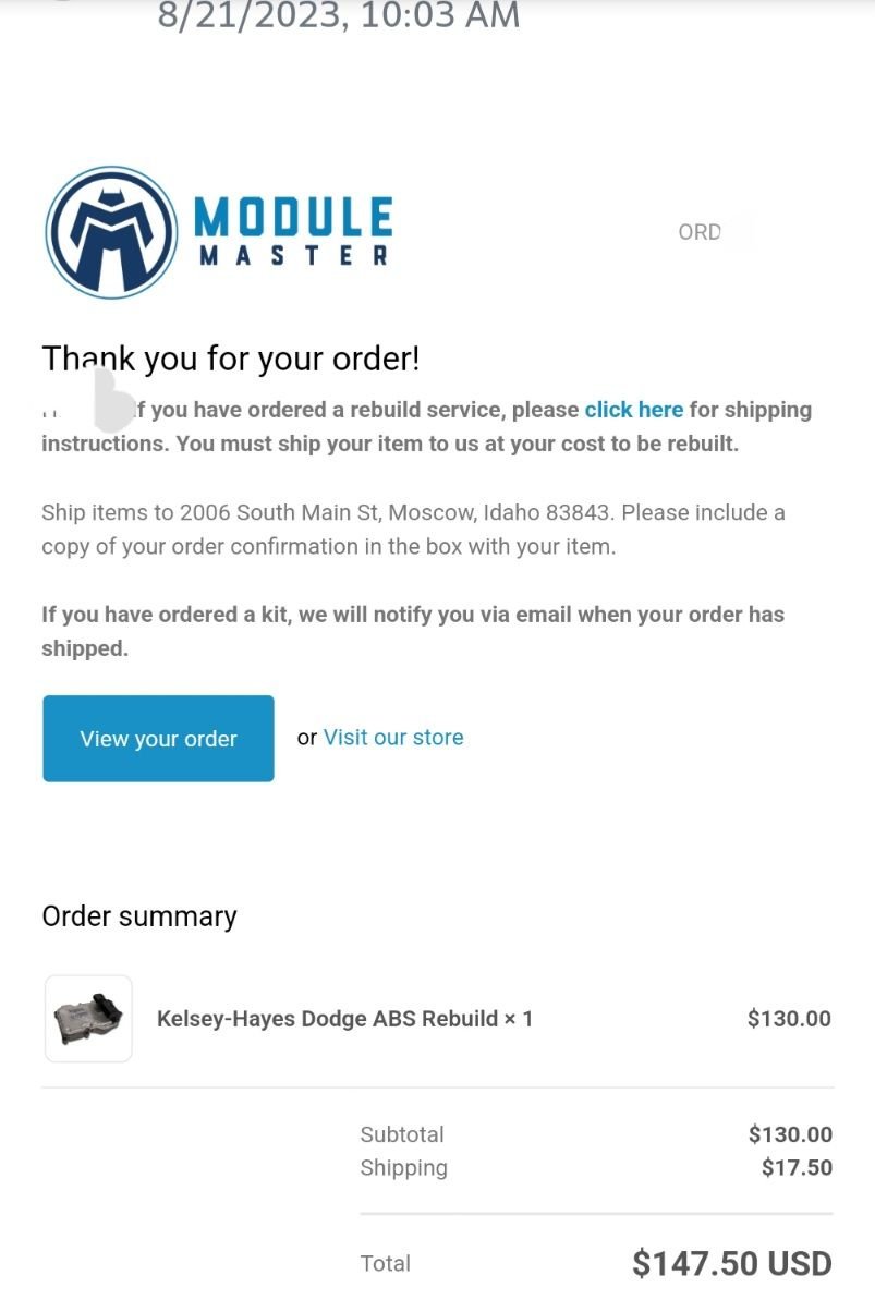

IME all these modules are toast. I service three '98s, a '99, a '00 and an '02 and they all have/had constant lights not related to WSSs
In Aug '23 I had our '02 rebuilt for ~$150:
