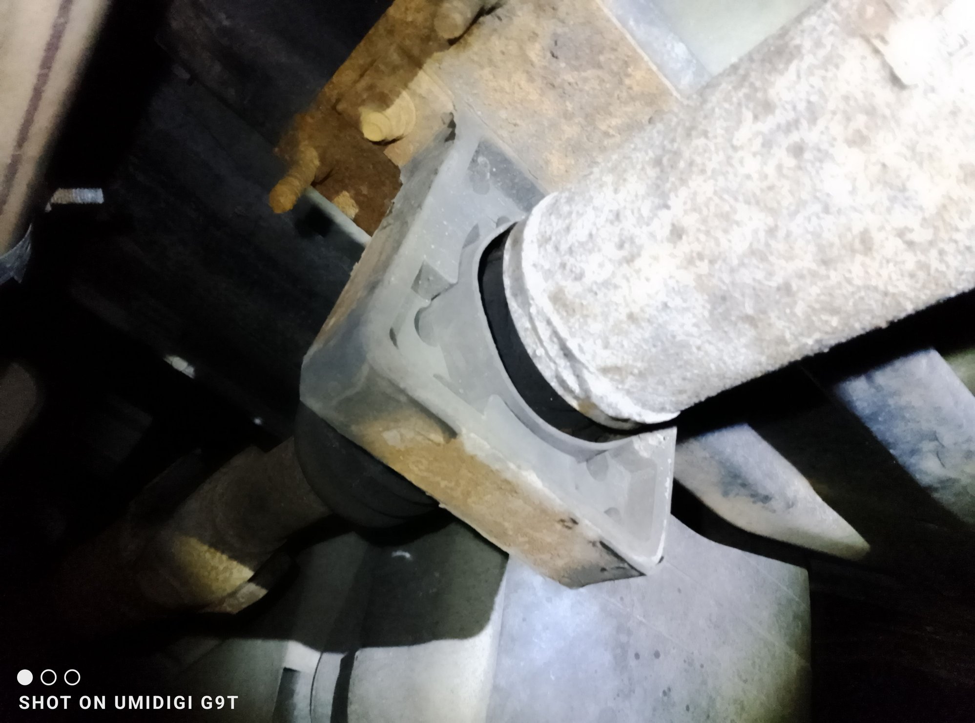

So I'm going to replace the carrier bearing on my 1997 Ram 1500 extended cab. Not only does the set up for the carrier bearing appear different. I'm having trouble finding the front shaft. When I Google it or go to an auto parts store what I find is different than what is underneath my truck. Does anyone have any idea what I've got exactly?
This is the front where it mate's with the 5 speed manual transmission. The big ring in-between the shaft and transmission appears to be like a harmonic balancer. It is loose and can cause terrible vibrations and has worn a groove in the shaft. I find nothing similar to this. Not even in my factory service manual.
Here is the carrier bearing. In all the videos and in my service manual there is a bracket between the bearing and the body. Here there is not.
But blurry but the carrier bearing with a better pick of no bracket.

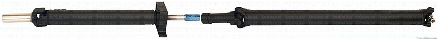

You have a two-piece driveshaft. The "front" driveshaft is for four wheel drive trucks. I think what you are really looking for is the center support bearing???

Rear driveshafts are different sizes depending on your truck configuration. long bed extended cab will have a two piece one. It sounds like are confusing the "front" driveshaft with the front section of the rear. Rockauto shows a two piece but you have to get both, No listing for separate parts. If you can't find a used one you may have to have one made or yours repaired.

You will want the square/rectangle one, from what I see in the pictures. There is a heavy duty driveshaft and a regular duty driveshaft for the trucks. Here are some part numbers (P/N) of what I would buy for a 1997. I searched for Timken and Koyo MFG and didn't find any P/N, dosen't mean there aren't. 2001 (mine) with the HD package dosen't use a driveshaft center bearing.
SKF
HB88528
National Precision Bearing
HB88530
F A G (made in USA)
CH0182
