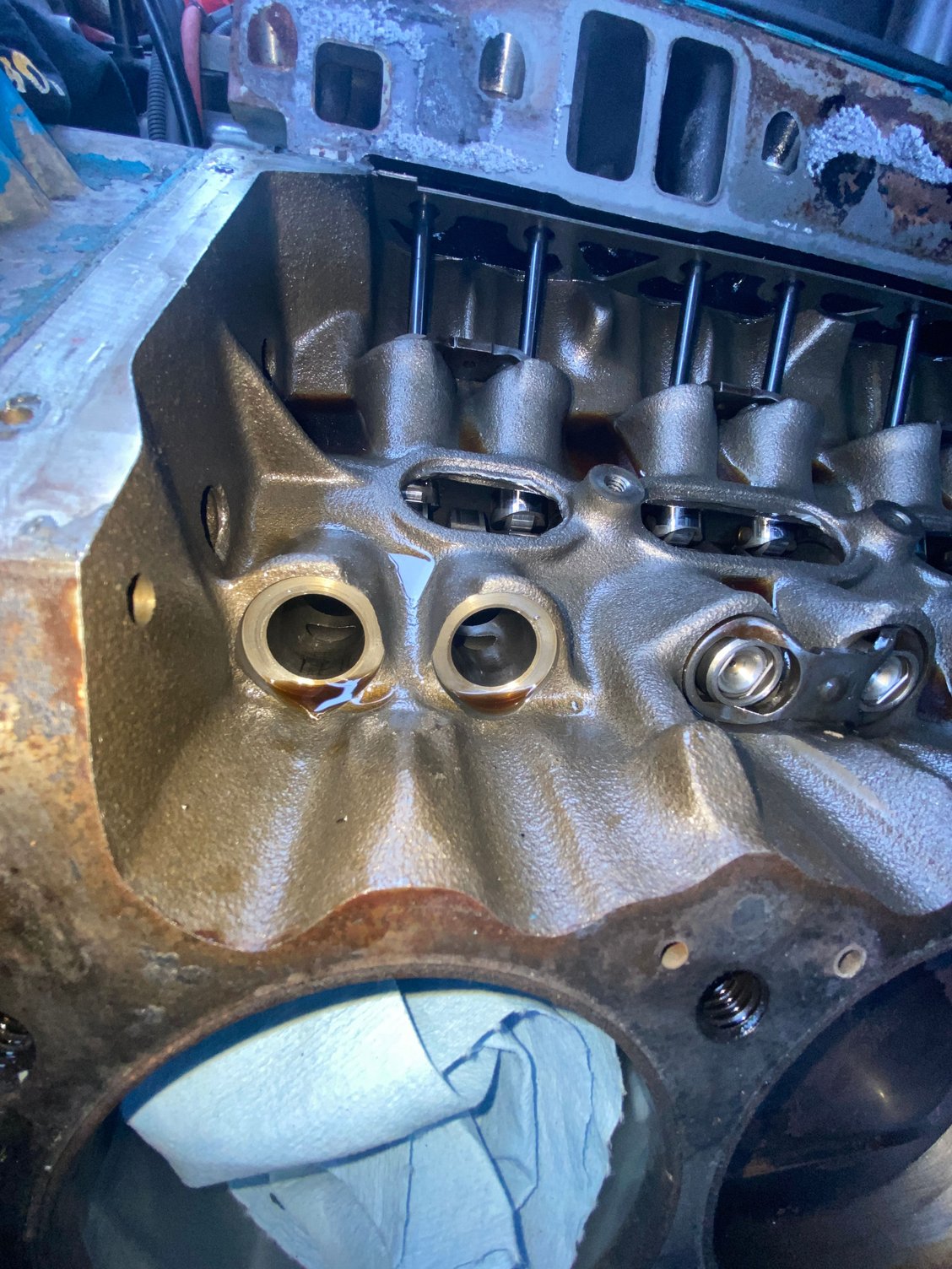

oil supply is closest to the cylinder (down) but the manual says to install the lifter with the hole up. The lifter will get oil either way. The only thing i can think of is it will bleed out any air faster with the hole up. Did you push down each lifter to see if any went down more than the others(mainly the one in question)? You may want to take that lifter apart and see what it looks like. None adjustable valve train is for the most part is fool proof, Unlike adjustable.
Yes, the lifter is recessed at the point of the inlet hole so it will indeed get oil in either orientation. If the inlet hole is facing down and at or near the valve closed position at rest, I think the lifter can drain out into the oil galley (see the hole in the bottom of the lifter bore). That being the case, it would tick on startup until pressured up. I did take the lifter apart and saw nothing obvious. I did NOT however pressure test it since the procedure was a bit involved so I just replace the lifter(s) - both on #1 cylinder. I'm beginning to think that the lifter was just not holding pressure anyway since I was hearing the tick after oil pump pressured up albeit much softer.
I'm buttoning the engine back up so I will know in a day or two the outcome - and advise.
