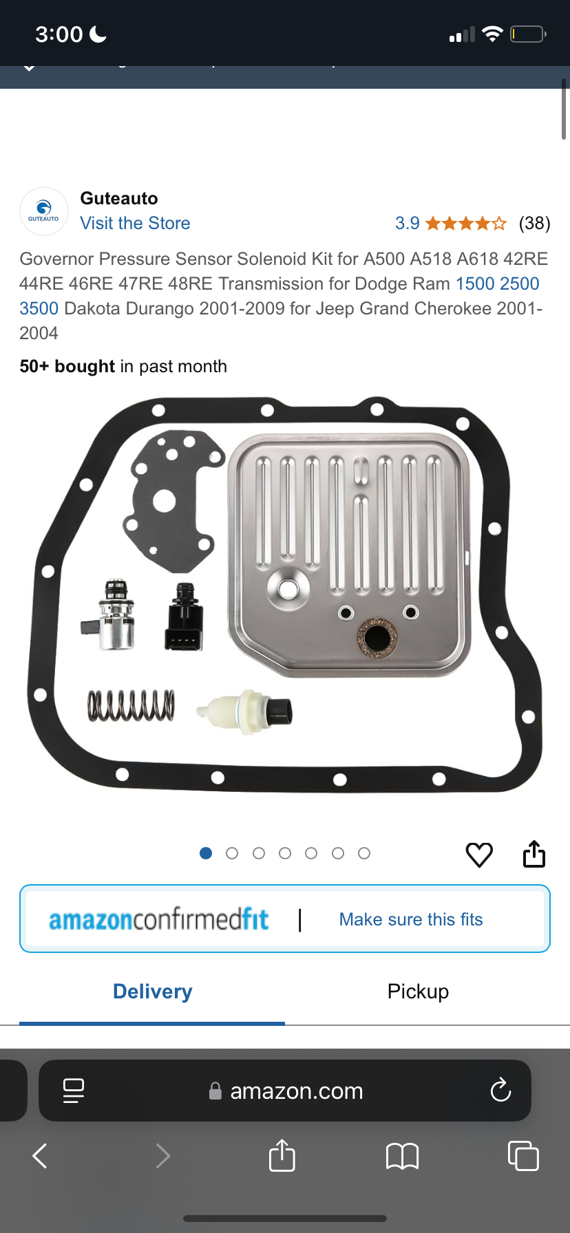

Drive chain only comes into play when you put it in 4x4. It drives the front wheels, and has nothing to do with the rears. More likely, you have a trans issue..... Think I would start by dropping the pan, changing the filter, and the governor pressure sensor, and solenoid.... See what happens.
This what I need?
This what I need?

More or less looks correct, when diagnosing a headache of a problem, amazon parts is not the first recommendation that comes to mind though.
