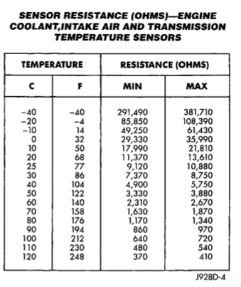

The early trucks have a quirk in that they have separate temperature sensors for the instrument panel and the PCM. If the PCM sensor is bad the PCM keeps the mixture too rich for normal operation. You can measure the resistance of the two pin temperature sensor, it should be ballpark what the table below shows.

Thank you I wasn't aware that there is a way to test it.
That is very helpful.
