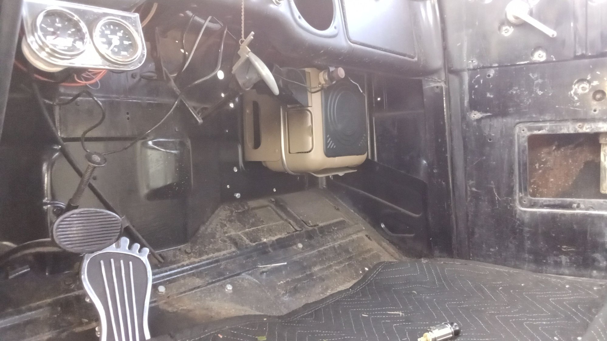

Just my opinion .... since the dawn of the automobile ... more precisely, the introduction of a heater to automobiles in the 1930's ..... there was a shut off valve to the heater.
I actually am using a modern ball valve ... not period correct but it does the job.
Thinking in more simple terms from a simpler time .... we always did this ... shut the heater off when it is not needed.
In a more simple time, all we had was a heater core and a fan to blow heat through a heater core. ... even though you do not have the fan blowing the heat out .... the heat is still there in the heater core.
This is a fancy heater that even has a defrost mode .... you just manually open/close the doors you want.
I'm just suggesting, nothing has really changed ... we have fancy ways to open/close the doors and we can adjust the temperature of the heat coming out .... the heat is still there in the heater core. The heater is on full blast without the fan blowing the heat out. .... Unless you turn the heat off going to the heater.
So what would be different with a newer trucks heater? .... as long as the heat is circulating into the heater core ... the heat is turned on.
They just eliminated the step to actually turn the heat on/off .... easier for the operator. ..... New and improved!
