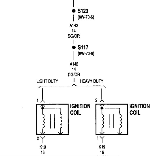

Alrightyyy so update lol no power to the connector that goes on the bottom of the ignition coil .
So I put the multimeter on it and had someone try and crank the truck and i got no voltage i did it twice and got nothing coming out of it , could that crank sensor be the issue ?
Witch coil wire are you testing? One will have power from the asd relay (if working) and the other will be a ground pulse from the pcm (if sensors are good). If there is no power from the asd relay, Coil, 02's and injectors won't have any either. So crank sensor will make no difference.

I was testing the one that clips on to the bottom of the ignition coil it has 2 wires on it

Witch one? I looked it up in the service manual and the one you should be checking is DG/OR dark green with an orange tracer.

I apologize i never got the notification you sent something and ill have to get you a picture i dont quite know how to describe it , we might be talking about the same one , ima visual type of person lol
