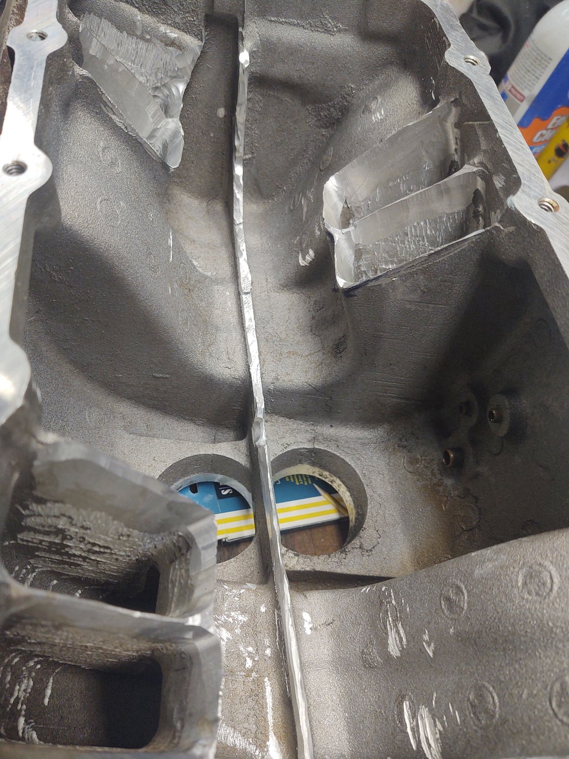

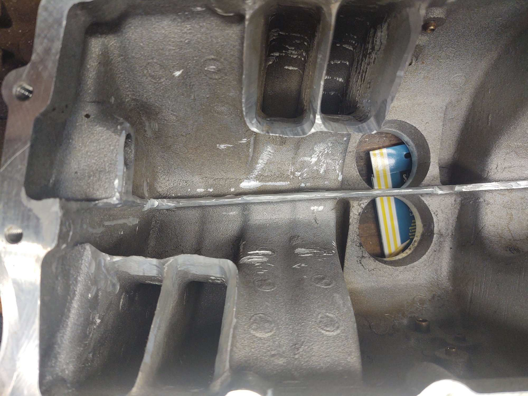

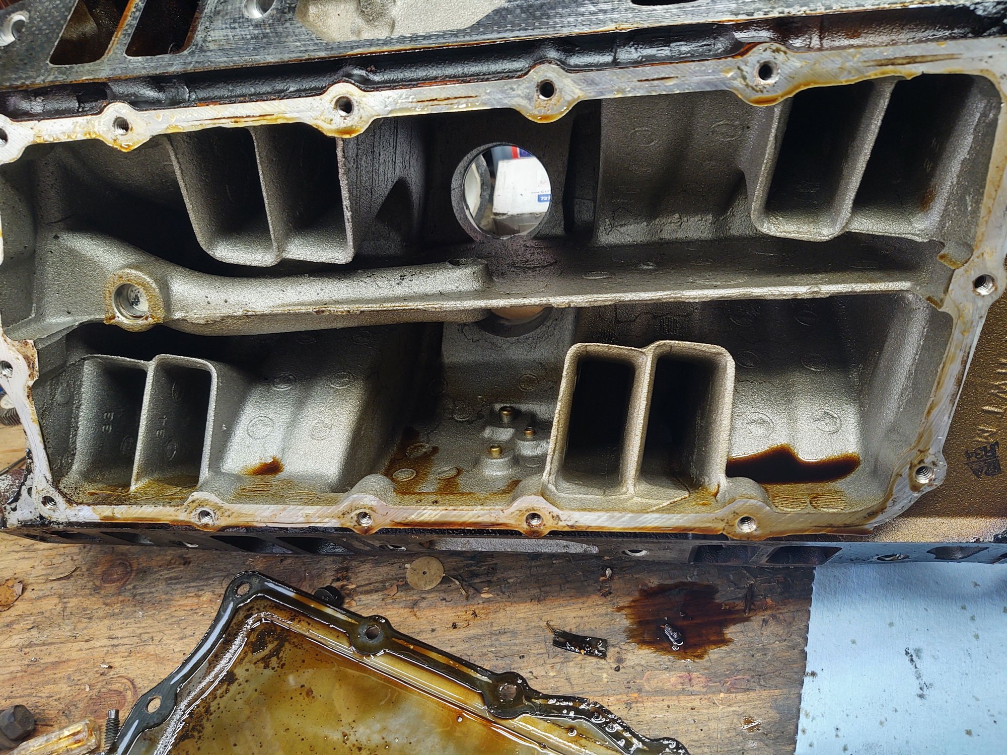

Some updated pictures. I just realized I did not get any finished pics, but this will give you an idea what I did to the Kegger.
Before any cutting
Before any cutting
amount I cut off 3/4
amount I cut off 3/4"

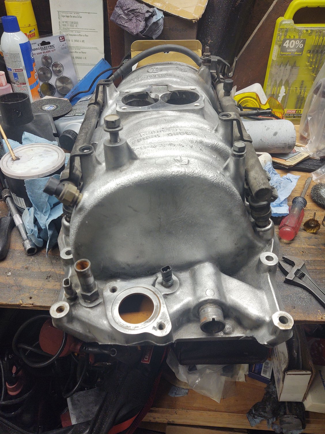

Almost back together. Its been a journey
Missing the throttle body

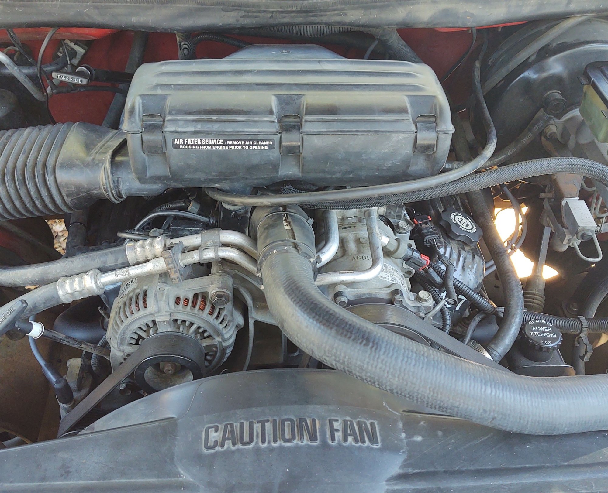

I got it back together and it runs. I have not taken it out to romp on it, but i drove it around the block to get it warmed up and topped off the fluids.
Recap:
1. Replaced plenum plate with Hughes plenum fix
2. I cut out the plenum divider.
3. shortened the runners about 3/4"
4. ported both runner inlet and exit. gasket matched the (exit) intake on the cylinder side.
5. gasket matched/ported intake on the cylinder head
6. Mildly ported the throttle body.
7. Replace, rotor, spark plugs and wires.
8. oil change
9. replaced old vacuum caps on kegger
completly put back together.
