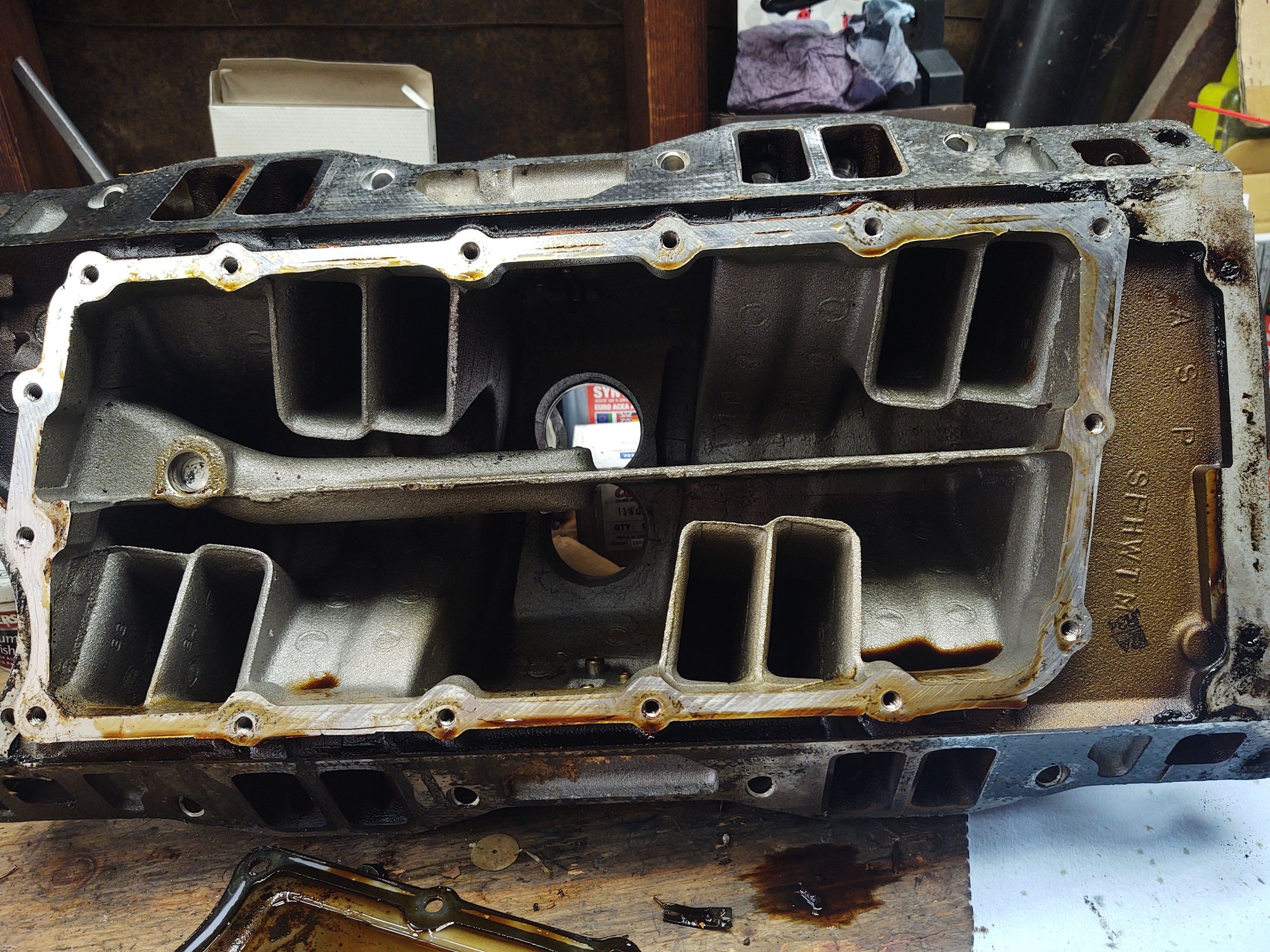

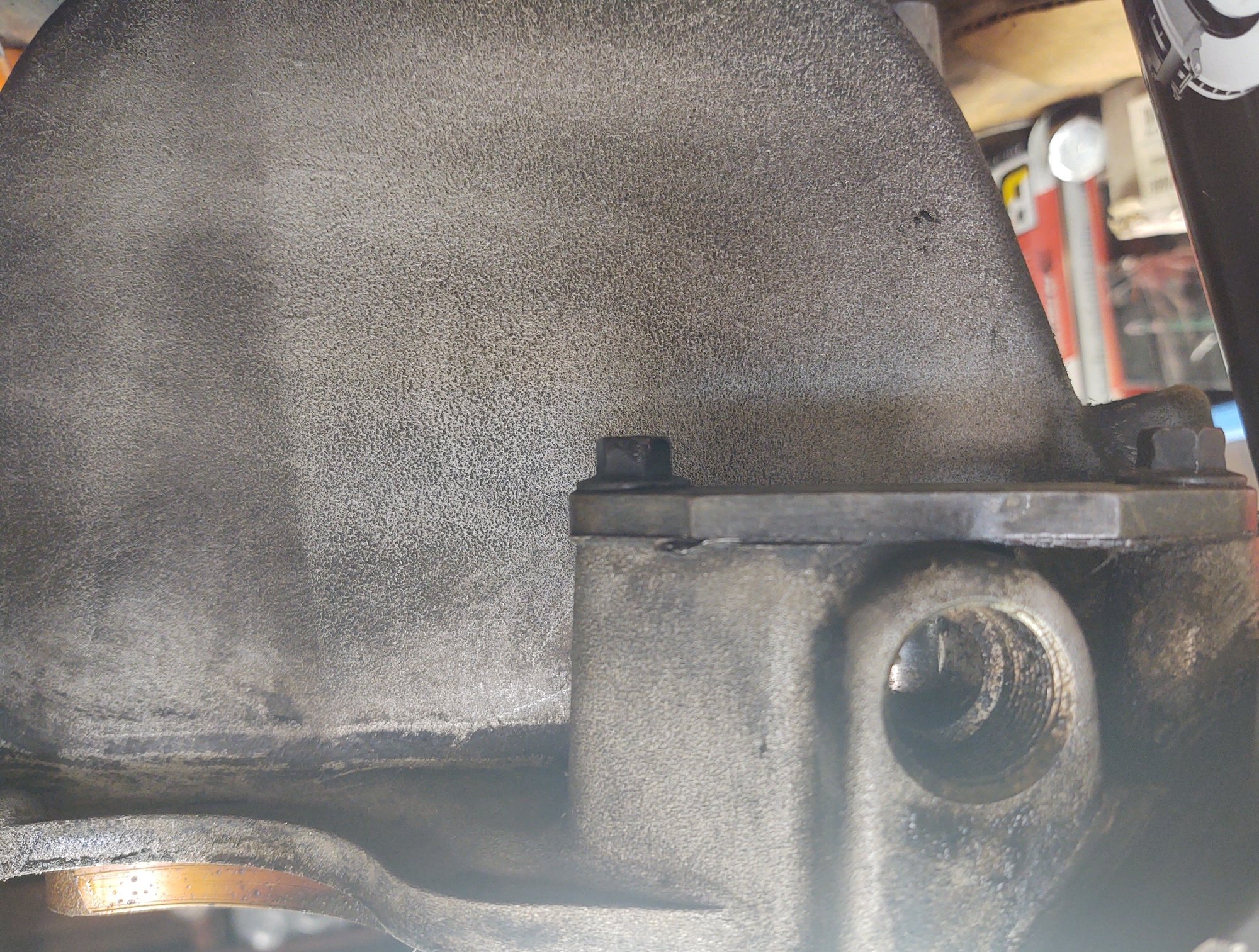

I plan on porting my kegger while I have it out. I purchased the Hughes plenum repair kit. My center divider has a large bulge on side of it. Is it for EGR? my truck is a 96 5.9L with no EGR. I purchased the truck a little over 2 years. If it for EGR, I am thinking it was replaced before. Not sure, but my main question is, Can I cut out the center divider and plug the threaded hole without ruining the intake manifold? Thanks for the help.
This is the bulge I am referring to.
open hole. its threaded. maybe put a npt plug.

My 96 had the same thing, and yes, it is indeed for EGR, which you don't have. My guess is, they had manifolds left over from the 95 model year trucks, which DID have EGR, and just used them up. You can remove the whole center divider without trouble. I bought a slightly newer manifold, which didn't have it. Just make sure that you don't leave a hole in the manifold to outside air.

Check out the VRP plates, my give you more benefit, I would guess the divider would have some affect on air flow turbulence, in a good or bad way i could not say. I'm not a science expert on it
Are you stating non egr in takes don't have that divider? because I though they all had the divider
Old Jul 4, 2025 | 08:48 PM
Posts: 87,550
Likes: 4,230
It went in stages, 95 had the divider with EGR, 96 and up (except some of the earlier ones) had the divider, but, no EGR, later years didn't have the divider at all. I removed it from the manifold I put on my 96, and shortened the runners up a bit. Peak torque was a bit higher, but, so was peak power..... and there was more of it, along with better throttle response. Some of that may have simply been a product of not having that massive vacuum leak any more though.

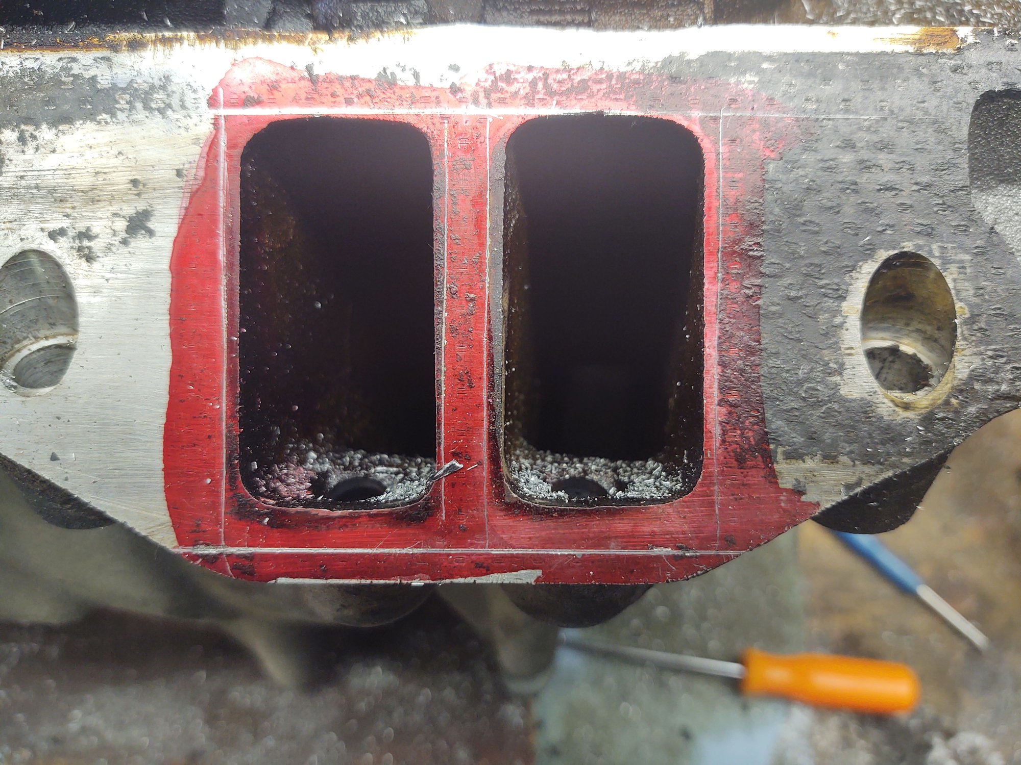

My scribe marks. I used the markings from the previous intake gasket (new gasket matches) to create my scribe pattern.
