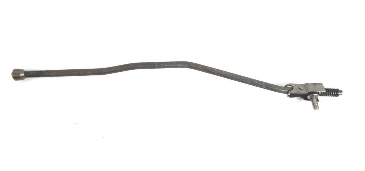

If you can move it into park by hand i think there is something wrong with your park rod/spring. Try putting it in first then lock the linkage, See if that makes any difference.

It's something you never touch unless the transmission is apart. But if it is indeed in park and it still rolls somethings going on with it or the lever that applies the brake. If you drop the valve body remove it from the rooster comb, Do not pull it out. Not easy to get back in. If you position the lever on the trans to "1" first", Do the same with the same with gearshift then "tighten the linkage adjusting bolt" (lock) the linkage.
