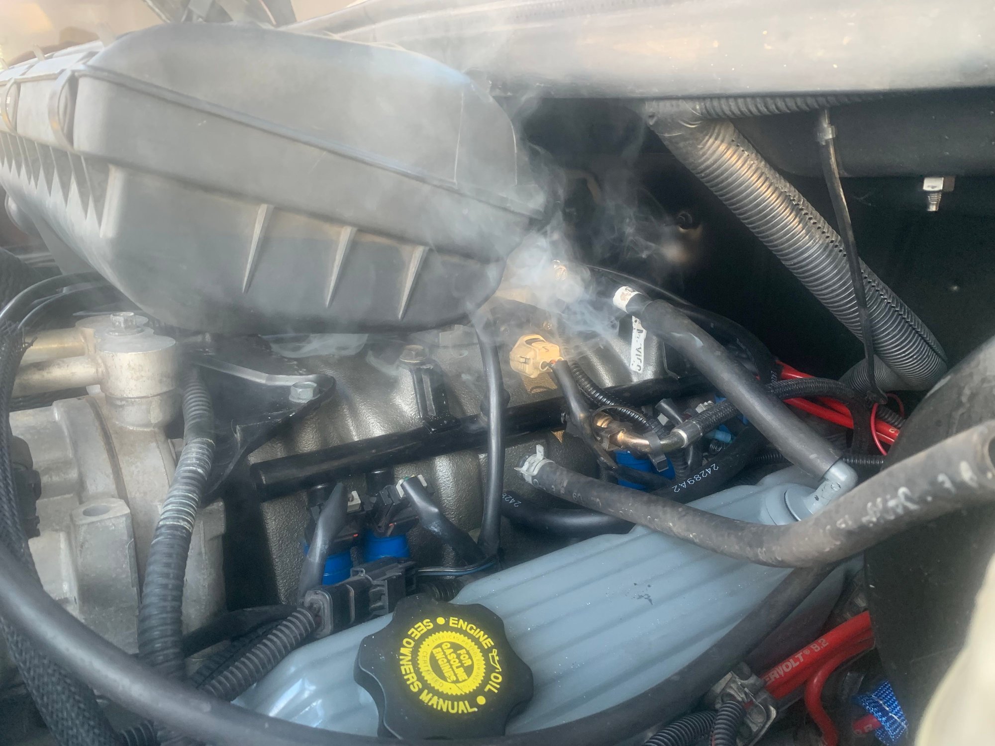

Just rebuilt a new 360 for my 98, but having high/ fluctuating idle issues. I replaced the IAC with new oem mopar and the TPS with new Delphi. Added a 53mm throttle body and headers, otherwise all stock. What else can I look for? Mainly seems to do it on the way home from work when it’s hotter outside. Come to red light and rpm’s stay up, but will eventually settle down to 650 after a while, but then sometimes goes back up. Not sure about a possible vacuum leak causing this. I would think it would never idle correct if i had a vacuum leak somewhere. I did look at vacuum hoses, but all seem good

Throttle body was CNC’d to 53mm so it was cleaned. No codes. After reading my own post a few minutes after I typed it out, I decided to throw the smoke machine on it. TB has a new gasket, so not sure why the huge leak there. Guess I will pull it off tomorrow and see

Fun fact: if you install the throttle body gasket backwards, it will cause a vacuum leak. Luckily, had an extra gasket and installed it correctly this time. Lesson learned.
