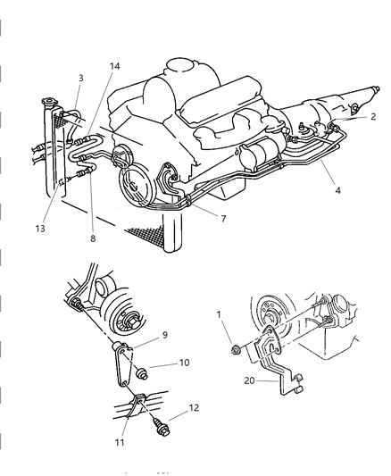

You posted in the truck section, This is what the lines look like on a truck.
Attached Thumbnails Transmission cooler-b678278e4ebd939f122d3f9b31f17d31.png
