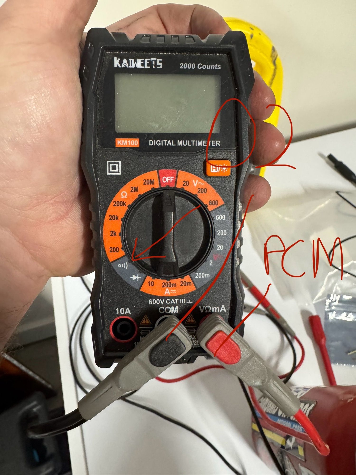

I have a multimeter set to continuity, one end of a probe inserted into the PCM connector on the harness while it’s unplugged, and the other used to probe the metal connections on the inside of the plastic O2 sensor harness.

I was testing with my multimeter per the attached photo, with both the PCM cables (C1, C2, C2) and the four sensors unplugged.

That's correct. Though, I would rather see resistance on some of them..... (the signal return wire, for instance.... as that value is IMPORTANT there.....)
And just for clarity: The PCM side is plugged into the wiring harness side of the connector, right?
If you have wires that do NOT have continuity between the connectors, then you have a problem in the wiring.... If you have multiple wires that don't have continuity, you should be getting a HOST of codes for that, not just one.......
