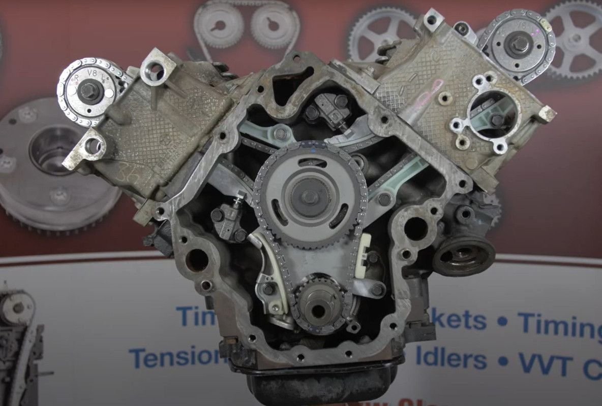

If you can see the timing cover leaking (easiest from underneath looking up) ABSOLUTELY replace the gasket. It's only a half dozen additional fasteners that are easily accessible. And yeah, once you're there the timing set is one bolt (literally, I think?)
Wow, in that case, I retract my earlier comment regarding all the extra work. I wish my 4.7 had been that easy. With 3 chains involved, it was no joke... https://dodgeforum.com/forum/2nd-gen...ay-oh-boy.html
Originally Posted by Keith_L
FWIW I have proven on this forum with pics you can remove the timing cover with the water pump attached.
I think most of the Chrysler engines are this way. This is the 4.7 timing cover with water pump still attached. It only had 10K on it, so I left it on when I removed the cover.
And now you understand the concept of OHC.
On a pushrod motor the cam lives in the block just above the crank. Pushrods are driven by the cam to activate rockers in your heads. There's just one, short chain from crank to cam.
There's a single bolt on the cam sprocket, then both sprockets and chain slide off together. This happens to be a double roller aftermarket, the chain need not be "double" width like this:
Oh, yeah. That is much simpler than this.....
Yeah, a lot harder when you have to remove valve covers and keep three chains in line without jumping any teeth. The tendency of the cams to roll into an incorrect position due to spring tension had me puckered up good.
The original chains were all inverted tooth and they were in great condition, given the miles. As I said in my thread, if I could have slipped in the guides without removing the chains, I would have kept the old chains.... LOL. I ended up with an incorrect timing set for a later version of the 4.7, which updated the two cam chains to roller type. Instead of sending it back, I made it work.
Anyway, I can see now why you guys would go ahead and replace the chain and timing cover gasket on the 5.2...it's a walk in the park. On a 4.7, you don't develop such thoughts while changing the water pump. LOL
