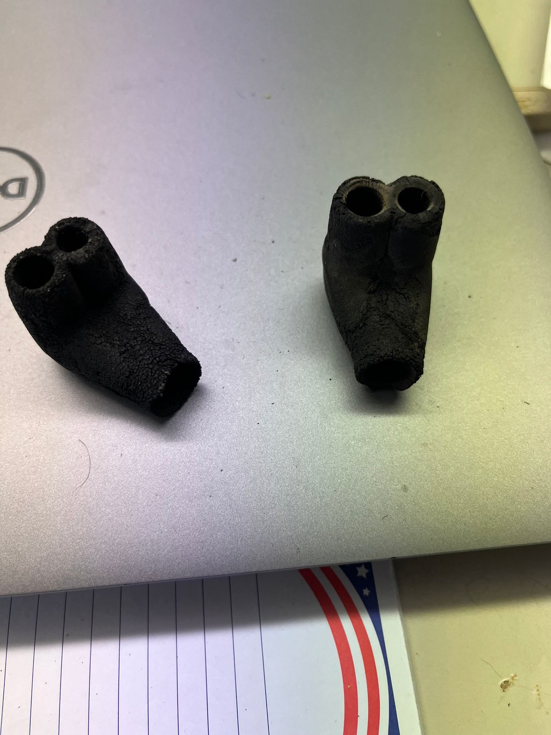

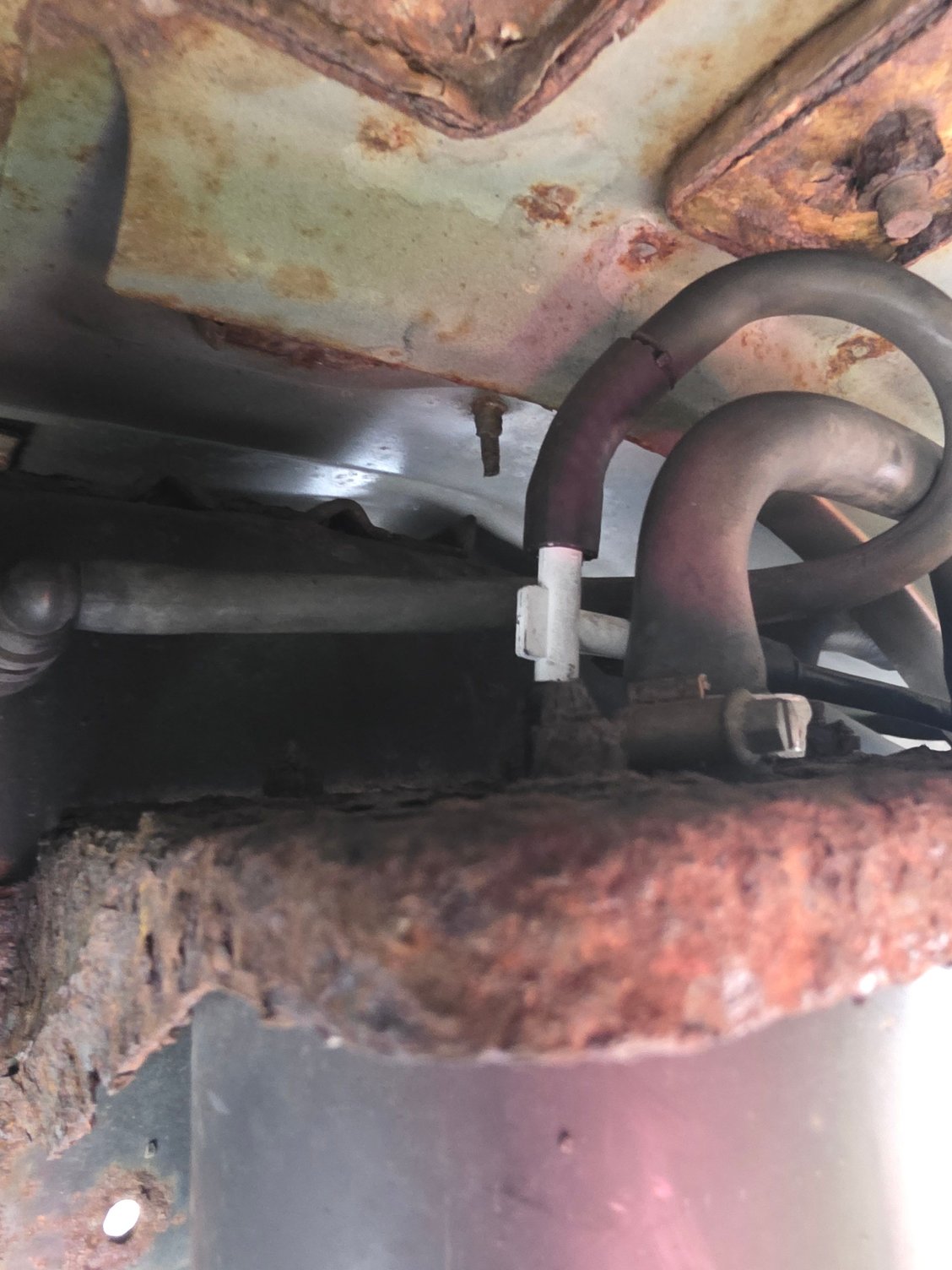

So I got back to fixing the 01 ORE Ram I bought (same one I posted about running rich). Fixed the brake line and got front brakes again. Took it for a drive and noticed P0455 came up and P1899. 1899 I have no issues so that will wait. I remembered from last Summer that the rubber 2 to 1 connector for the EVAP canister was bad. I rigged up a temporary solution using 1 5/16 hose barb and some 5/16 fuel hose. While I designed a replacement to 3d print. Once I figure out the 3d print if anyone needs one, let me know! The port that goes into the canister will use an Oring to get a complete seal.

I might be able to use one. Whenever I go to the Pick-A-Part and find a Gen 2, reach under the passenger side frame and check for one. Yours is a bit different than mine, if it works, it ain’t crazy.

Mine is the same, just the 3d part well be different. I need to find time to get measurements with calipers before I print the final version.
