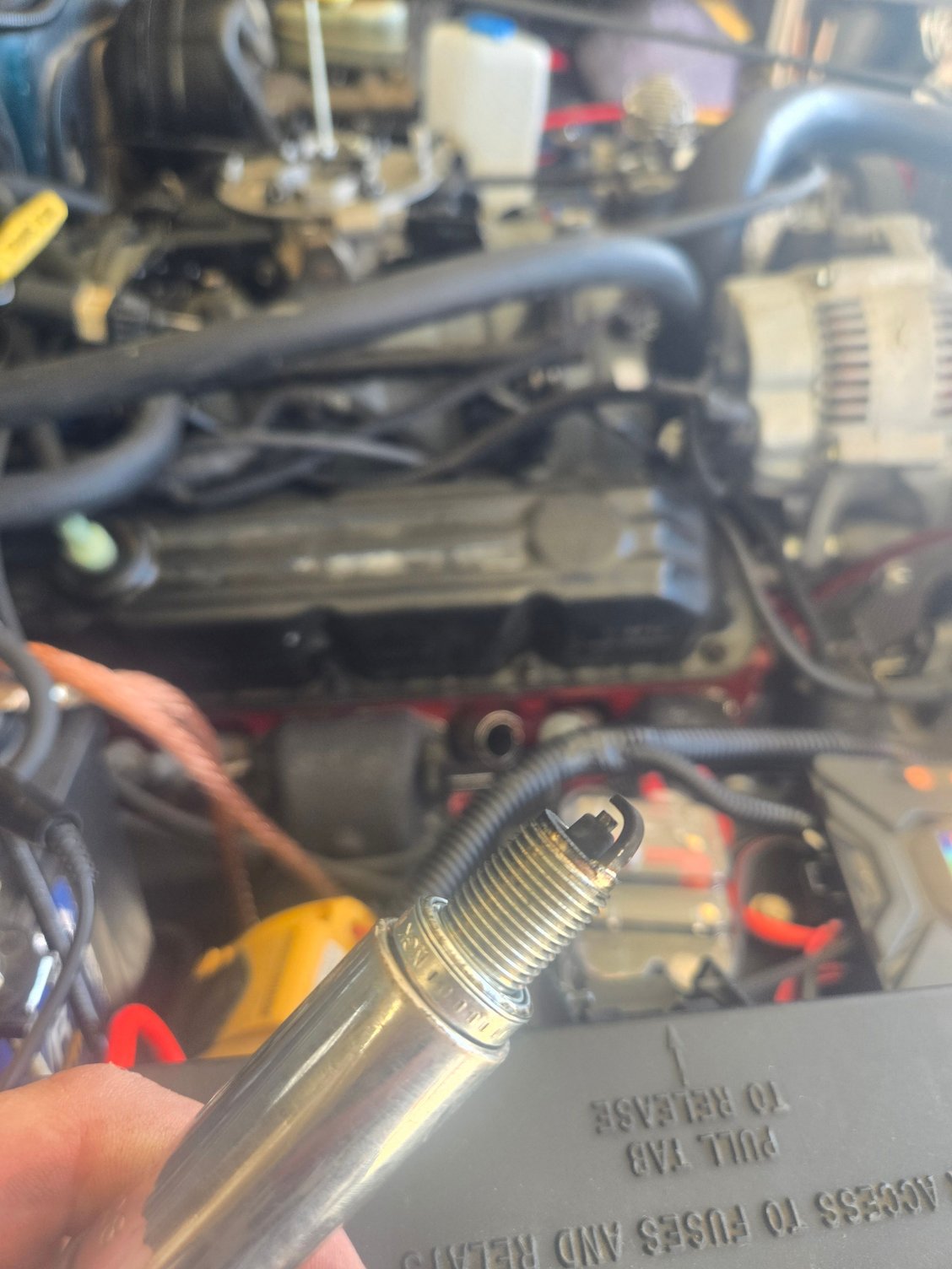

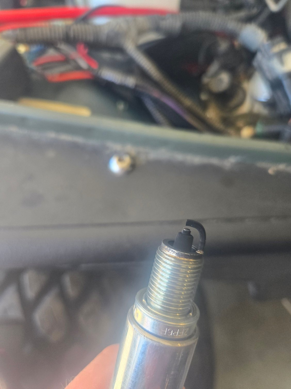

Just pulled the plugs and they are definitely sooty like its running rich. These have approximately half an hour run time tops. Thats kinda making me think vacuum leak and its overcompensating for it by adding fuel? If it had a vacuum leak from the crankcase between the intake manifold and head then it wouldn't show up on a smoke test and wouldn't show up when I tried propane anns starting fluid. I'm not getting a vacuum on the crankcase when I run it with the pcv pinched off and a gauge on the breather, but its not really building pressure either. I'm kinda thinking I need to pull the intake. I had it off a week ago to reseal the plenum hoping that was the problem. I put it back with new fel-pro gaskets and bolts. Do you guys ever use a sealant with those intake gaskets? Is that something I should have done?

That's running pig rich. Are those standard copper plugs?

That ZFR6F comes up nickle alloy
