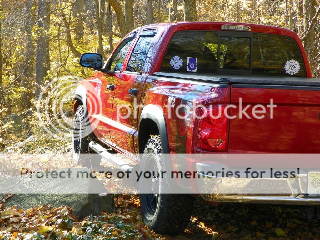

Rim size (diameter/width/offset): 17" x 8" x 20mm
Rim manufacturer: Ultra Motorsports
Tire size: 265/70/17
Tire manufacturer: Goodyear Duratrac
Lifted (specs): TM 1.5 leveling kit
Lowered (specs): No
Rubbing (yes/no/trim): Yes, at full turn. Fixed with minor trimming of splash guard and wheel well liner.

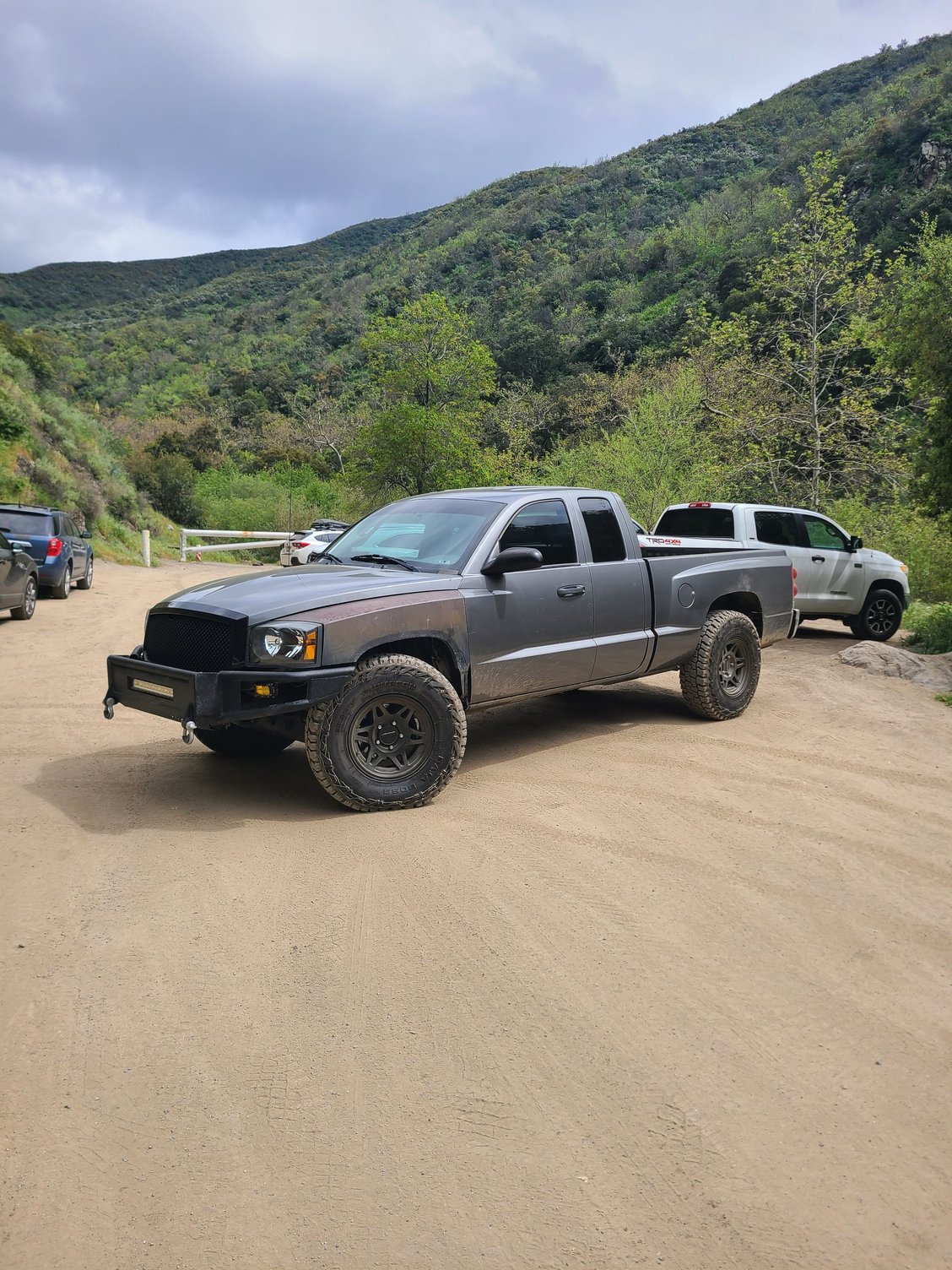

Default No lift with 35s
Rim size (diameter/width/offset): 17x8.5 0mm offset.
Rim manufacturer: Method 706s bead grips
Tire size: 255/85r17...35's
Tire manufacturer: Mickey ThompsonLifted
(specs): 1-inch spacer lift front.
Lowered (specs): No
Rubbing (yes/no): No frame rub...But rubs the outer firewall and rear arches...
I had to cut out some of the firewalls and make "new" arches on my rear bedsides to make the 35s fit with basically no lift. I didn't want to limit travel with the crappy lift spacers so I did this instead... Let me know any questions...if people even come on this forum anymore.
